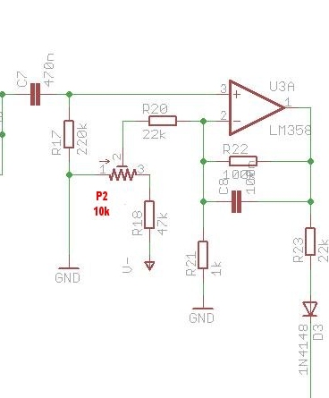

          Have you got all the timing correct, and the DC offset, You could have a number of issues, but check the values of the resistors as shown here, in the early days there was a mix up with two resistors that gave a lower sensitivity, there is a thread on it somewhere, once they were swapped the sensitivity increased.
          What battery's are you using, you should be using 12volts with alkaline or nicads or nimh at least.
          • Paku found it for you, check R18 and R22
            • Hi, 6666.
              I have the same problem as the Paku (detects only 2cm), already checked the resistors (R18 and R22) and are OK.
              What could be the problem now?
                ok i will check it

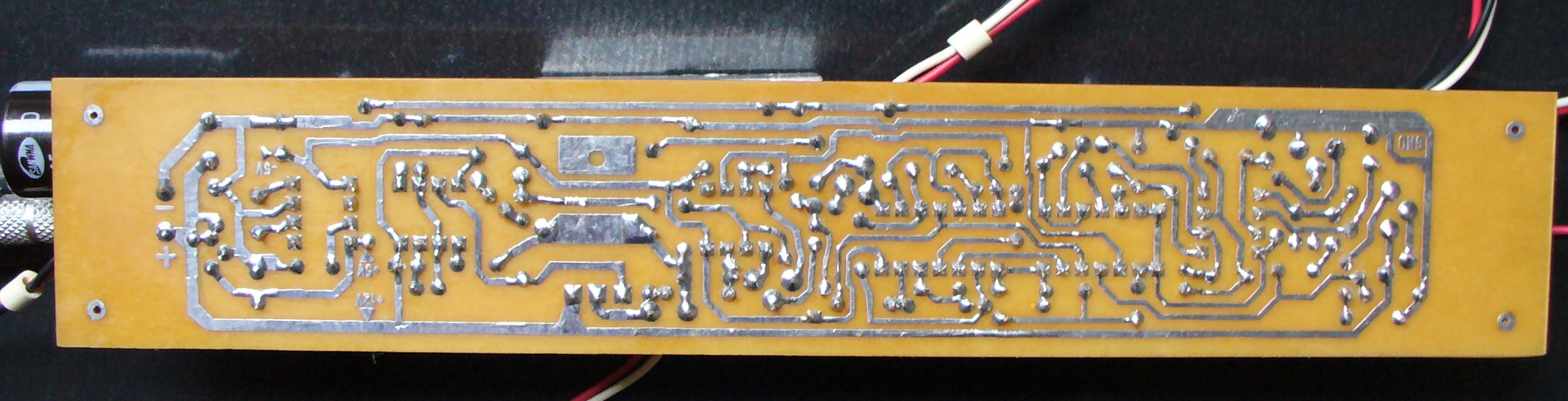

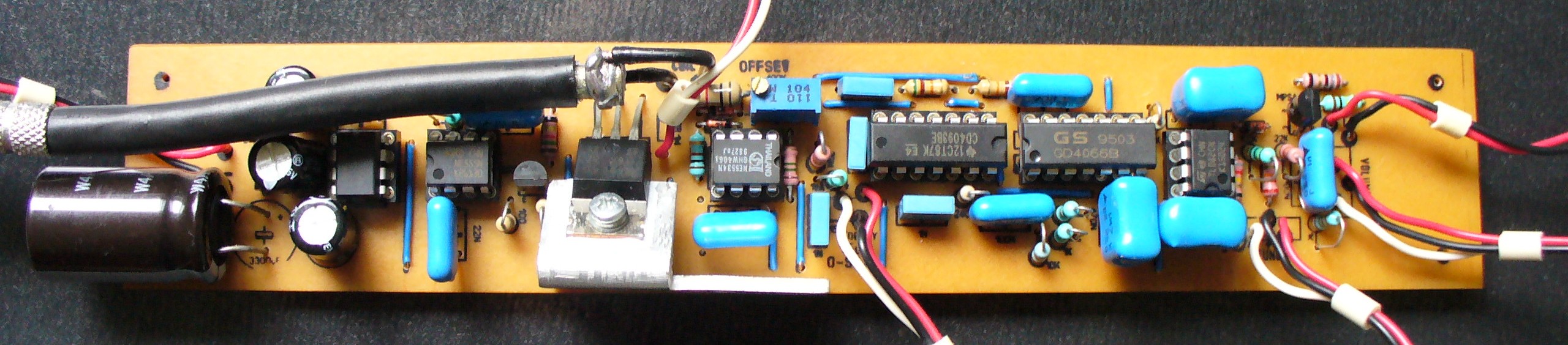

                        • Sorry for the delay
                          My motorcycle battery is 12V - 5 amp
                          My 20cm coil, 18 turns, 0.5 mm wire (24AWG) or 20cm, 18voltas wire 0.6 (23AWG) or 23.5 cm, 24 turns, 0.5 wire (24AWG). all with the same results.
                          5 ICL7660 pin voltage is equal to - 4.75V, and pin 8 is 5.1v +.
                          In NE555 pin 3 of the voltage is 11V (+ or -).
                          In 2N3906 between the collector and GND is "4.4V".
                          Adjusted the offset -> 0V on pin 6 of the NE5534 (as described in the forum) and remains so.
                          The tension in my coil is 0.56 V.
                          Do not know if it needs some more adjustment / setting / trick / secret, or some substitution of values​​, so I am sending a picture of how this my Surf Master at this time (with the updated values​​).Click image for larger version
Name:	Surf PI Circuito.jpg
ID:	337629Click image for larger version
Name:	Surf PI Componentes.jpg
                          • What transistor have you got for Q6 ?

                              What are the red and white wires beside the IRF9640????
                              Check the dumper resistor. If it is a big one then the detecting distance is only 2 cm.
