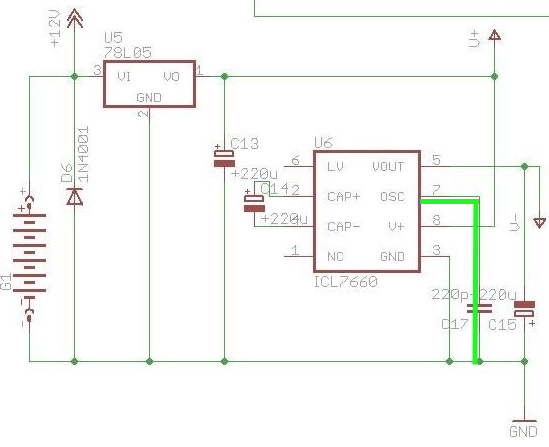

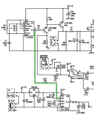

Whites Surf PI schematic
  • Originally posted by andrewl View Post
    Why does the oscillator input of the 7660 need to be driven by the 555? Why isn't the internal 10khz oscillator described in the data sheet (Intersil) enough?
    The oscillators also seem to have different roles. Isn't the 555's 615hz to drive the logic and coil block while 10khz is to trigger 7660's pump and transfer cycles?
    In the White's Surf-PI the 7660 is not synchronized to the TX oscillator. However, if you look at the Hammerhead, you will see that the 7660 is synchronized, and the Minipulse Plus uses an LT1054 (which is a better alternative to the 7660).
    This means that any switching noise generated by the 7660 in the Surf-PI, which makes its way into the receiver chain, will be asynchronous. When you sync to the voltage converter (as per the HH and MPP designs) any switching noise will get averaged out over time.
    • Best to eliminate the 7660 altogether. I use a TLE rail splitter but a good 500mA op-amp asa rail splitter works FAR better.
      • Thanks for referring me to the hammerhead, the pdf doc has a great explanation of the entire circuit, and addresses this question directly:
        Voltage doubling by the 7660 isachieved through the use of a chargepump that must be clocked. Normally,the 7660 is used with its internal clockwhich operates at around 10 kHz, but italso has an option for overriding theinternal clock with an external one. Byusing an external clock, we can ensurethat power supply switching noise issynchronous with the sampling. R37and C11 couple the clock signal to the7660 for this purpose.
        It was in search results for White's Surf Pi that I found the synchronizing connection. In the Silverdog schematic it connects to ground after passing through a capacitor. If you're not going to override the 7660's clock, why connect the OSC pin at all?
