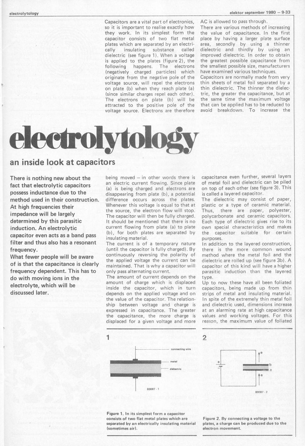

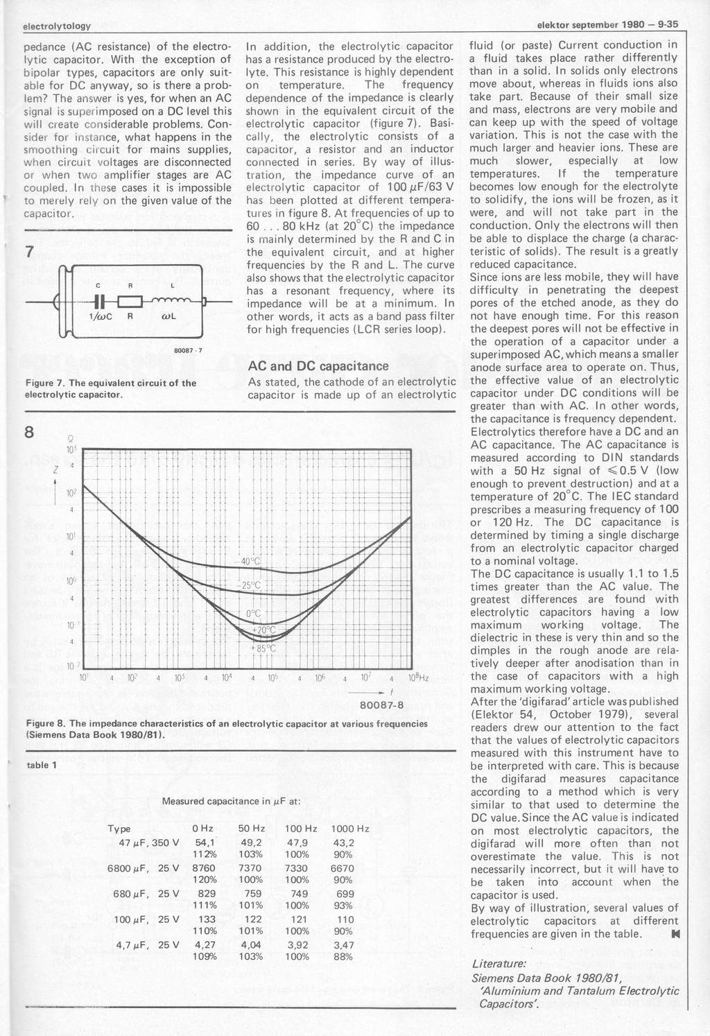

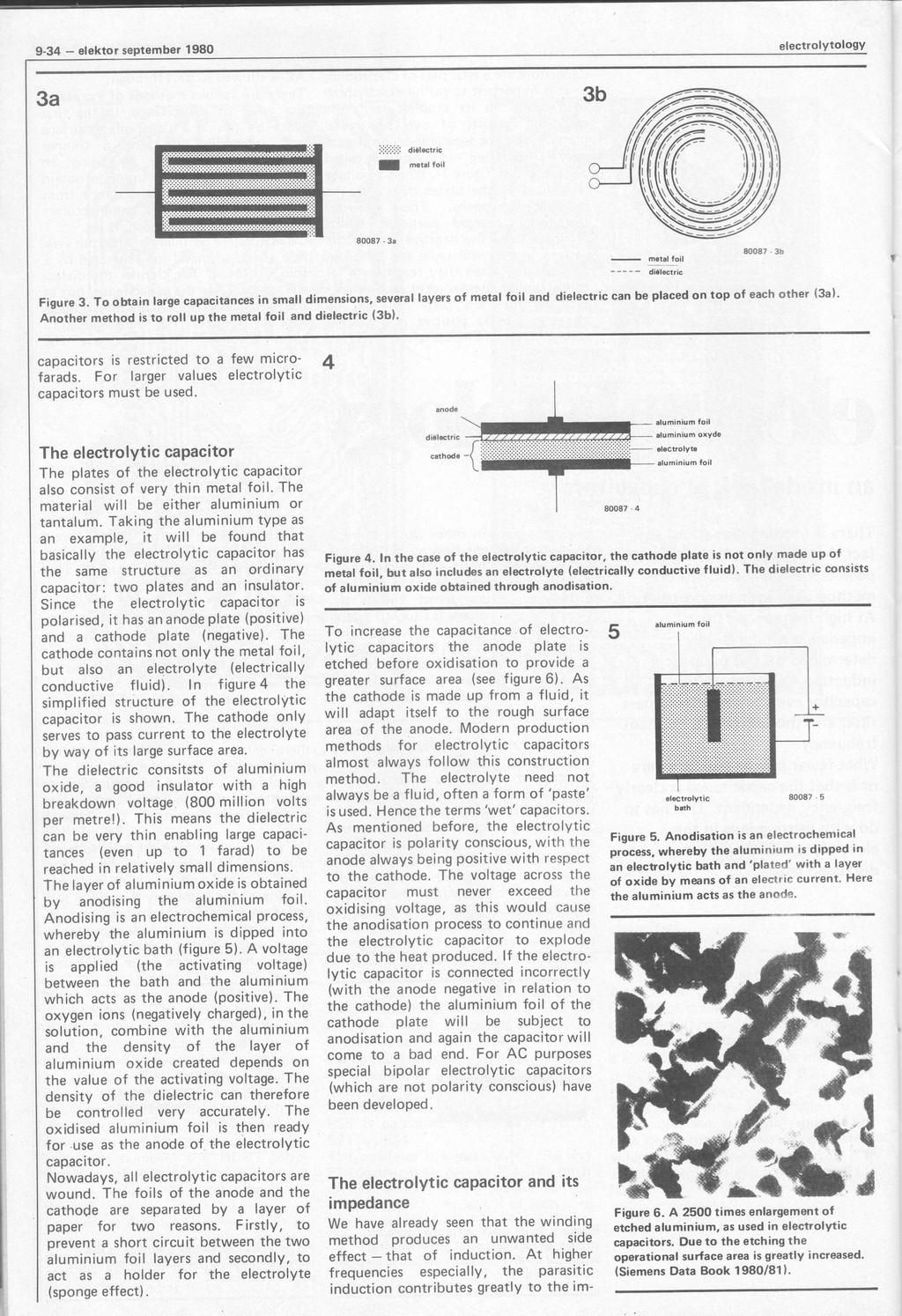

                              • Plinio, you have made a good observation about the different style capacitors. This is the first step in circuit design, one must use appropriate type of capacitors for the task at hand.
                                The following articles may help to see the vageries of capacitors. There are many articles on capacitors contained in old hobby magazines which are quite informative. I have found some very good ones. I'll try to post as many as I can.
