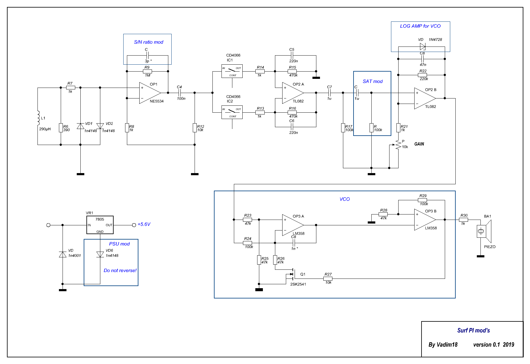

                    • Hi to all!
                      Time to write my first post at this wonderful forum)
                      I will try to be useful.
                      I build my version of Surf PI in 2016, it was a great start point to dive in world of pulse induction machines.
                      First start was not succesfull and at second time coil was not so good.
                      Now, with 14.5 cm coil i can clearly detect 23mm coin (1mm thin allu-bronse alloy) at 27 cm, untill it reaches 30 cm distance.
                      My coil: 290 uH, 1 Ohm, 14.5 cm
                      Damping resistor: 390 Ohm
                      My mod's:
                      1. I limit the bandwidth with 3 pico cap in series with feedback resistor at main amplifier stage, to get more S/N rate.
                      2. Modified the SAT path by simly doublling the order of filter, as result i reduce a low frequency noise and get more stable treshold
                      at hight gain. This modification also help to cut a little bit ground noise - main problem in this machine...
                      3. Added, a conventional VCO on lm358, to get more audible information about target.
                      4. Pull up power to nearly 5.5 volts at positive and negative rails by adding bias diode to pin 2 of 78l05 (with catode to ground!)
                      The main problem still ground noise, but in our location the are places with low ground mineralisations to.
                      I already read some forum threads and hopely try to make some mods later.
                      • This is not a problem at all, I think they can be proud of being posted on this forum.
                        • Hi Vadim18, you have a good working project, always good to hear of success with the surf PI, if you have any circuits that you can post about your mods please do so, so we can all learn about your machine.
                            Thanx fo reply Guru, i will do that as soon as possible.
                            • My Surf Pi modification's
                              • More info on the VCO Please ?
