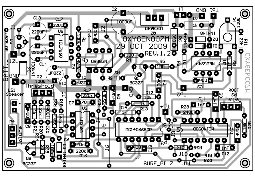

                              • I want to replace the speaker with headphone jack. They have to make modification to the circuit.
                                This is the pcb of my surf pi detector.
                                My English is bad sorry.
                                Thank you
