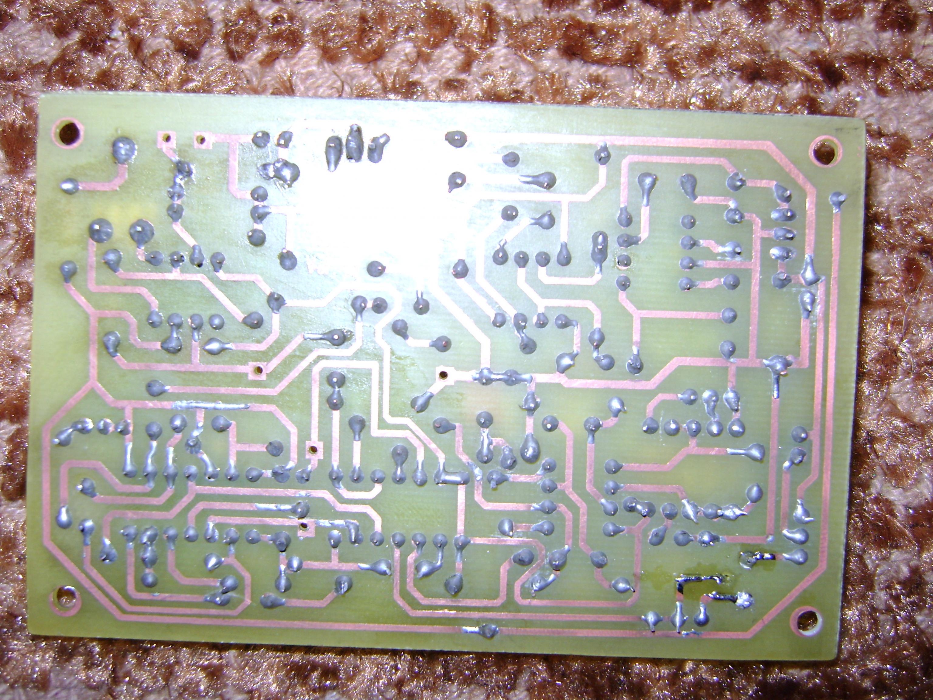

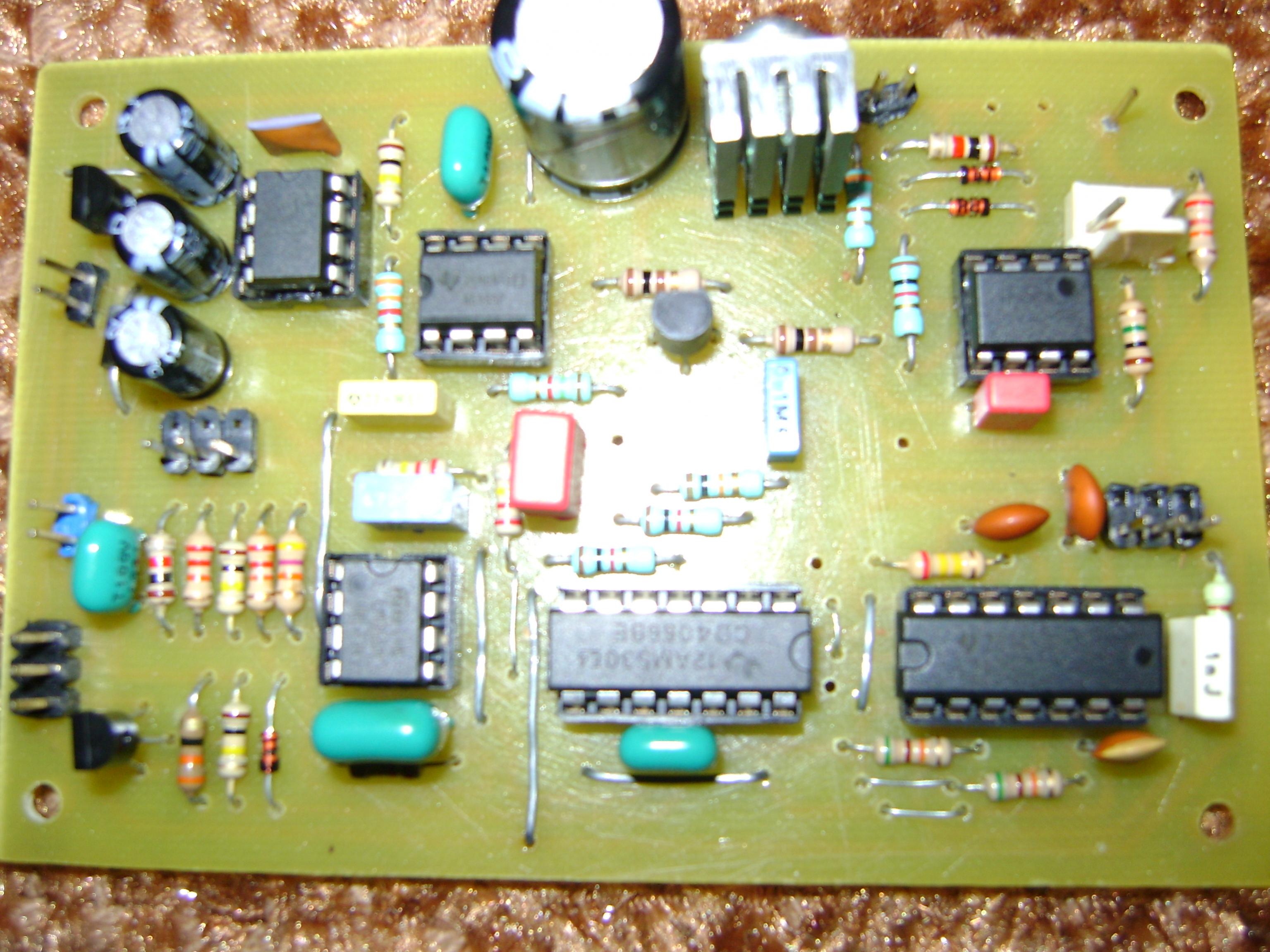

    • anyone can Help i finish Surf PI,but i have problem!when i conect to 12 volt battery surf pi producing too low noise(bipping),when i remove NE 5534 sound continue bipppiinng!!what is wrong whit my surf PI.
      • i got same problem like you!!!
        but no one give instruction street to the point
        HOW To FIX
        • Does the sound change when you turn any of the pots?
          • my pot work is only volume and 5kpot
            • Originally posted by joop View Post
              yea sound change,i put all new IC same problem!,any idea what is wrong?

                here is some pic,pls help guys

                  • Paku, you told me you have an oscilloscope, why don you post some oscilloscope pictures of PCB measurements?
                    • i have but i dont know how to test point on that pcb
                      • joop u ar right
                        i use the oscilloscope test point at the coil and i try tune the pot now the sound is gone
                        so i think the problem is coil right i use 6 diameter 20round wire
                        now no sound but i must make the new coil
