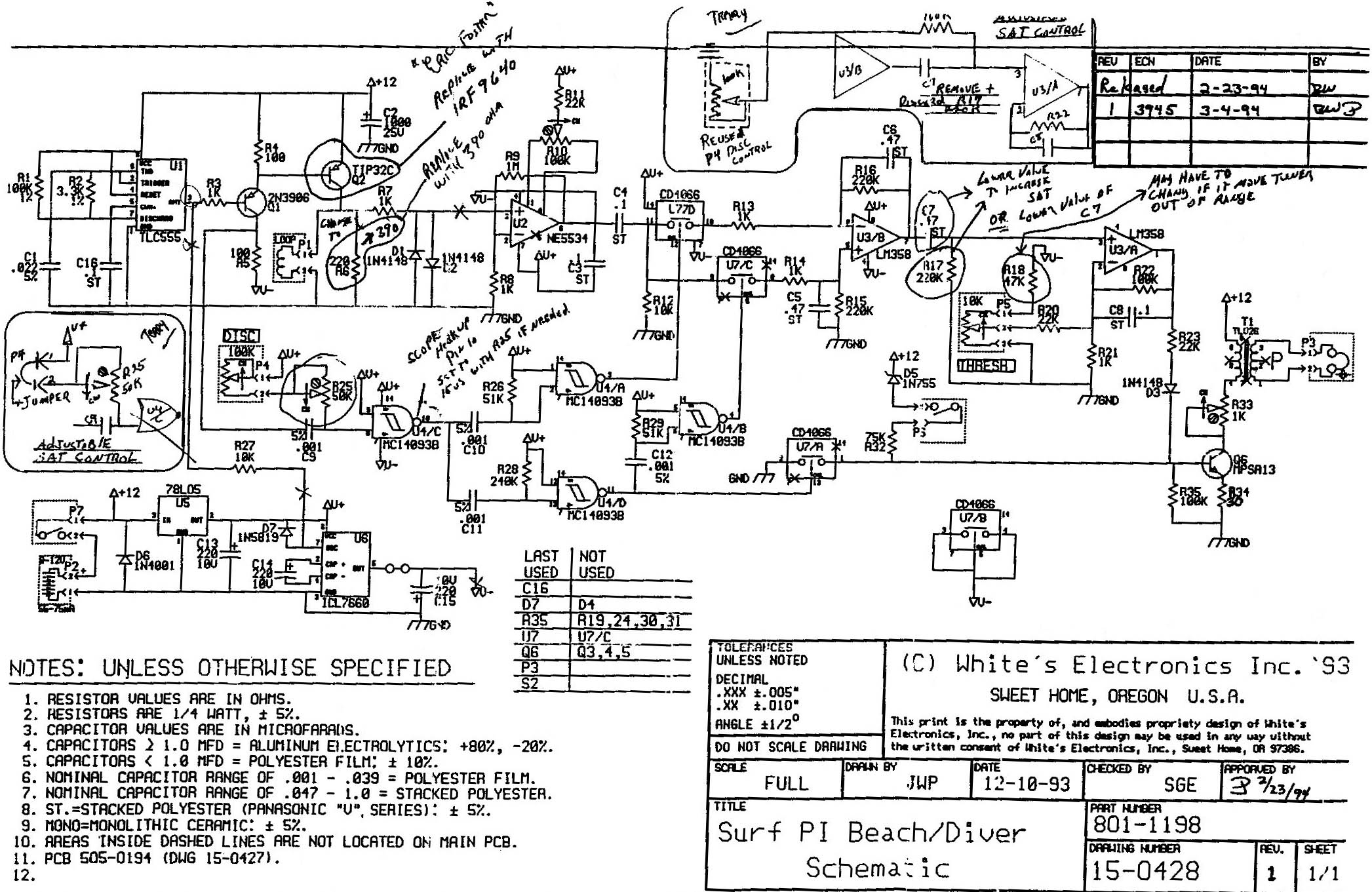

Whites Surf PI schematic

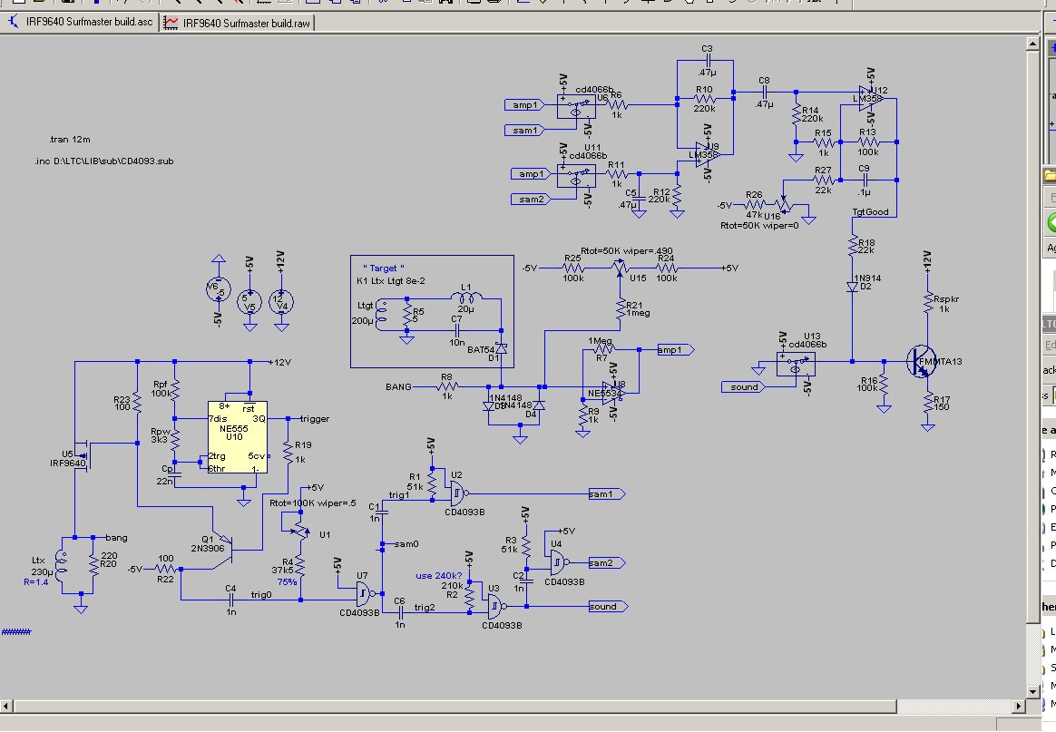

  • Here is an almost complete Surf-PI circuit. I think that the one-short pulse widths may be a little short compared to the real world circuit, so keep that in mind.
    I have included a small parasitic circuit to try and simulate a target. This might not be as good for realistically replicating a target response as it is for verifying that your amplifier chain has the correct polarity sense. Say, in case you wanted to start playing around with different configurations you might want to reverse the sample1 and sample2 inputs to the sample amplifier and see that the output will slew the other direction from before. Or, if it doesn't change direction you might want to find out why.
    I replaced the TIP32 with IRF9640. I was sort of baffled when as I saw the TIP32C flyback peak at about 150V because that device is only rated for 100V. Now, I don't have to ponder that anomaly - I just ignore it. (Hey, there are only so many hours in the day.)
    My NE5534 model is like most other simulation models of parts with compensation or nulling, in that only some of the pins are modelled. Here we have the compensation pins modeled when they are not used, and the offset pins that we could use are not modeled.
    I have included the CD4000 library without change but I did not include the complete symbols libarary which is available at the LTspice Yahoo users group.
    The original NE555 symbol provided with LTspice is in the MISC parts folder. I modified that symbol to make it smaller and easier to wire for the majority of schematics that I've seen. The model is the aame but the symbol is different. You can either use my symbol or else move some wires around and use the default 555 symbol.
    I think this should run so long as the parts and symbols are kept in the same folder as the .asc file. If the parts don't fall into place then look at the screen shot for parts placement.
    edit: If the BAT54 diode is not included in standard.dio then use any schottky available. If I left anything else out, let me know and I'll make it right.

    • For those interested, check out patent 5,414,411. It covers this circuit and has a good description of the various sections. Something must be wrong with my detector as it describes the coil output of 100-130V and mine is 87V. I'll make up a coil to substitute and see if things change.
      Barry
      • Make sure your output pulse from the 555 is about 50us. The -currently available- CD4093 model needs some major adjustment but the LM555 model is pretty accurate.
        If you have 50us, make sure your resistors R4 and R5 are 100 ohms, and R3 is 1k to drive the 2N3904. It might be easier to replace the two transistors (starting with the 2N3904) than messing with replacing the coil!
        The simulated waveforms in the transmit section should be pretty close to what you would see on your scope.
        Your coil/cable should measure about 1.4 ohms (and 230uH). I think it would take a serious coil malfunction (something you should be able to measure) before it would affect the flyback as drastically as you say.

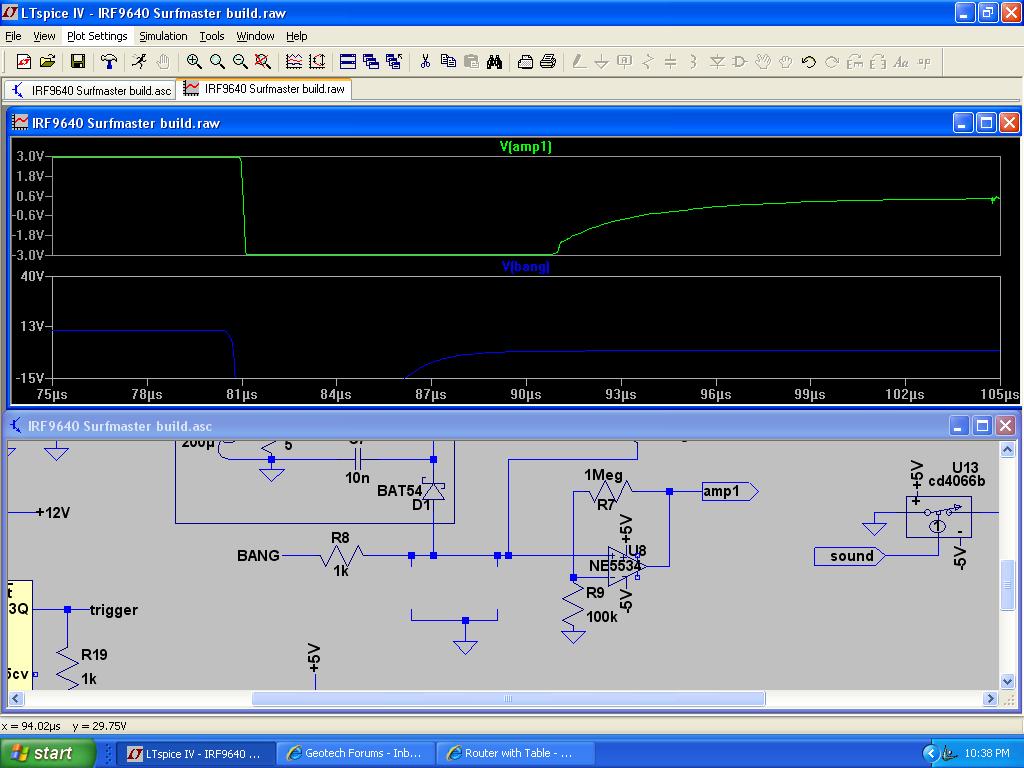

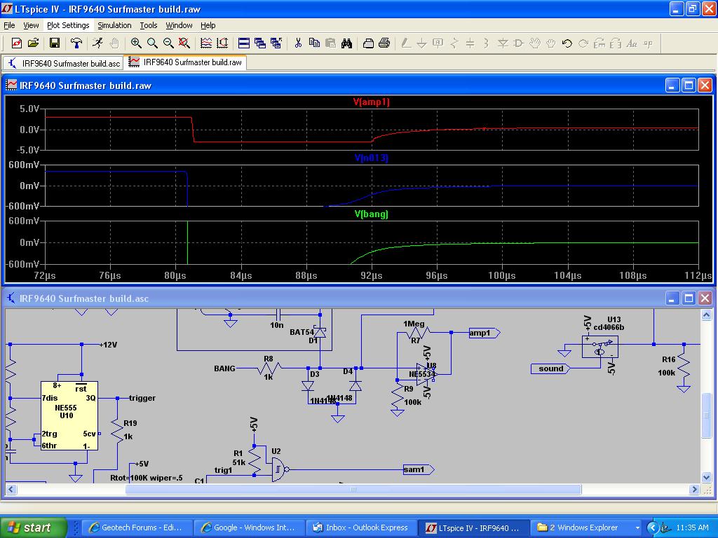

            • I have attached delay.jpg to demonstrate my problem understanding the preamp circuit. You can see that the input and output are delayed by at least 6uS. Perhaps this is due to op amp slew rate? This is not a coil speed issue but a circuit delay we'd rather do without. You can see that I have reduced the op amp gain considerably by replacing the 1K neg. input resistor with 100K. I also deleted the input diodes to negate the weird things I was seeing with them incircuit. Maybe this makes sense to you guys, but not to me....
              Barry
              • Ok, no comment means my brain cells are screwed up...
                I temporarily fixed that and can now see things line up as I would expect to see.
