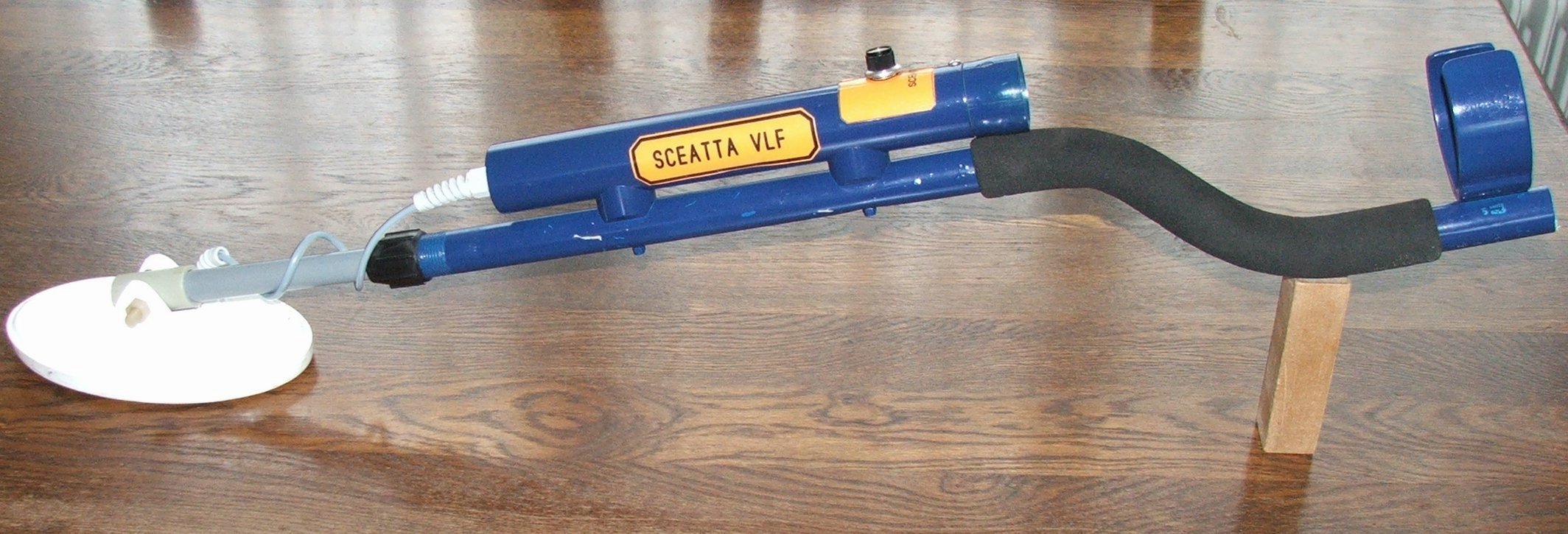

    • Hello Cudashark, and friends
      Ok a small pcb is a must for dive stuff, but start thinking from the housing you have ore can make ! ( a pcb is lots easier to make than a good housing for diving !! )
      Also the way you like your target signal ! Speaker ore leds ?
      Best is sound I think…, leds in clear water and sun in a not to deep dive is not good !
      Leds must take your attention all the time, sound lets you more freedom.
      Also no headphone , so no wire ! Make the piezo part from the UW housing !
      For sound you have to find a good piezo speaker that fits the output audio, ore better make in the circuit a audio output that is adjustable in freq. ( better idée s are welcome ! )
      For housing I use pressure pipe to make things waterproof use always good O rings, glue is not the best solution ! The end caps are solid pvc.
      With some trail and more error I made some housings for diving look at the photo, this is a detector for our grandson. The long PI print also fits in it .
      Best regards.
      Ap
