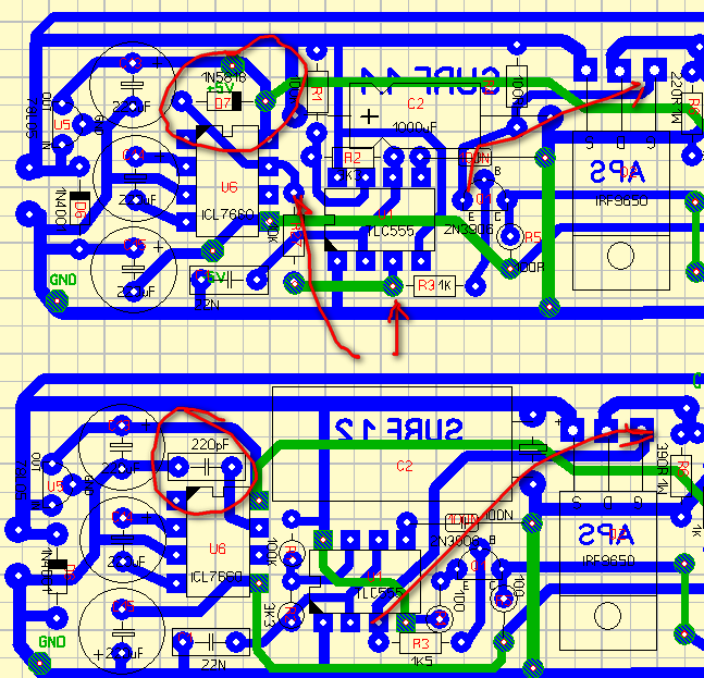

                            • Hi Dirceu!
                              Excuse me I have a question yet. Two versions are for the supply voltage. At one the 7660 frequvency from 555 pin 3,at the other one the 7660 oscillates with a 220 pF . Which one did you use?
                              And the fet direct it from 555 receives a sign or from the transistor.
                              Best Regards
                              excuse me my English
                              • Originally posted by Gyur666 View Post
                                Hi Dirceu!
                                Best Regards
                                Hi! Gyur666
                                I don't like sycronizations with power sources.
                                Yes! mosfet signal come from directly of pin 3 555.
                                DIRCEU
