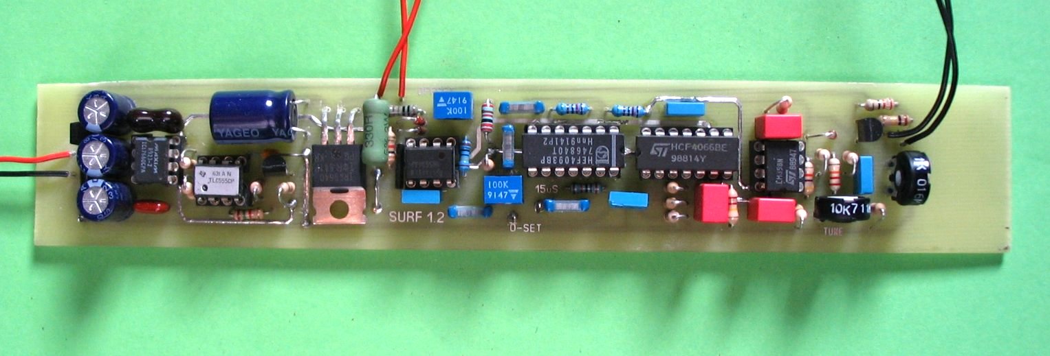

      I have done PCB for SurfmasterPI in Layout.
      Layloat files you can download here : http://www.md4u.ru/forum/viewtopic.php?t=268 . Maybe there is some mistake.
        Hi! I dont know it is pro or not version. I desined PCB from picture in this theme.

            I just have make Clone W (autor Andy_F). It is very simple and powerfull MD.
            it is located there : http://fandy.front.ru/ClonePI_W.htm
            I maked it on my board, nice detector!
                  analog of ADG444 are : КР590КН5, DG444, MAX364
                  analog of 1N5819 1N4007, it is protect md. It is not nesessary.
                  TL431 - is widespread, it is not problem to find it. it is as a last resort possible not to use him.
                  BSN304A - BSN304, but its have different pin.
                  Nobody have full program for Tracker Pi2, I maked Tracker PI2 too, but Clone-W much better

                    Nice Work OSTIN !!!! I thought the only differences between the Whites Surfmaster PI series was in the Search-Coils ?? Thanks again for posting your Lay-out photo..............Regards..............Eugene52

                            Made a long pcb( 2side pcb) some years ago, easy to make it waterproof. Think I made it in protel, have to sears for it. As I remember it was sometimes a litle erretic indoors. Never used it for real searsing, made only some proto's. Can send in a Pmail the pcb file (need to sears on some cd's) if you have interest in it ?

                              I' have new PCB, new plains to built IT very simple and good PI metaldetector

                                Here is a version that has the mods. that are on the handwriting corrected circuit .
                                I only have tested it indoors. Looks it is working good !
                                The notes on the circuit are mixed , look at it.
