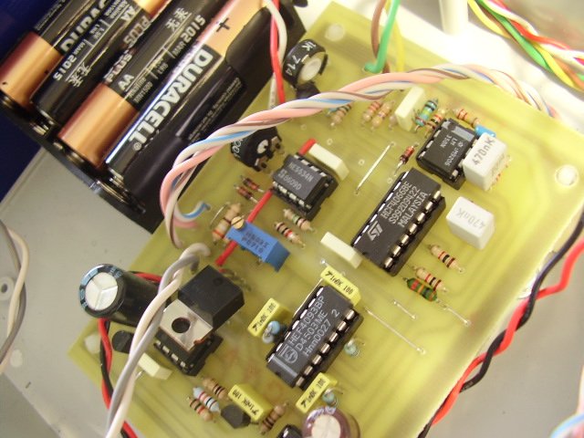

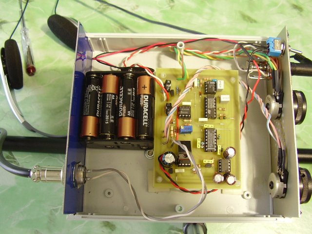

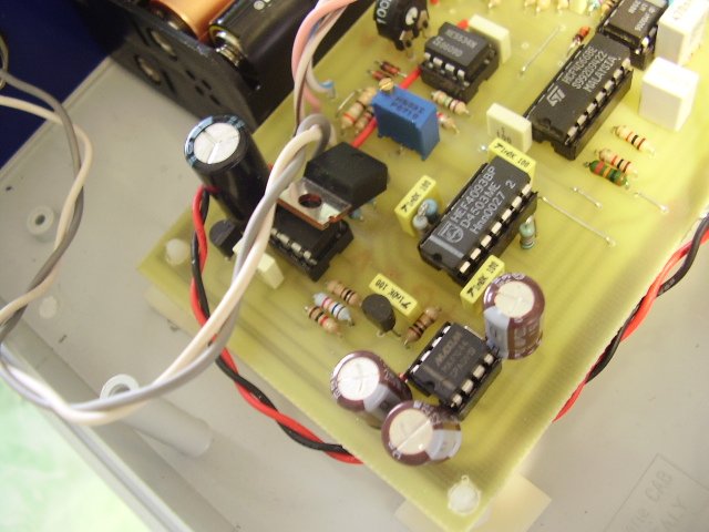

    • #47
      surf PI PRO
      My single layer PCB

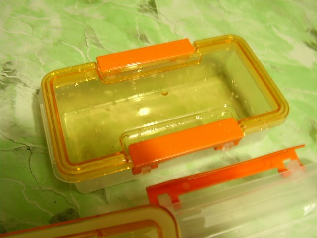

            my next job is to make an other surfmaster and to put the PCB in this water resistent box (excuse my english)
            • #51
              Box
              Very great box !!!!

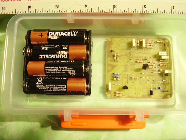

              • #52
                box
                is a small box for another surfmaster PCB

                    Hi Cordius and congratulations for such nice work.
                    Also i will like to know your expirence with this project. What about deep range, what coil did you use and also let us know if your single side pcb is the one show here on the post, that was made on sprint layout. Does it has any errors?
                    In advance many thanks
                    Nelson

                    • #55
                      Hi ApBerg.
                      I already had check Whites surfmaster files that you post and it looks fine to me.
                      I ll also like to know if the one side pcb posted here is a good working pcb?
                      What about coil data?
                      Nelson

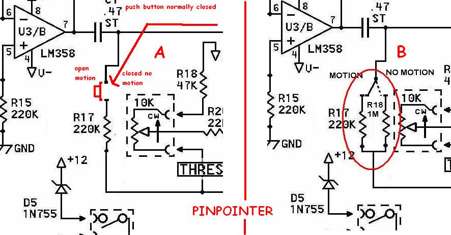

                      • #56
                        Hello Nelson.
                        I am sorry, I have only double side pcb's from the surf. I made them for dive use, they can made easely waterproof in a tube.
                        Hello Cordius.
                        Looks nice work, for the pinpointer option A look at the text for motion no motion ?
                        Can you share the pcb layout ?
                        Best regards.
                        Ap

                          • #58
                            hi, excuse me, open button NO MOTION, closed botton work in MOTION.(use only normally closed button) Do not use always with open button, only detected targhet. I' like button ("A" design).
                            Original coil 23 cm, 20 turns, 0.5 mm wire.
                            I use 25 cm coil 19 turns, 0.5 mm wire. (good)
                            I tested 20 cm, 24 turn, 0.5 mm wire. (discrete)
                            1 euro air detect 23-25 cm. (25 cm coil)
                            Excuse my english.
                            I have PCB file, request only PVT message or e-mail

                              • #60
                                surfmaster in the water resist box is not finish i don't know if it work and is downloaded in this forum opened in sprint layout.
                                first surfmaster i post here, you see mounted, work very vell, is single face pcb aslo.
                                If you contact me in PVT and write your e-mail i send you all file to built it.
