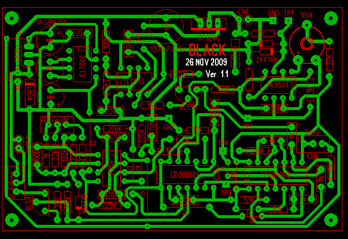

                • Complete detector. It works well except that I have two problems.
                  1) Review with the photolith pen, the tracks are very close to each other.
                  2) The detector after 15 minutes it begins to make strange noises.
                  3) I can not put 12V, starting a sound impossible to be silent. I have to feed 11V to operate.
                  Anybody can help me find out what is going on?
                  The detector is a copy of it.

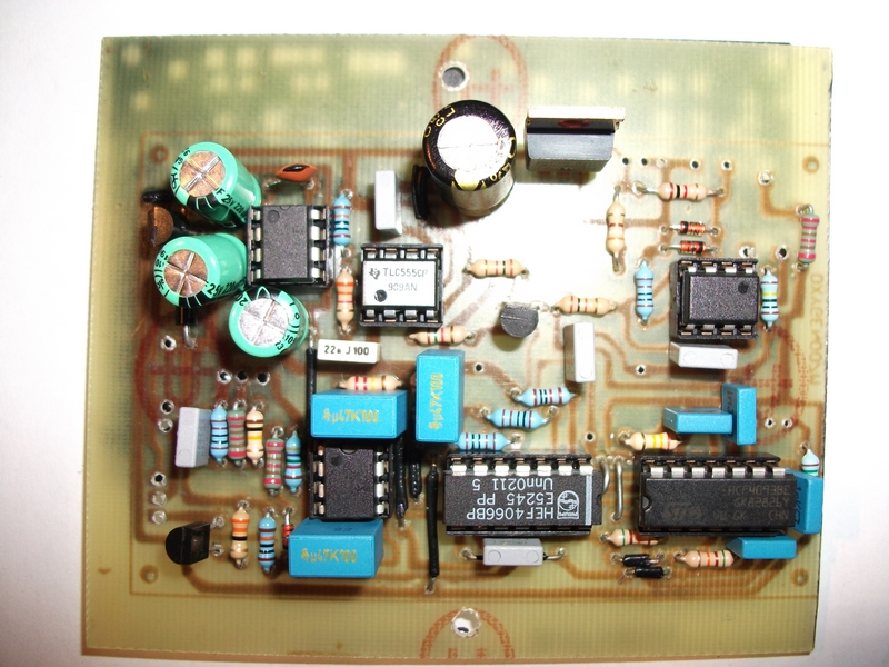

                  • Hello
                    Q6 is bc 337 & maybe reverse ,look 278. mail from Waikiki sweep
                    Best Wishes
                    Erol
                    • Originally posted by erolunall View Post
                      Hello
                      Best Wishes
                      Erol
                      Hello.
                      It is possible that this evil inserted q6?
                      Sampling metal detector image of itself
                      • Q6 and poorly inserted FINALLY Changed By MPSA13 Now everything correctly.
                        The coil is made of 190 mm internal diameter of 22 turns, 0.4 mm enamelled wire.
                        Spool of thread connection for a circuit and hi-fi free of oxygen.
                        Tests: 1 euro 26cm in air
                        can of soda: 50 cm
                        The detector has been very stable. Now to test in the field.
                        Thanks for the help. A greeting.

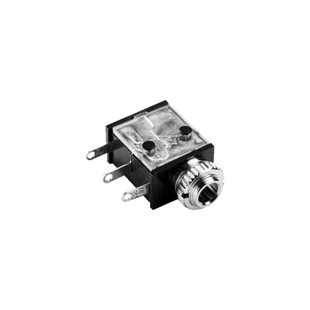

                          • Hello, my sufmaster works perfect. But I have a problem, want to replace the buzzer for a headphone jack. I have this jack female.
                            As I can connect?
                            I need an amplifier or something similar?

                              • Originally posted by Virdi_248 View Post
                                As I can connect?
                                Thats a Mono Jack.
                                If you have Stereo Headphones, you want a Stereo Jack.
