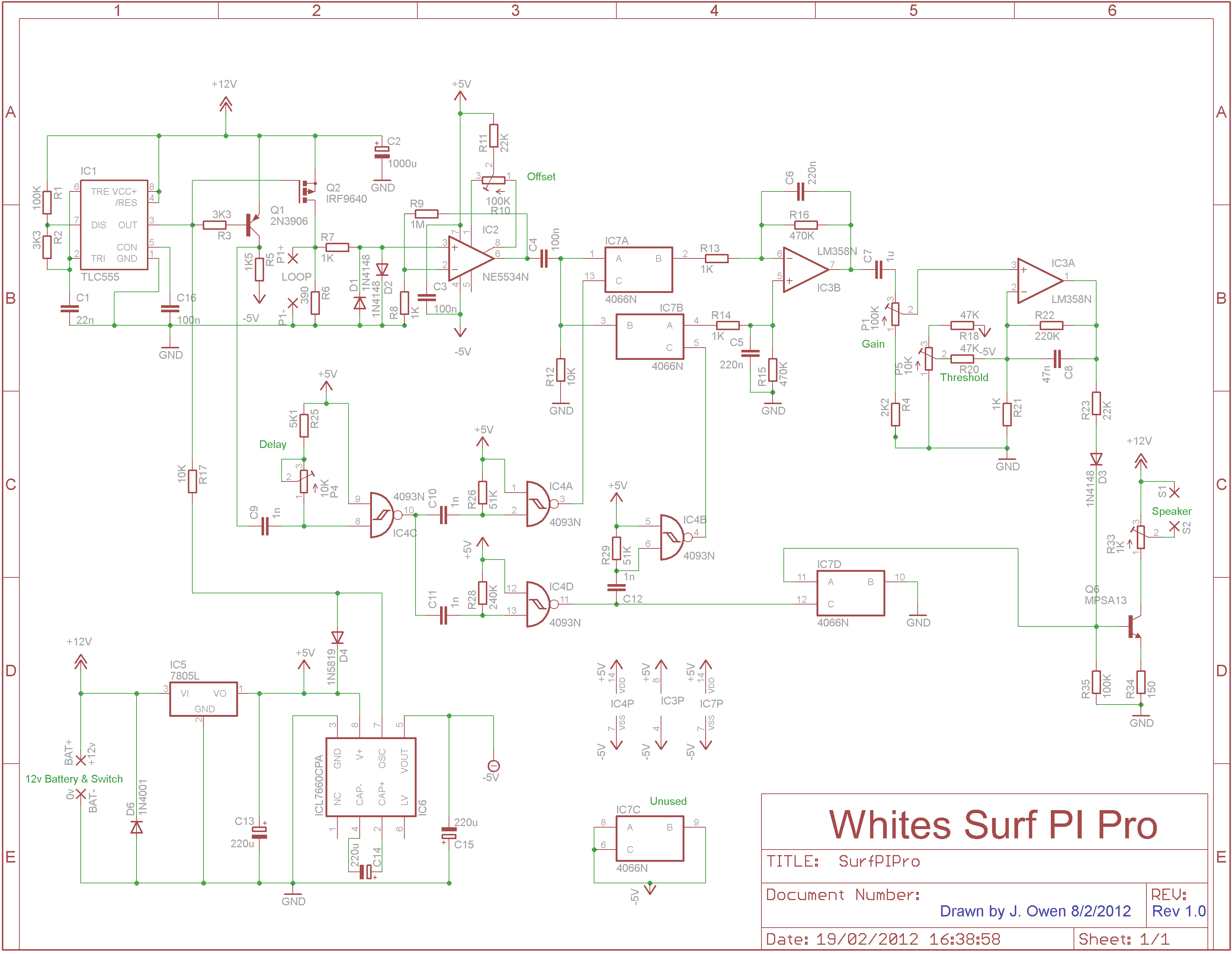

Whites Surf PI schematic

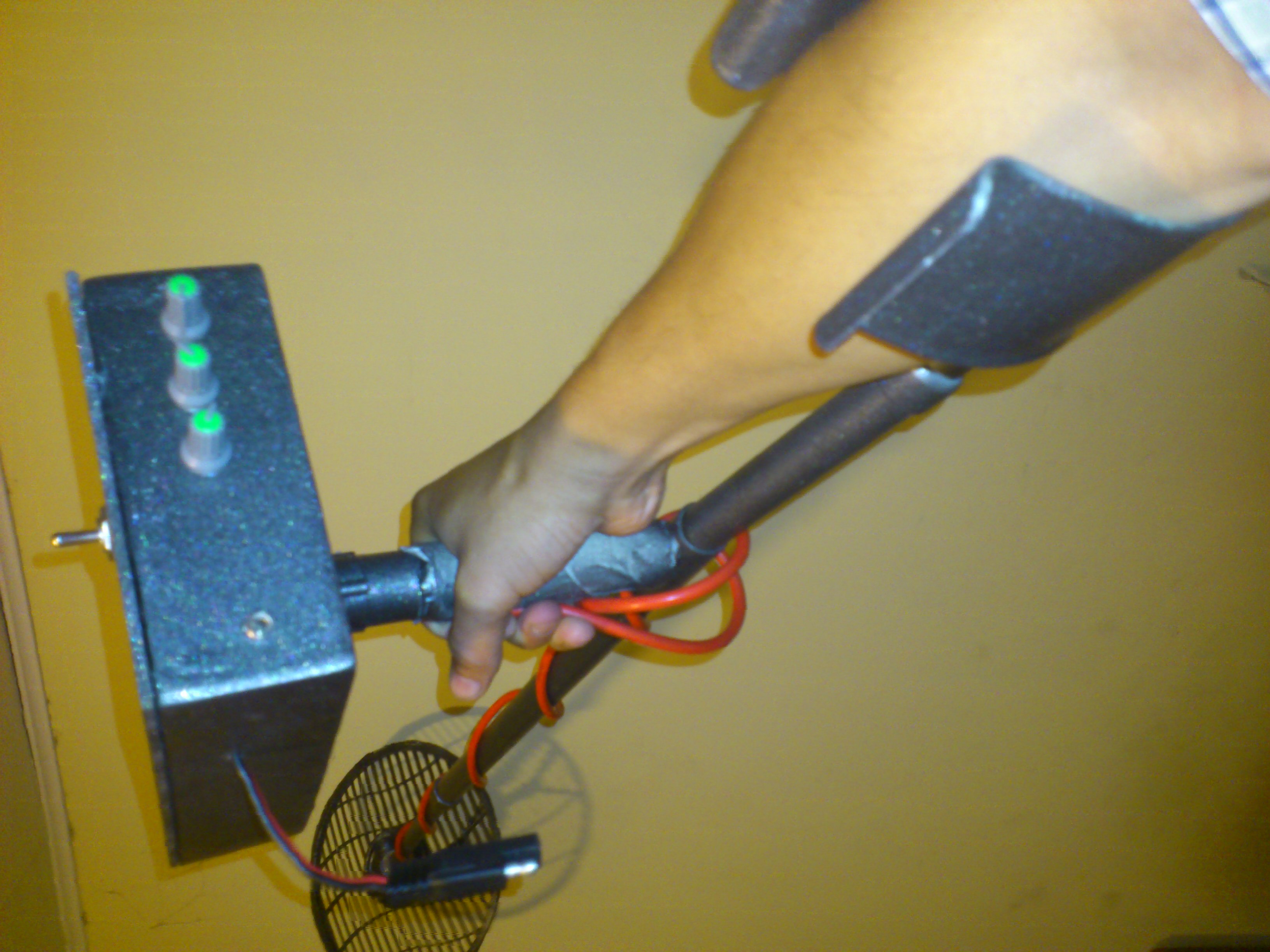

    • Originally posted by ricalbertvig View Post
      The pcb I made it I, Using wizard
      Can you Send Your Pcb with us
      • Comment
          Wow Very Nice Work
          • Why This PI Sound different like your PI Sound
            • yours is a motionless pulse detector and mine is a moving pulse detector

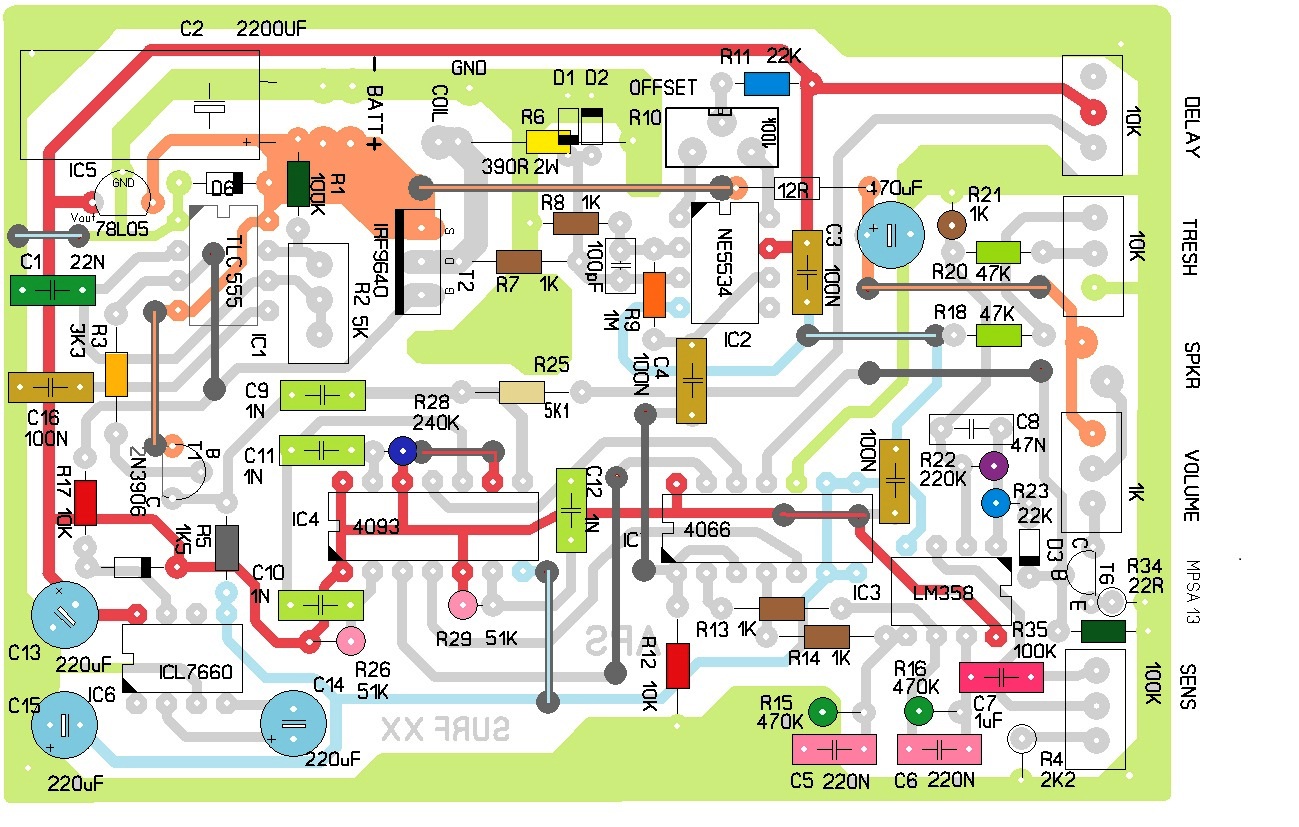

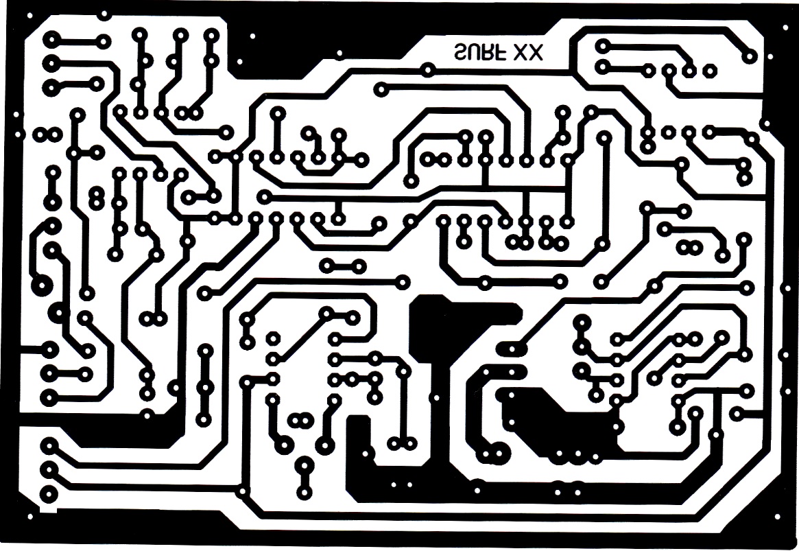

                      • Can someone please collect James Owen PCB single sided design,
                        part placement and part list final version for Surf PI on one place and post here.
                        I have read all of 27 pages and there is many mistakes in PCB design or PCB is not black and white or not proper size for etching.
                        Thank you!

                              Dave,
                              this is Surf Pi Pro - SurfXX, ApBerg design, I have made this MD but it is not working for me.
                              I am looking for Surf Pi, thank you for your time.
                              • This post has it but it is not proper size when you print it.
