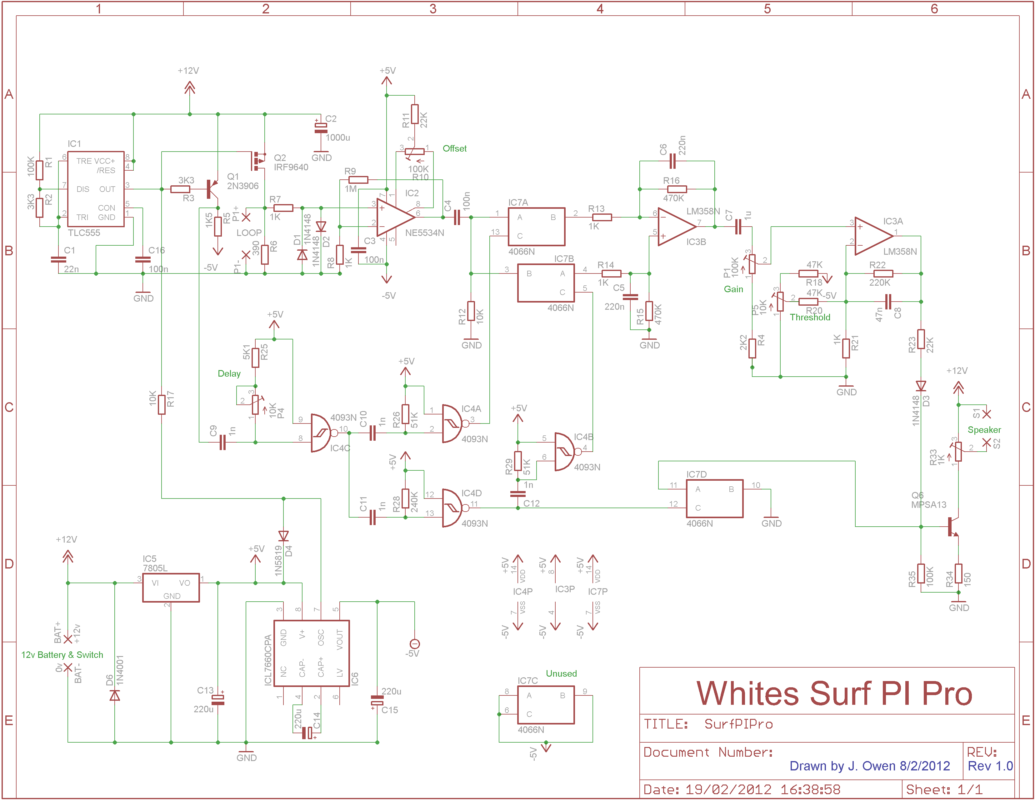

Whites Surf PI schematic

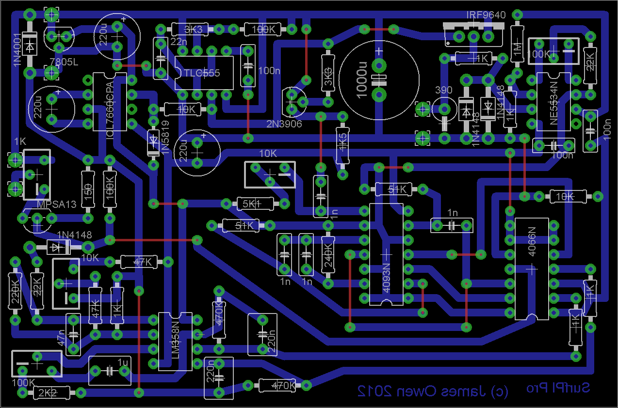

  • James Wilson Surf pro Circuit diagram plus board print template
    These are the ones by James Owen
    Sorry about the Wilson shows how tired I am
    • and the rest to go with it
      Just realized ive already posted it all so just a repeat never mind better to much than to little.
      Anyone want sprint layfiles of the single sided long board just ask'

            • Part list
              Do you have part list for this project ?
              Or it can be exported from layfiles ... please post

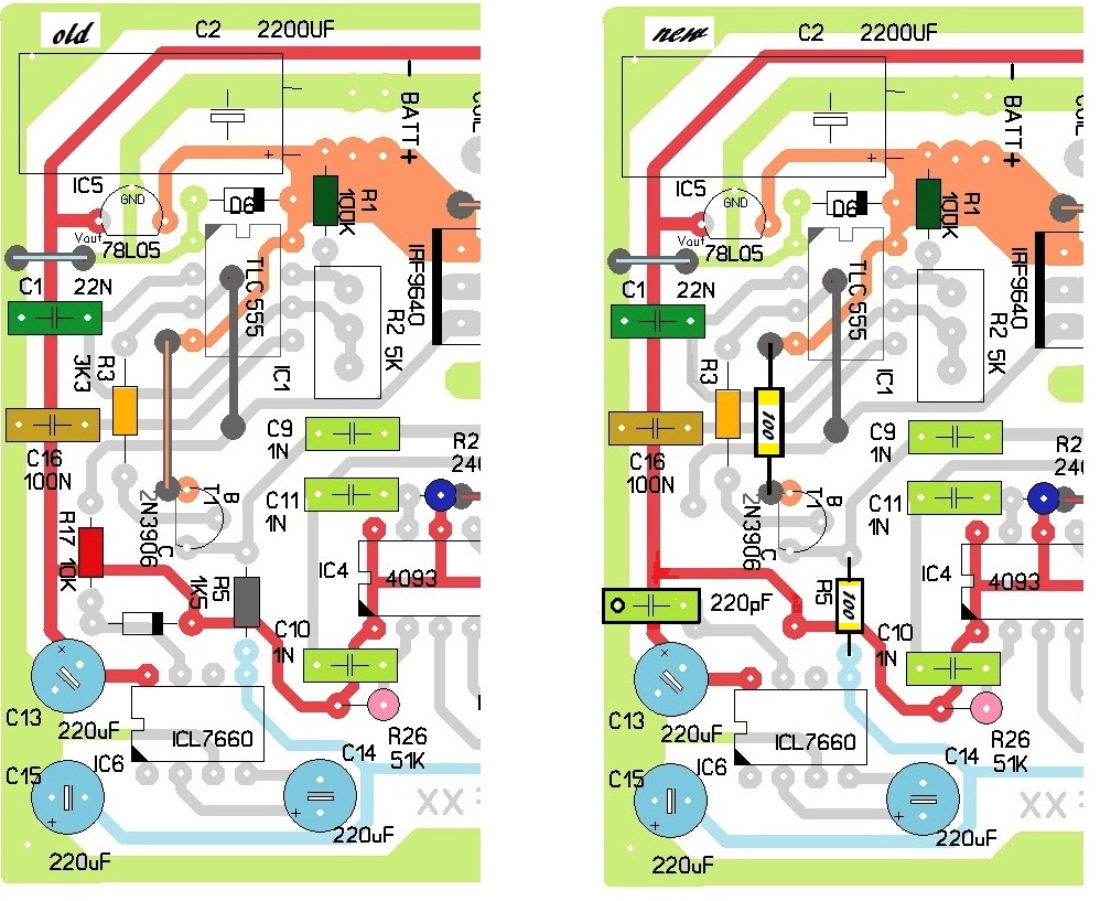

                Hello Friends,
                Well if we where neigbours it was easy... a cup of coffy and some live to the scope...but as we are from al over the world this in not easy to do...
                In the past I made from the Surf some different boards, build them and had no problems so far..but as other components can be used ..
                Looking at al the posts about the surf I see that there are some problems here and there..
                Also "Joop" had a problem with the sync around the ICL7660 and made a mod as follows ?
                So it can be that a modification can help solving the problems some have ?
                Look at the drawing...
                Replace R3 for a resistor 1k5
                Remove link from the +Batt to the 2N2906 and replace this link for a 100 ohm resistor
                Remove R17 and the Diode
                Drill a small hole in the ground track to place a cap from 220pF that has the other leg in the anode from the removed diode
                Replace R5 for a resistor from 100 ohm.
                Well I hope I have not made mistake's but... I hope that more off us will check this mod.. (If I had to eat al the mistake's I made in the past... ...)
                Best regards.
                Ap

                • i have two complete surf pi pro xx here i think i can try the mod on one board and compare the difference
                  thanks for posting the mod

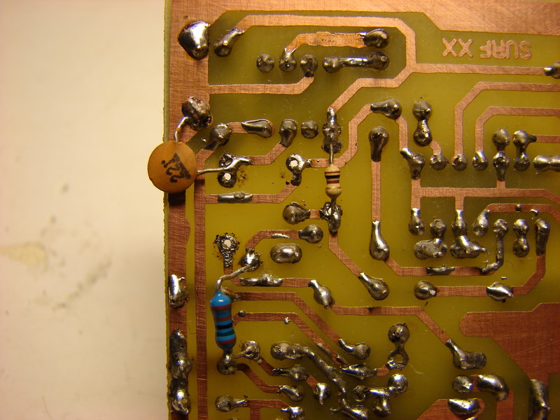

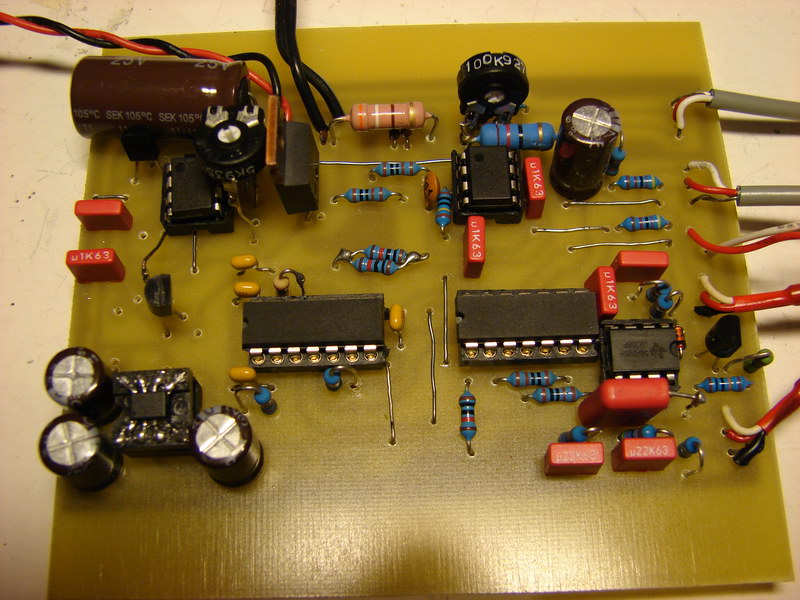

                  • Looks like I am the first to try this mod ... my Surf Pi Pro is not working anyway.
                    With this modifications it is not changed.
                    Replace R3 for a resistor 1k5 OK DONE
                    Remove link from the +Batt to the 2N2906 and replace this link for a 100 ohm resistor OK DONE
                    Remove R17 and the Diode OK DONE
                    Drill a small hole in the ground track to place a cap from 220pF that has the other leg in the anode from the removed diode OK DONE
                    Replace R5 for a resistor from 100 ohm. OK DONE
                    I have now have one spare diode, resistors 10k and 1k5 free for next project.

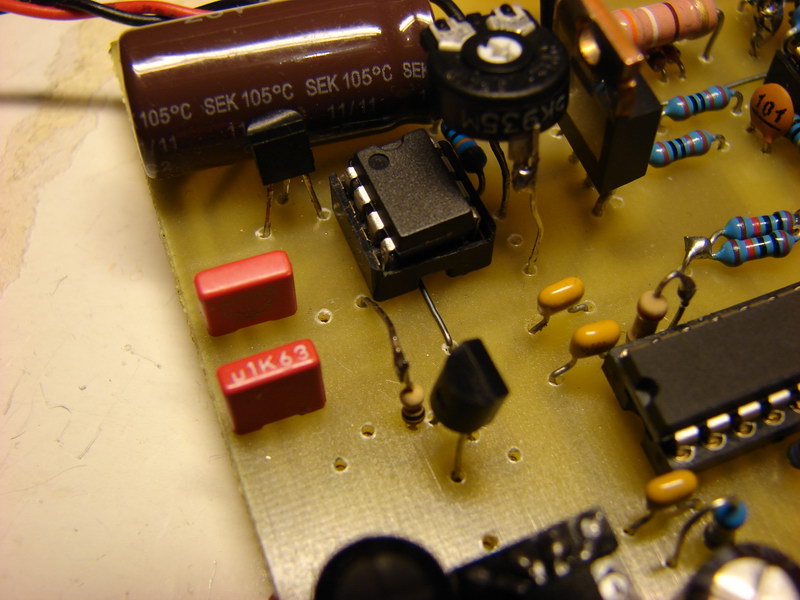

                    • here are few pictures of my battered Surf Pi Pro taking another modification

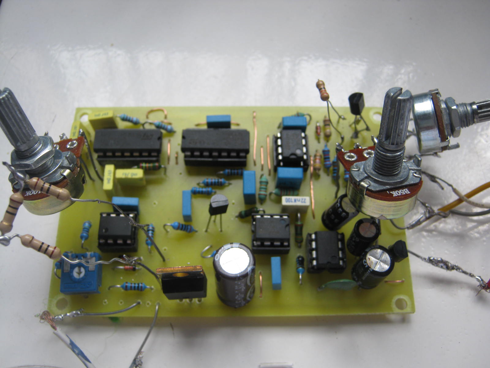

                      • These are the difference
                        I used trimmer 3k3 as R2,
                        my 7660 is smd, my 2N3906 is BC557C
                        R25 is two parallel resistors 10k
                        R34 is 140 ohms
                        D6 is 1N4007
                        C2 is 2200uF 25V
                        My IC's

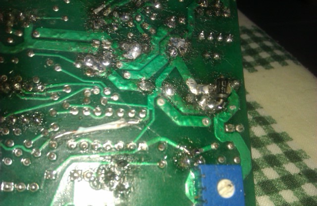

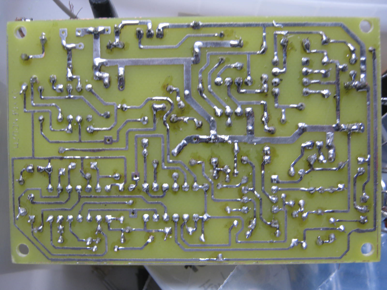

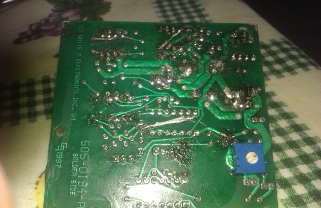

ID:	335763Greetings all, I got a broken surf original IP, but I can not fix it, streaming audio, dump resistor 330 TIP127, please tell me the tp control, thanks.Click image for larger version

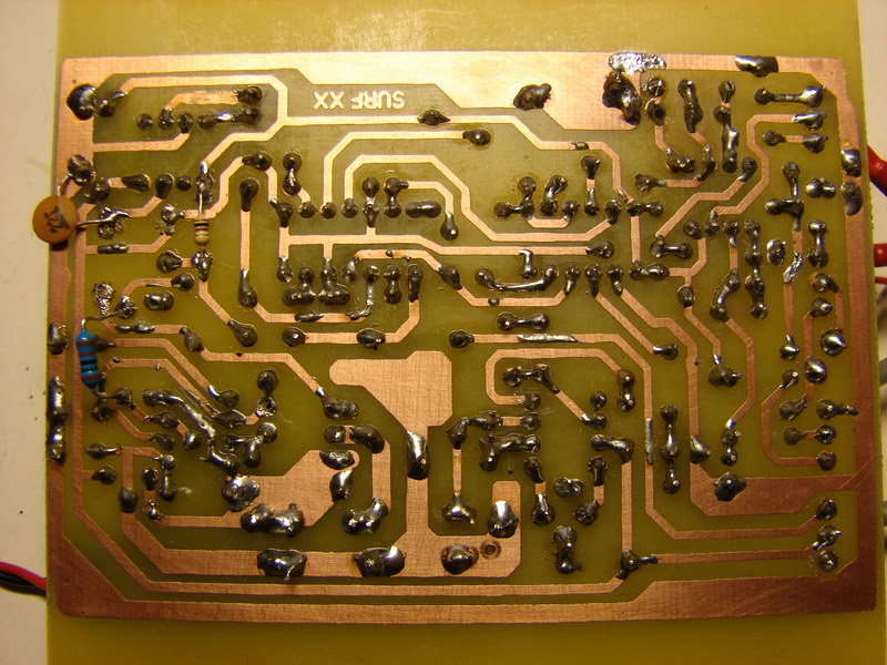

                          • can you desolder all PCB and give pics of both sides? your pcb seems was water leaked...
                            • Photos PCB tp adjustable headphones 9 v, 0.53v coils tp, tp turne 0v, thought change for IRF9640 orClick image for larger version
ID:	335770Click image for larger version
ID:	335771Click image for larger version
ID:	335772 TIP42C TIP127 Thanks Hi

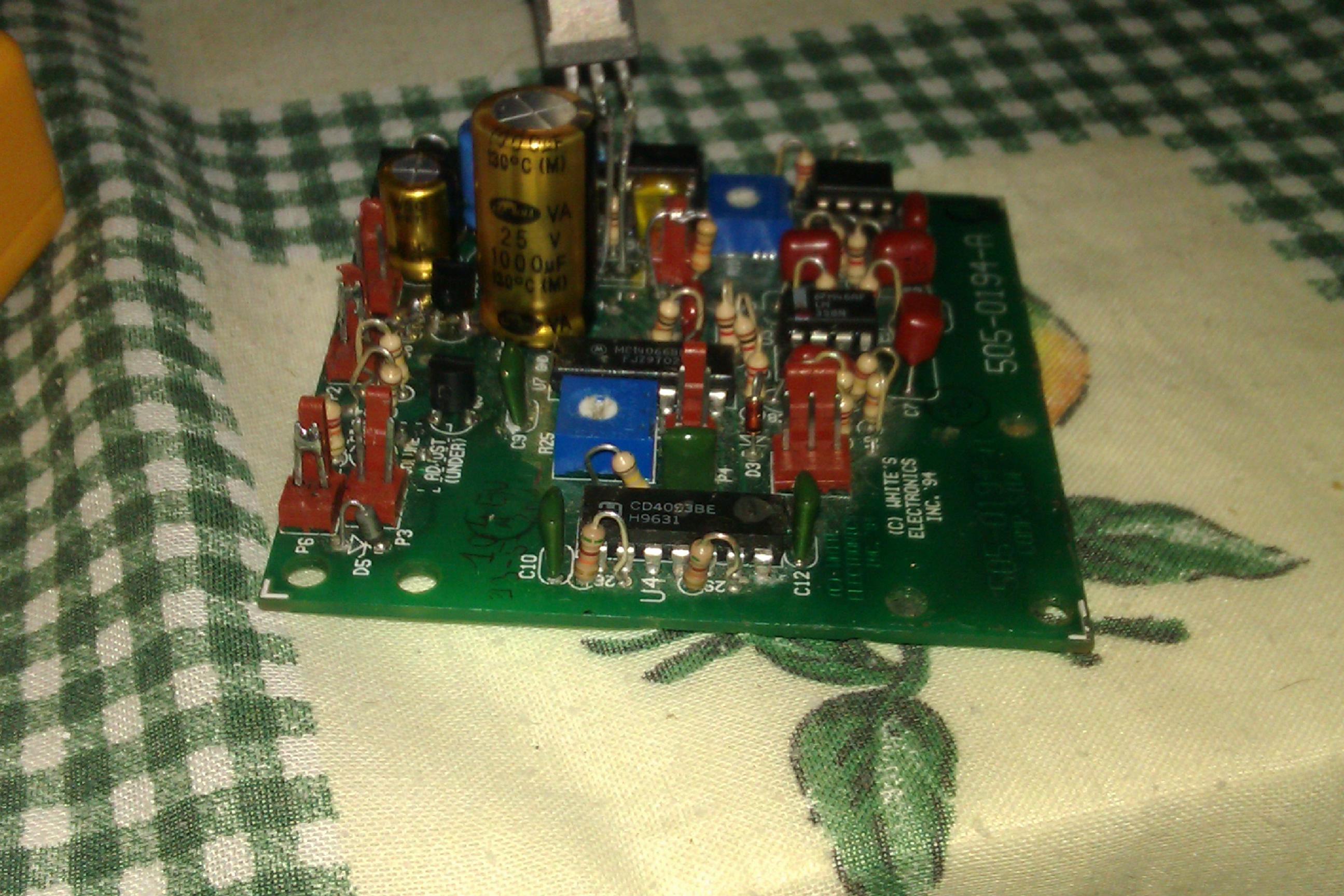

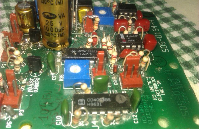

                              • Hello everyone. Its main surf.No sound, may have given some to help me. I looked at all the posts I have found a similar problem anywhere. thankful in advanceClick image for larger version
ID:	335982Click image for larger version
