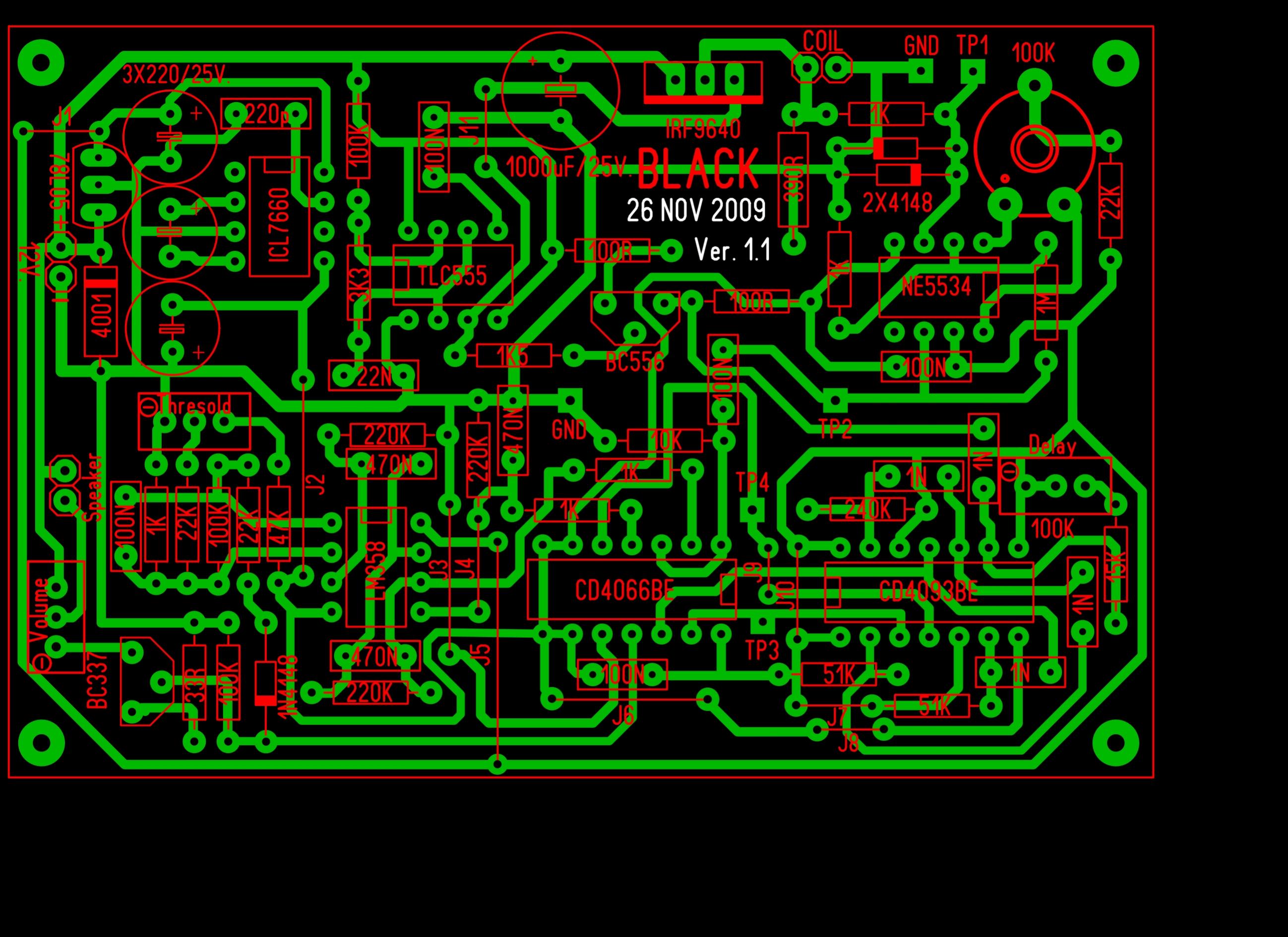

Whites Surf PI schematic

        I dont know how fix this,i make new surf pi and same problem it is really annoying when i go search.
        i try new coil with shield whit out shield same problem.
        also i change cable still same.
        I make this surf pi

        • someone found problem for constant beeps in surf pi.I changed the components 2 times and not forward

            Try to used unshielded coil and test if it still constantly beep.

              Today i make new Surf PI and new coil shielded but same problem(when swing to right make sound lol)
              also i go out from my house its more stable but problem remain.
              I dont know what is going on in left side no make sound only when swing to right.
              Be sure that coil is fixed to the housing thay it will not have movement, also be sure that cable connection is properly join and not loosen, check also your board for parts that will shake when have movement.

                It unlikely to be a fault with the Earth Field elimination, if it can pass the magnet test.
                I suspect it's either a coil cable shield problem, or a loose connection. Have you tried the detector with a commercial coil?

                        • This question has featured on a Minelab "Frequently asked Questions" site. They give the answer, " Usually because you are lifting your coil at the end of the swing- always keep low, slow and level for the entire swing". That makes sense as a right handed person would probably lift their coil at the end of the longer right direction swing but keep it level with the ground and closer to their body on the left direction swing. The sudden lifting probably changes the previously balanced out Ground Effect thus causing the detector to signal. Also, other people give "sensitivity too high" as another possible reason.
                          • That problem is always there when you have something moving - coil : stem : cable
                            Detector is detecting it self ... or you have problem with connector - probe to housing
                            • if pulse detector use -5v + 5v power, 9540 irf when you swing the coil unwanted sound occur, i shilded my coil today, gap and connected negative pin battery, same status
                              • i went to the beach yesterday to test my modified surf pi and i was getting these false bleeps as i swung the coil and i got worried ohh there must be a problem then i sussed the problem !!! i had forgotten to change my shoes before leaving home...i was wearing steel toe cap boots...i felt such a plonker
