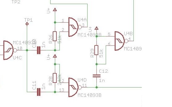

    Hello.
    I have a question about the surf 1.2 delay test piont.
    If I observe the pulse at tp and measure the time with scope... Is the lenght of the pulse the actual delay time?
    How to measure the actual sampling time if I want to set it
    at some desired value? Can someone explain or direct me to the right post?
    The signal at the test point (TP1) is a delayed version of the TX signal. i.e. the main sample delay.
    The main sample pulse can be found at U4 pin3, and the EF pulse is at U4 pin4.
    • Delay is from the End of Tx Pulse to the Start of Sample times.

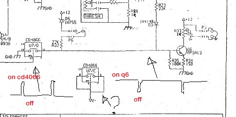

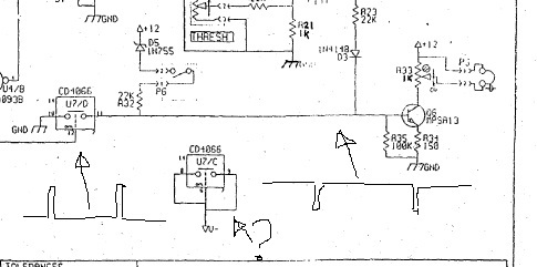

              • In circuit there is a problem with creating the sound. Everybody make" Surf" and no one notices ...
                • Originally posted by scs View Post
                  as long as is working... no one thought about it. is the 4066 D switch cutting over audio signal?
                  • The output transistor is closed for a long time and loose for a short time. It should be flip.

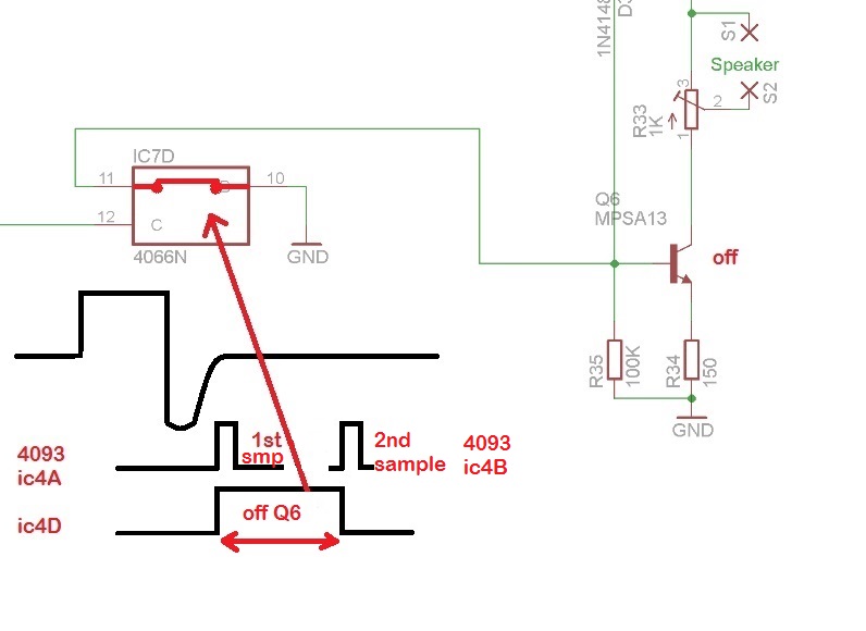

                    • Control output sound transistor???Click image for larger version
                          Control output sound transistor???[ATTACH]41325[/ATTACH]
                          Little hard to understand for me the audio. In the way i can explain, sample from ic4D 4093 closes the switch ic7d 4066, result audio transistor Q6 off. Aprox 100us off Q6, rest of signal (1450us-100us=1350us) on. Why? What we hear in the audio, not sample1 voltage change? What is cutting ic7d switch?

                            U7D switching is what creates the Audio Tone (frequency of audio is Same as Coil pulse frequency).
                            Then the LEVEL of the signal through D3 Modulates the Amplitude (loudness) of the Audio tone.
                            So when all is properly adjusted and metal come under the coil the Audio tone increases in volume.

                              I see U7D switch only put the base of transistor to ground, on and off. the signal from cd4093 is not going to transistor base.
                              edit: the audio signal that come through D3, from sample1 is cutted by U7D switch, result frequency of audio and voltage variation of sample1 give the amplitude. right?
                                You need to LOOK at the Whole schematic.
                                U7D is switched at the SAME Rate as the 4093 (switched Once per Pulse/sample cycle).
                                The LEVEL of the signal through D3 ALSO goes to the base of Q6.
