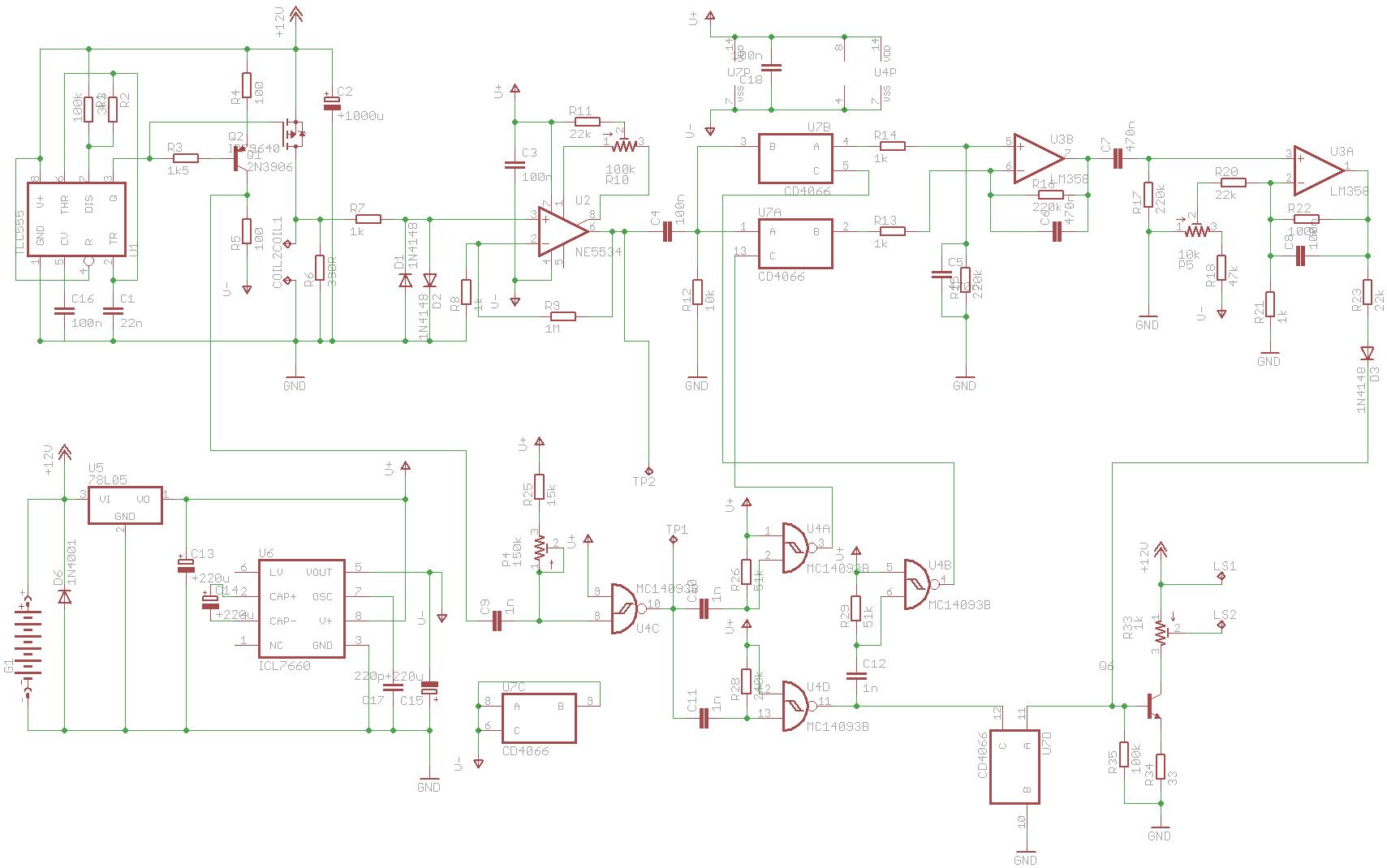

Whites Surf PI schematic
  • Just use the Schematic Silverdog shows on his webstore. Click image for larger version

    • any gerber or .LAY file of this ? thanks for help
      Just use the Schematic Silverdog shows on his webstore. [ATTACH]39857[/ATTACH][ATTACH]39858[/ATTACH]
      • Not Sure. Maybe way back in the start. Look in the Projects board under same.

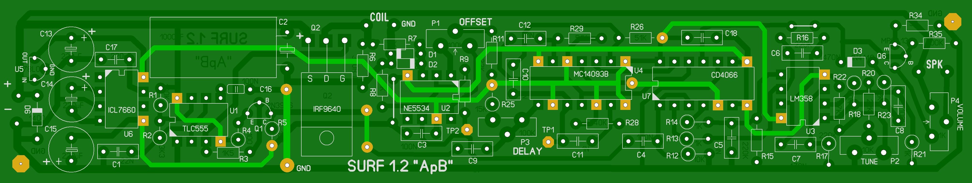

            • SURF XX (3).rar
              i tried manytimes on PCBWAY but always errors about PCB outline or Drill hole format.
              anyone knows about how to make PCB outline for this surf pi ?

                          • Originally posted by seriall714 View Post
                            [ATTACH]39870[/ATTACH]
                            this pcb is always error find the others pcb
                            • Originally posted by paku View Post
                              I can do this board at home and I can not see any errors in it!
                              If anyone sees mistakes, please let them know.
