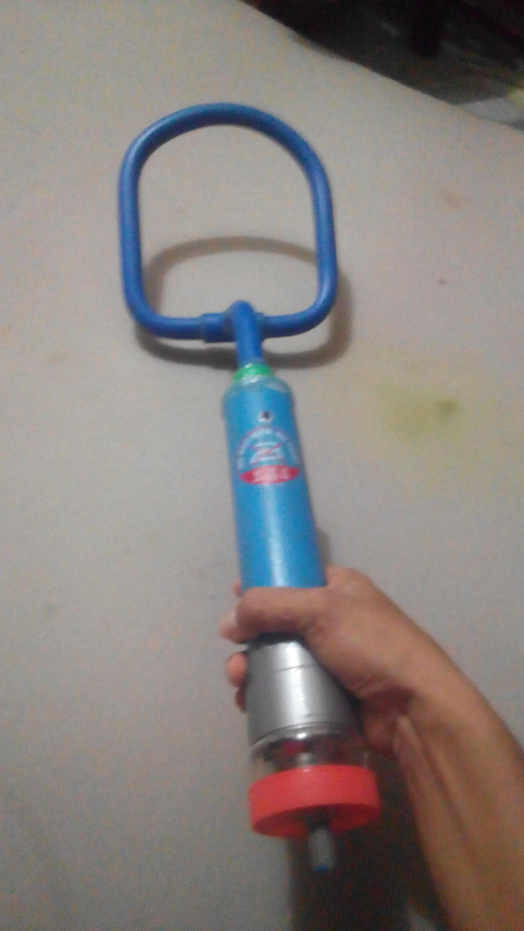

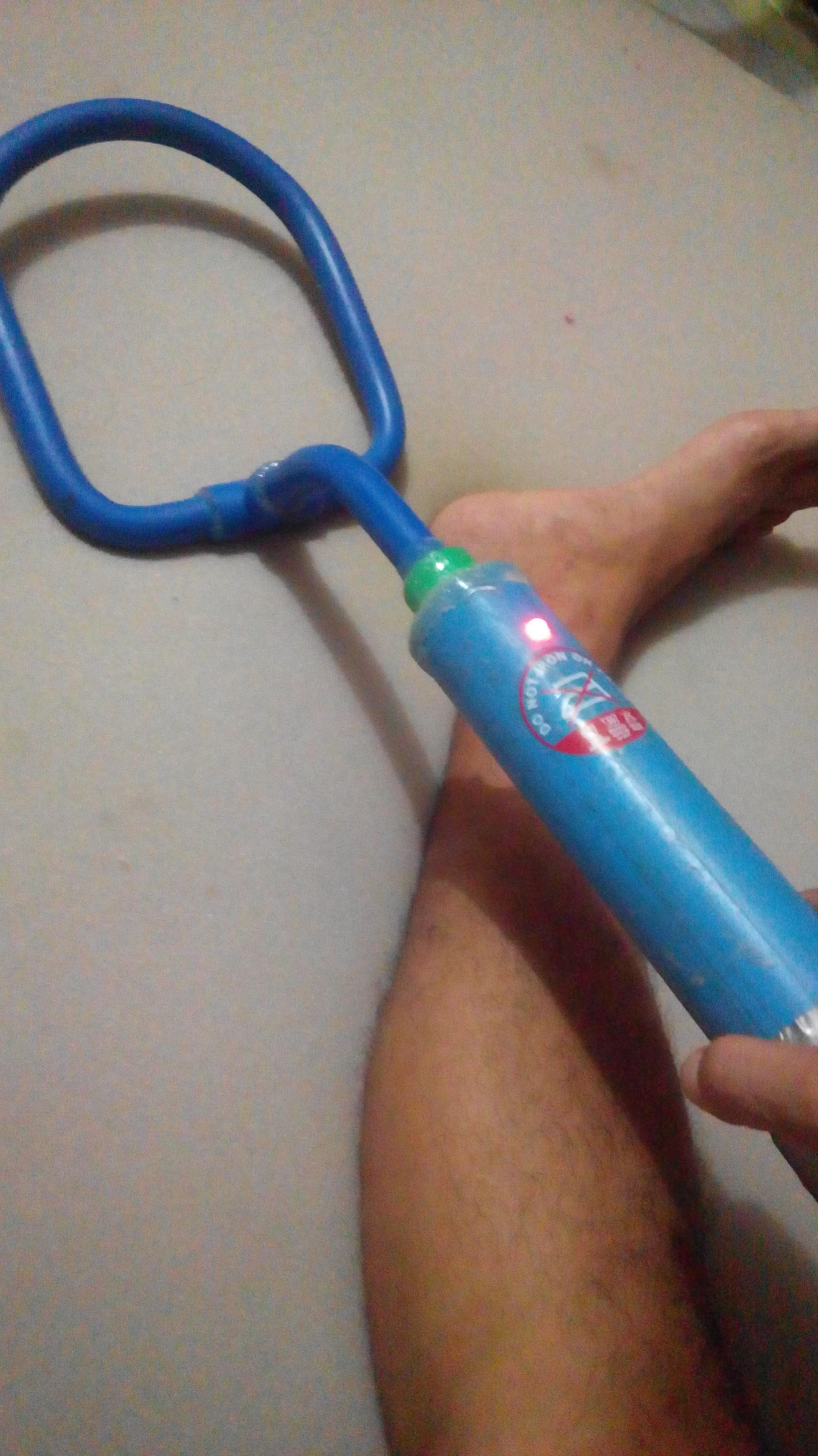

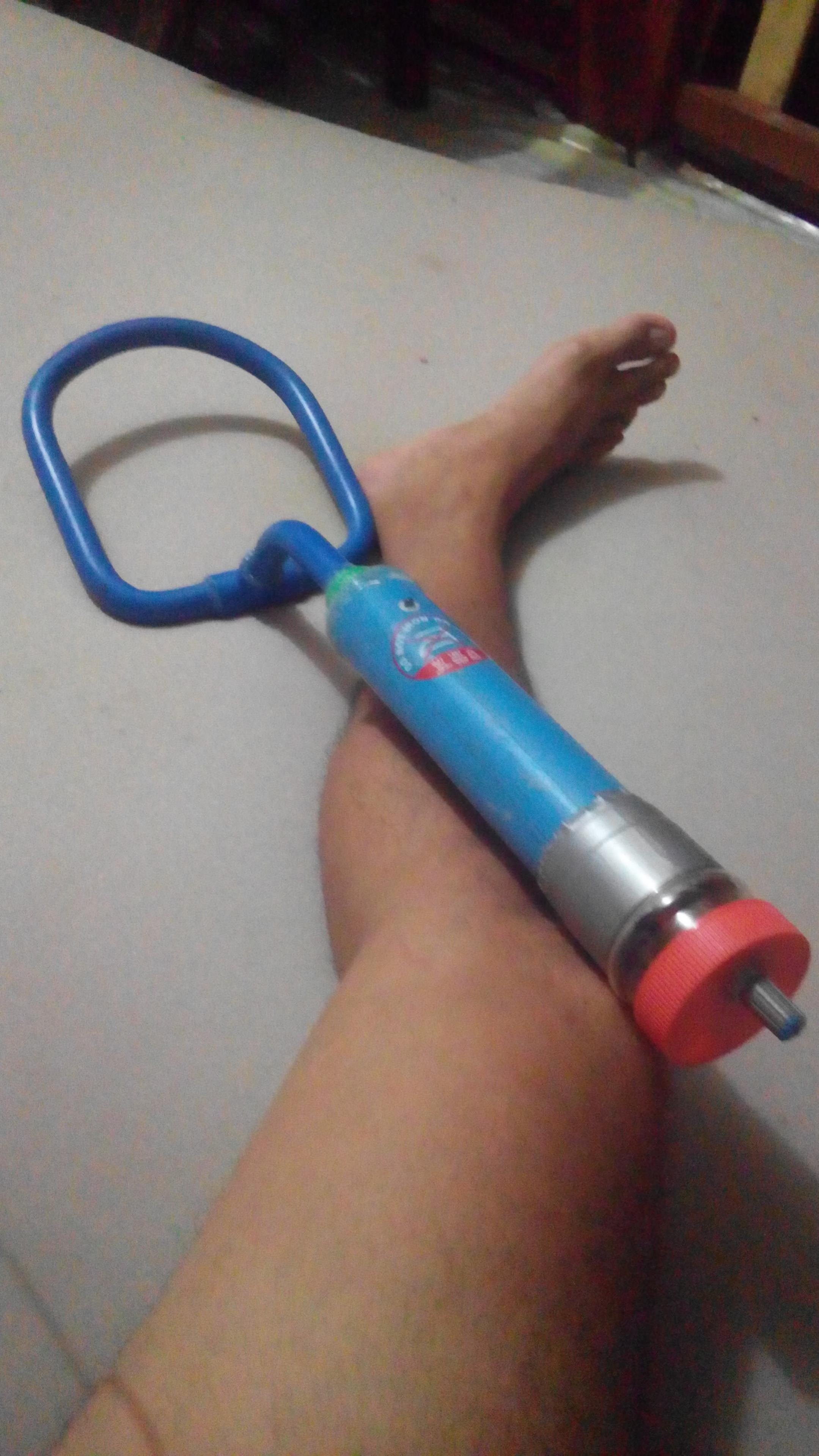

                              • Hello everyone,
                                Can you share lastest version Working TESTED surf pi (for underwater) ? i download 30files and almost everyone of them is different. i confused i want to make waterproof surf pi version for saltwater like scuba tector...
                                thanks.
