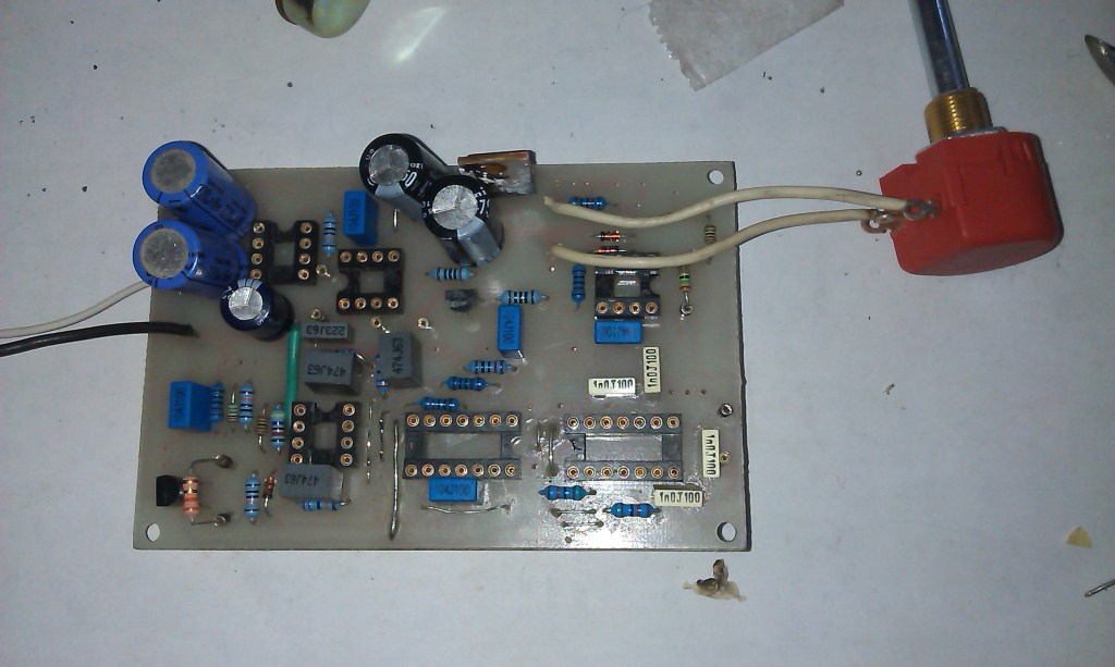

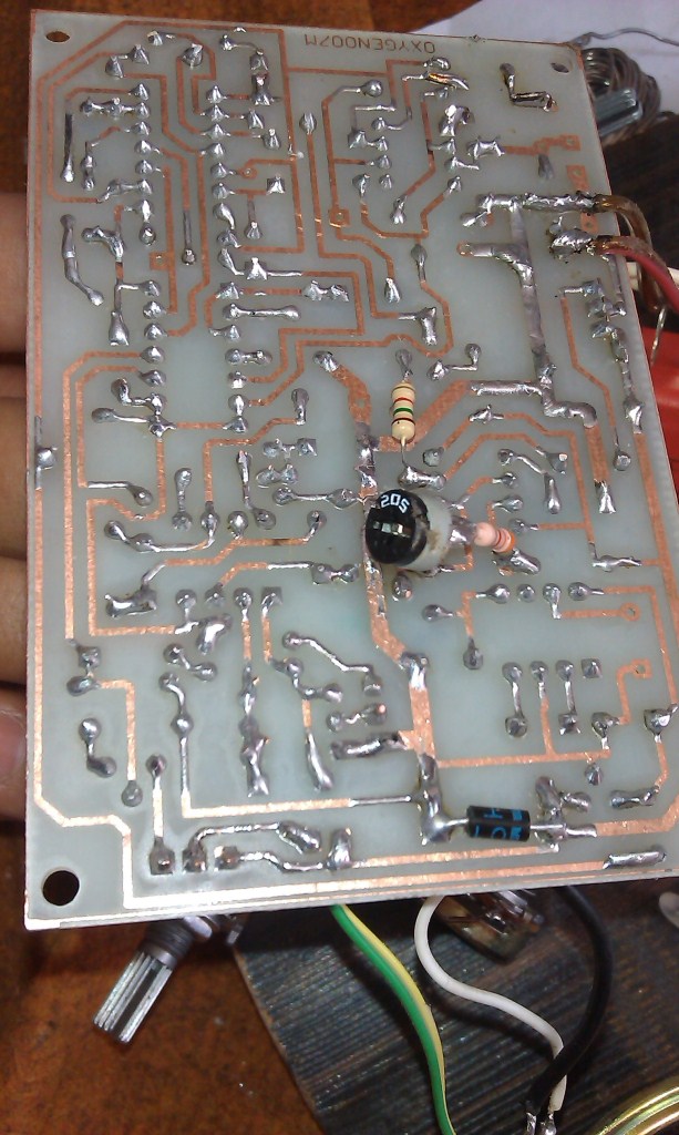

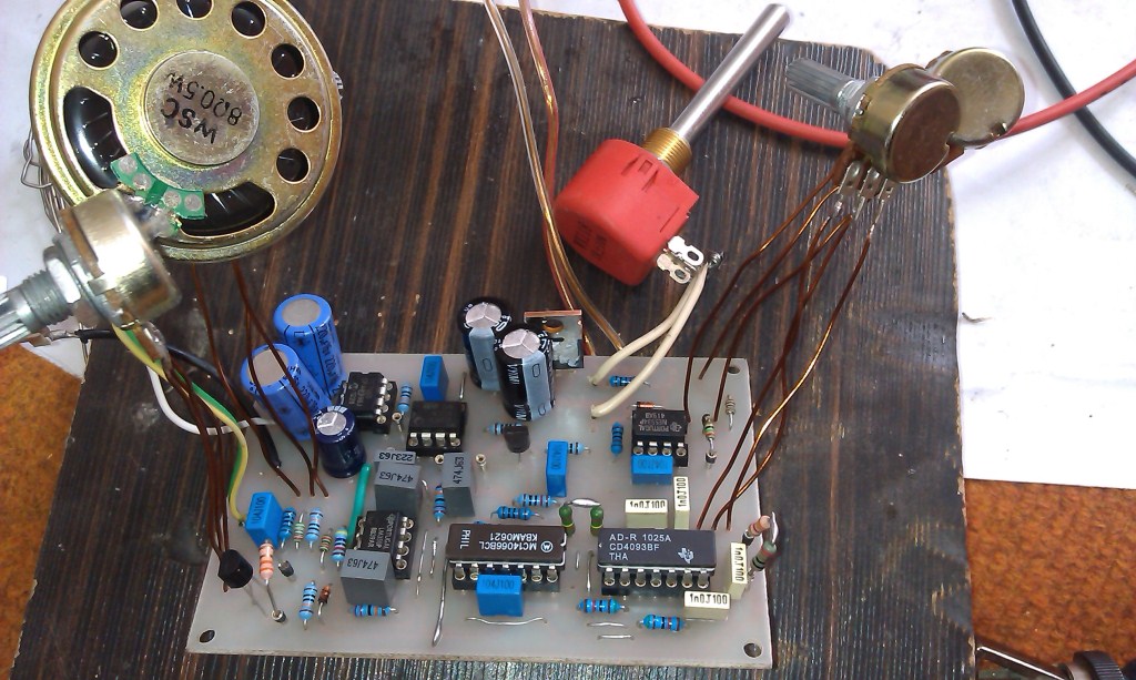

                      • Here is the one “Surfenstain” I built many years ago, with independent audio frequency adjustment and stronger audio output. I lost, or even never made schematic, manually routed, but board is 100% error free, just assemble as is. Tested fine at 10kHz, you can modify everything independently, this is original timing, just change components.

                              • q1 -4,37 v
                                My transistor q1 is giving -4.37 is this correct? any sound in speaker
