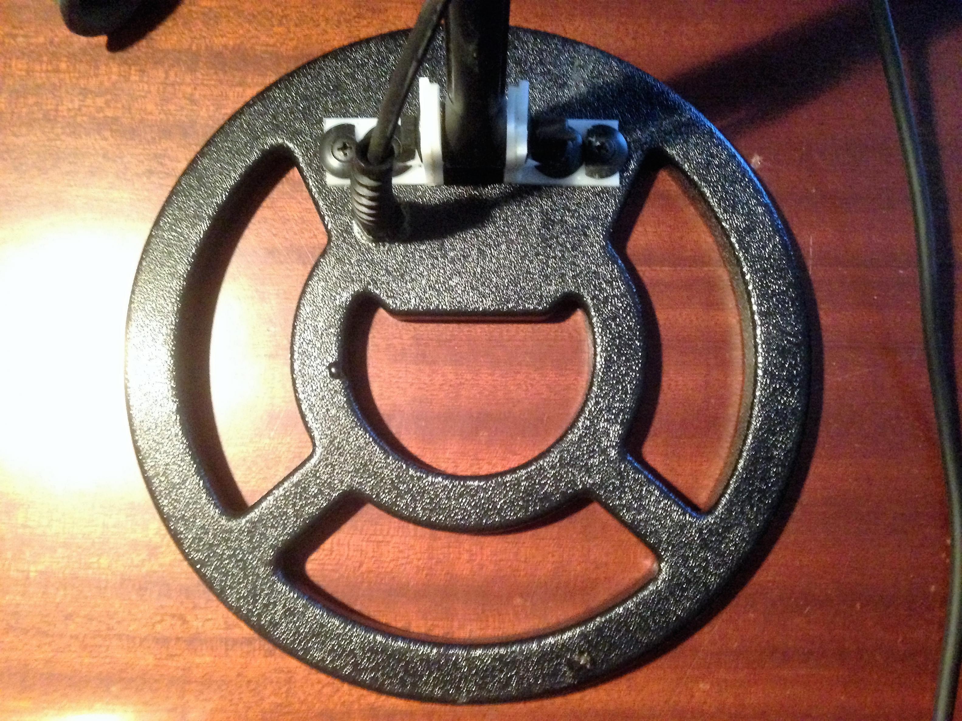

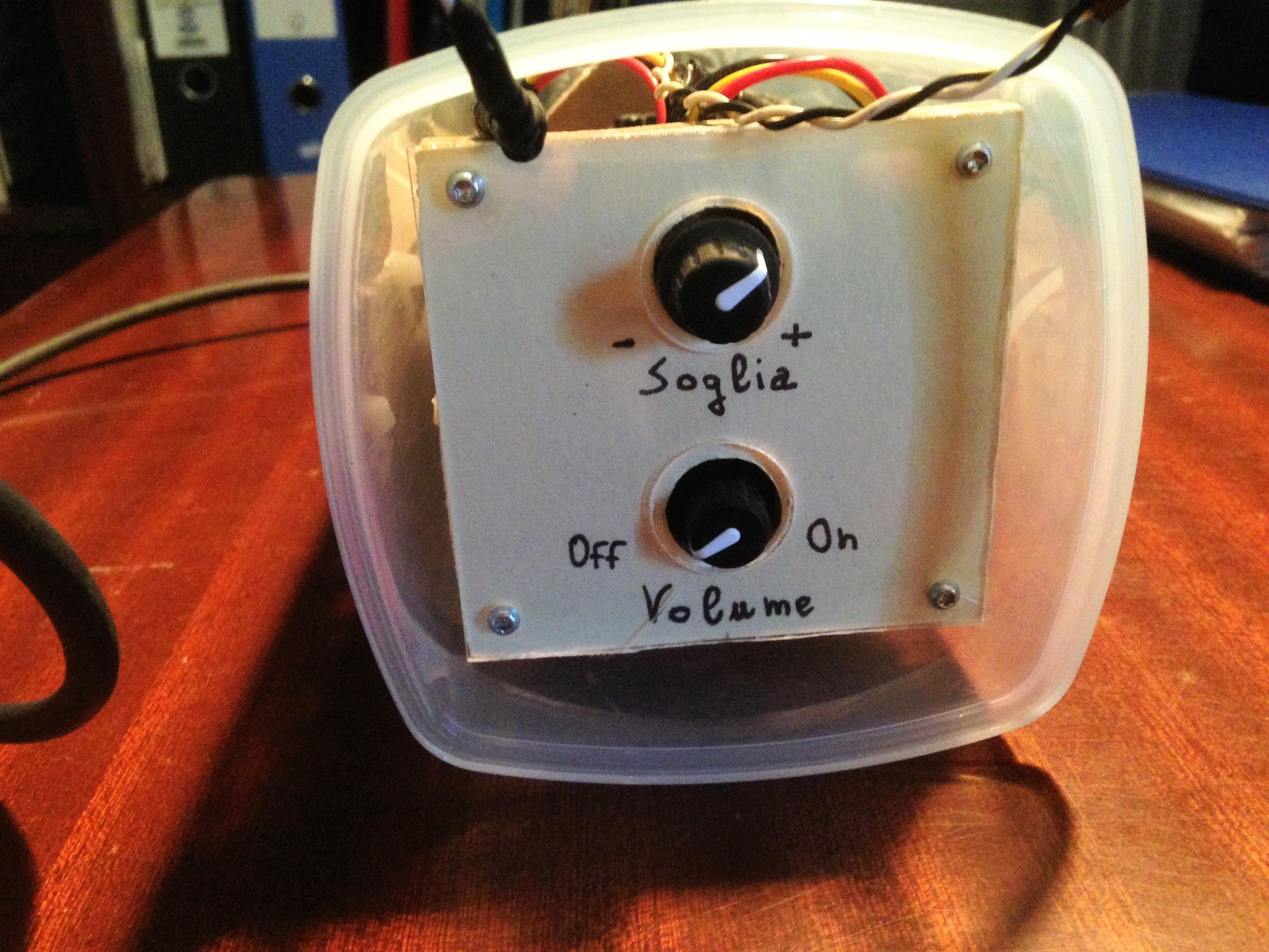

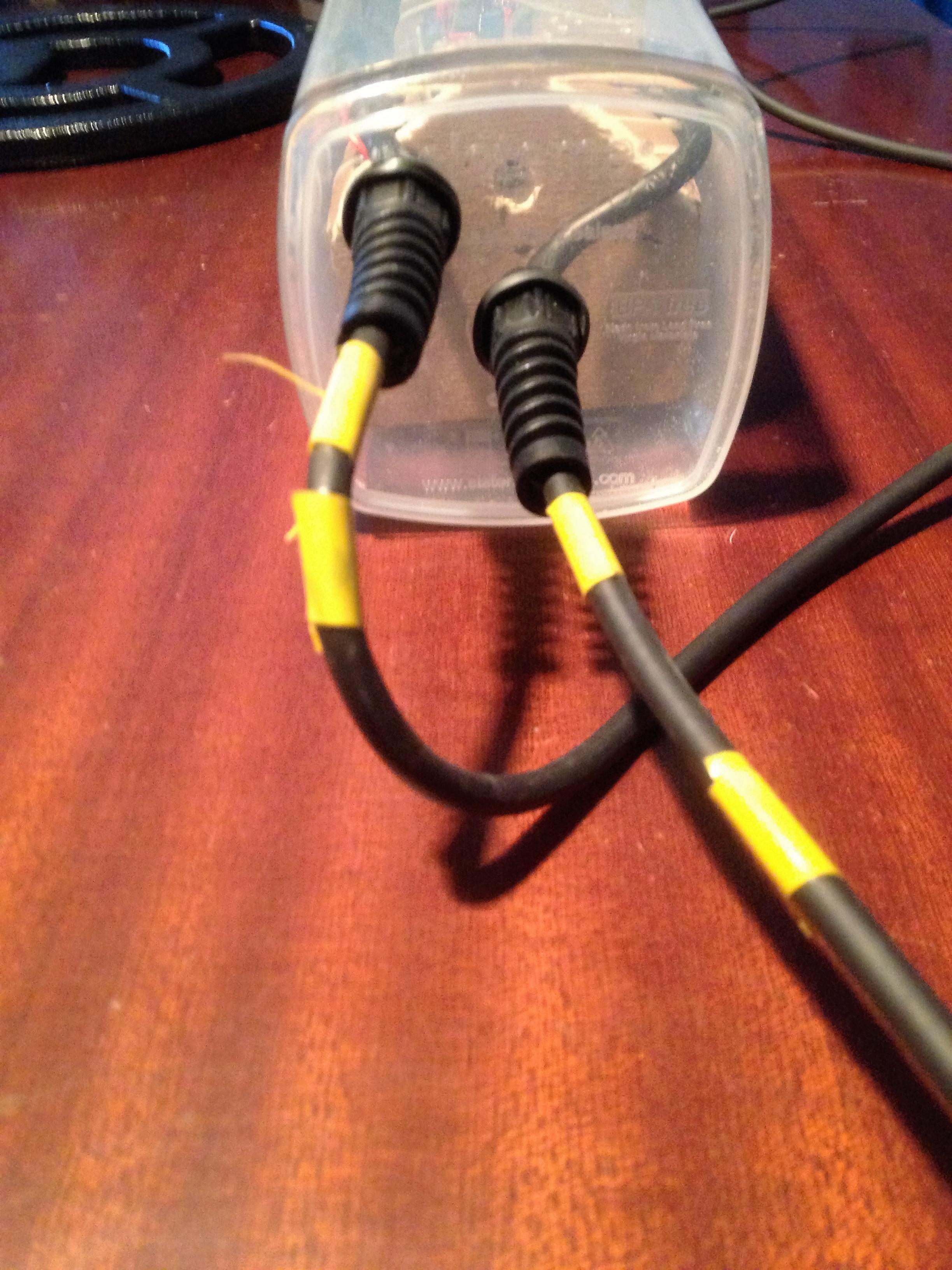

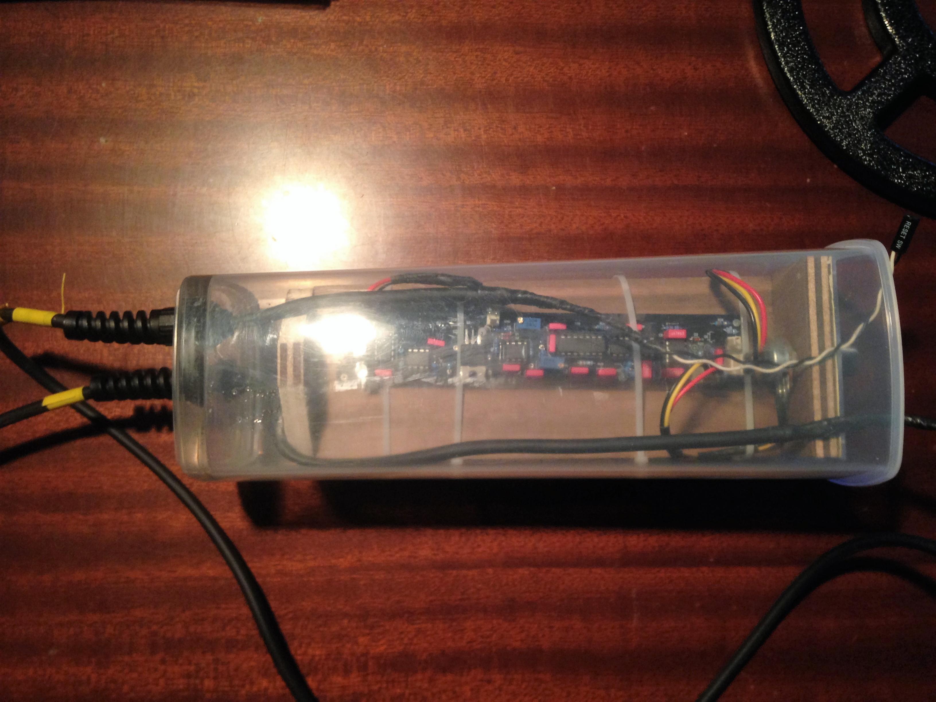

              • Hello guys. I almost finished my Surfmaster PI
                I want to know how to make headphones: I bought some anti-noise headphones and i think to use 2 passive buzzer (piezoelectric) connecting in parallel....It's possible for you? There are other alternatives?
                PS: excuse me for my bad english

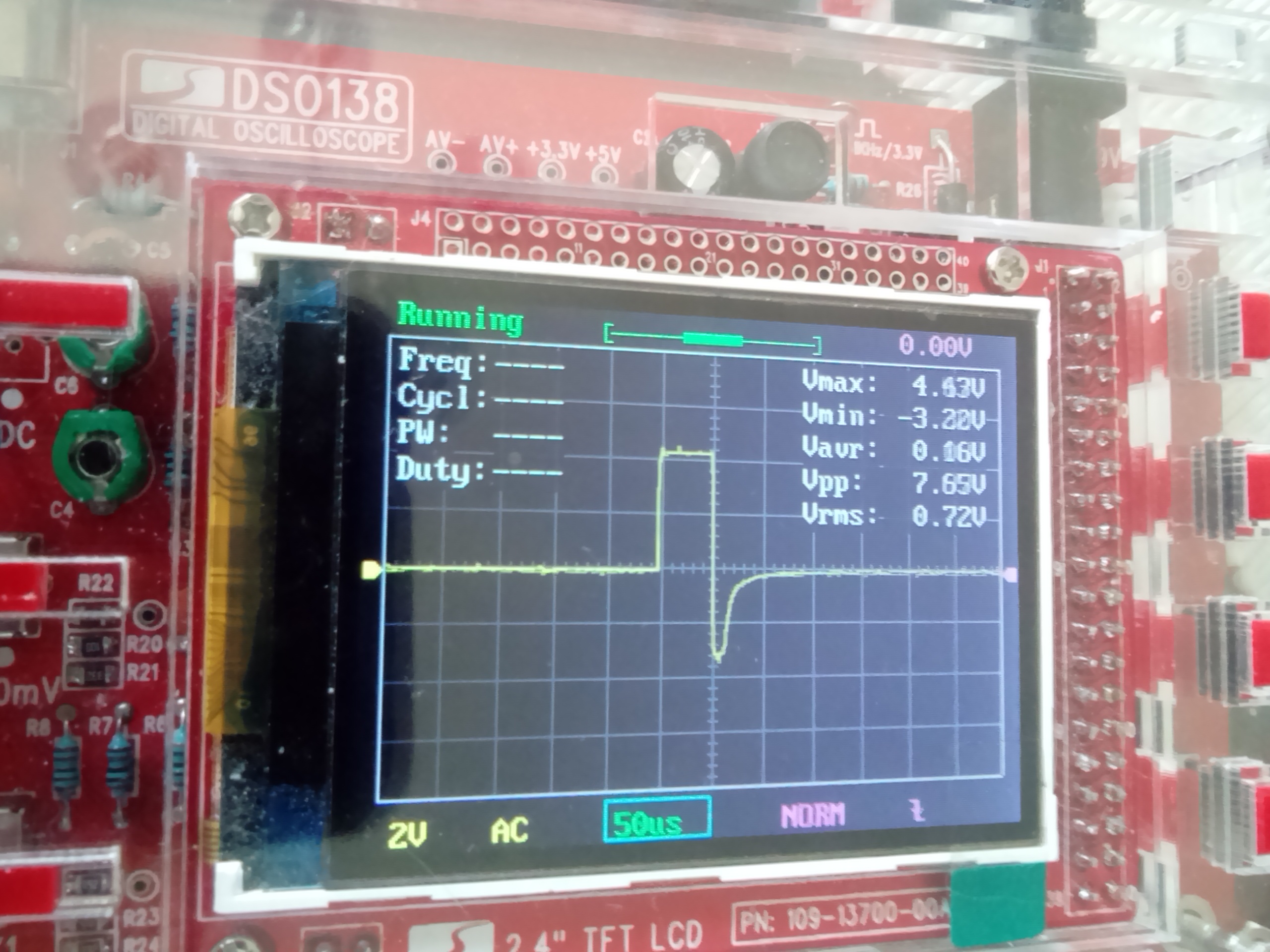

                • Has anyone tried to use a Cat5 cable for coil windings with Surf PI? If yes, what are the results?
                  On russian forums this type of coil is popular for good results and very easy to build. Instruction how to build: http://www.metdet.ru/korsina2.htm
                  Basically, it is an easy to do "basket coil" with low parasitic capacitance.
                  I've built the 9.5 inch coil and tested indoor, the results are not spectacular. I could only get about 15cm for a 50 cent euro coin. Maybe the coil is overdumped, I'll post the scope pics later.
                  • Someone did try with cat5 think it was on here but may have been a different forum. From memory results with cheap cable was very poor. With proper cable results were no better than using enamelled copper wire. Also the join was critical too much solder affected the performance.
                    • Thanks for the info.
                      I am using a high quality stranded cat5. As I have done it only for the proof of concept, I have left long ends on windings.
                      Coil cable is good quality RG85, overall (1,8m cable + coil) resistance is 2,2Ohm.
                      I'll redo it and post the results.
                      • here is the scope pic to the previous post.
                        the coil is now nice and tidy, but the results are still the same, low sensitivity. another thing is that the board is dead silent even in the heavy EMI environment with max Tune.
                        • Hi everyone,
                          tested some coils today, outside.
                          cat5 24cm diameter coil gave me 27cm stable on 1 euro coin, 1,9 Ohm winding, whole board consumption is 50mA.
                          copper wire 22 cm diameter coil gave me 25cm stable on 1 euro coin, 1,4 Ohm winding, whole board consumption is 62mA.
                          I used 150Ohm impedance headphones.
                          cat5 coil is actually looking good. Judging by the low consumption, there is still room for power. I'll experiment with damping.
