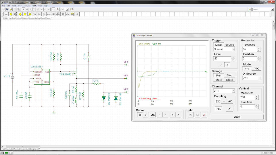

                        • Surf PI coil drive simulation
                          Here a Surf PI coil drive simulation file to use with the the free TINA-TI analog simulator found here:
                          http://focus.ti.com/docs/toolsw/fold...t/tina-ti.html
                          Use it to play with coil variables and damping resistors.
                          • The way I chose dumping resistor
                            To chose the proper dumping resistor, I use a (power) potentiometer and a series resistor for the minimum value (let’s say 150 ohm) instead of R6.
                            Put the probe of the oscilloscope (yes, an oscilloscope is needed…!) at the output of U2, pin 6 of NE5534, and gradually lower the potentiometer value until all the spikes disappear. See the image below.
                            Disconnect the potentiometer, measure his actual value and replace it with a fixed value power resistor.
                            That’s all.

                              • Originally posted by Noemio View Post
                                That’s all.
                                As a matter of fact, that's exactly what I'd planned to do to check the accuracy of TINA-TI. I'll be using a pot with a low value resistor in series.
