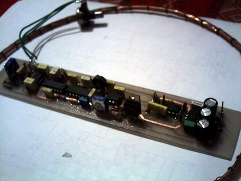

    surfmaster in the water resist box is not finish i don't know if it work and is downloaded in this forum opened in sprint layout.
    first surfmaster i post here, you see mounted, work very vell, is single face pcb aslo.

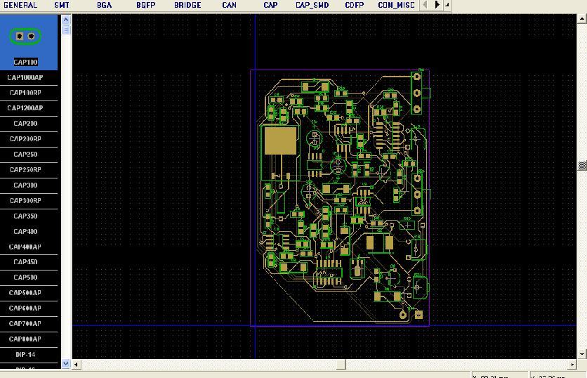

      Work in progress.....
      SMT PCB....

        Hello Nelson.
        Here is a version that has the mods. that are on the handwriting corrected circuit .
        I only have tested it indoors. Looks it is working good !
        The notes on the circuit are mixed , look at it.
        Regards.
        Ap
        I made this 5 days ago just for fun (havent anything more important to do).
        And guess what? I am thrilled with it! Wow! It is working EXCELLENT!
        With 21cm diamm mono coil it is detecting 1e coin at 26cm distance in air!!!! Wow!
        B R A V O ApBerg!!!
        Like always, old rule justified; the things taken not so seriously turns to be most beautifull things in life!
        This is so versatile design; it can be used as powerfull pinpointer packed in a small tube with small coil or as very serious PI detector with large coil!
        I am delited,amazed and thrilled with this!!! Best small PI so far!

          What do I use to open the "surf rev1.2.LAY" file ?
          • #65
            Hello Barry
            You can use a free viewer, look at
            http://www.abacom-online.de/uk/html/sprint-layout.html
            Sprint layout is a cheap, easy to learn, pcb program.
            Regards.
            Ap
            • #66
              Thanks Ap.
              I was hopping there would be a schematic in the .lay file but there is not. I am trying to draw it in proteus and the schematic in the pdf file is a bit hard to read some values.
              But the top mask in the lay file should help be sort that out.

                          ...this is it...works more than good!
                          Coil is 21cm in diamm.. wire 0.35, 24 windings... 1e coin detects at 26cm distance in air, loud and clear!!!
