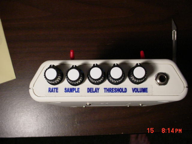

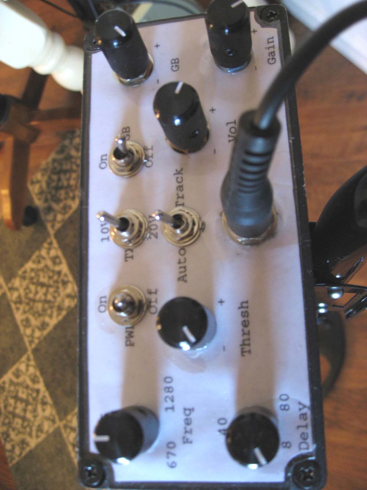

          Hello Nelson , I live in the United States , approximately 10 miles west of Las Vegas , a community called Summerlin , in Nevada which is in the "Desert" Southwest of USA......................Before I forget , here are photo's again of "Beautifull P.I. Machines" made by two Geotech-Forum members here , JoeCoin and JLKing , both are Hammerhead PI's , but notice they put the important potentiometers on the case , for easy access !!! We should do that here for this Surf PI !!!.......................Regards..........Eugene
          • #80
            Hi Eugene.
            Nice pictures . Yes i agree that when you make a metal detector, is very important that you keep access to all important controls of every machine.
            My sufmaster is under construction and i m planning to place the circuit inside of a PVC tube.
            If all goes good, i m planning to make more units in diferent cases. Experimenting is such fascinating thing i like to do.
            I don´t know Nevada, but i lived in Missisippi, Sacramento and Bethesda, Maryland in 1980 thru 1982.
            My english is not good by know, but i do the best i can.
            KIng regards
            Nelson

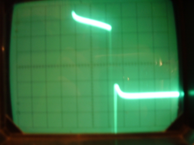

                      oscilloscope at coil

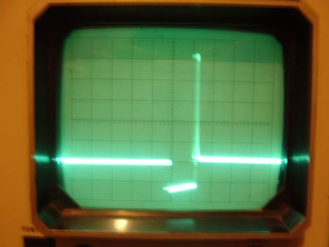

                      • #86
                        oscilloscope at pin 3 TLC555
