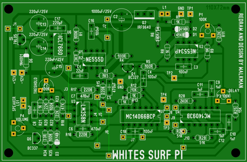

      • my pcb.
        Friends, Would you please check the error. Is this the latest updated version?
        • Looks reasonable, but one suggestion for bit more drawing: most resistors can be rearranged to 500mil raster, more natural and recommended, instead of 400mil, intended for 1\16W or smaller components, normal 1\4 or 1\8W size must be forced to fit, will try remake of this in Protel. Merely aesthetic rework.

            • Originally posted by walkman View Post
              my pcb.
              ok i think your pcb ok
              just please past your design here
              thanks

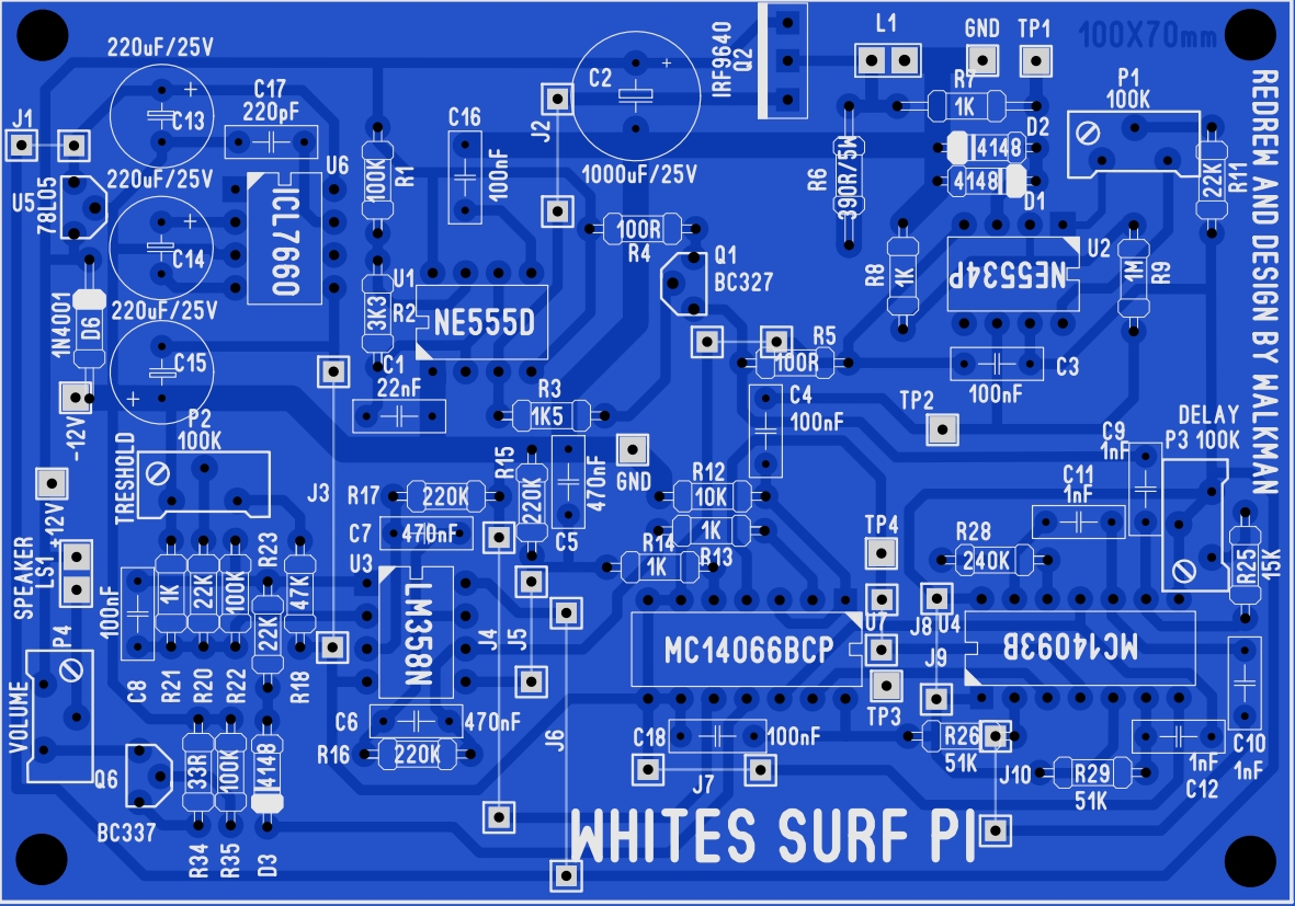

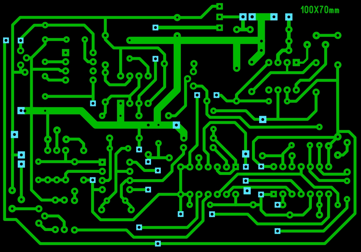

                      • layout board
                        hello walkman could send me the board layout
                        Thank you, Max3s

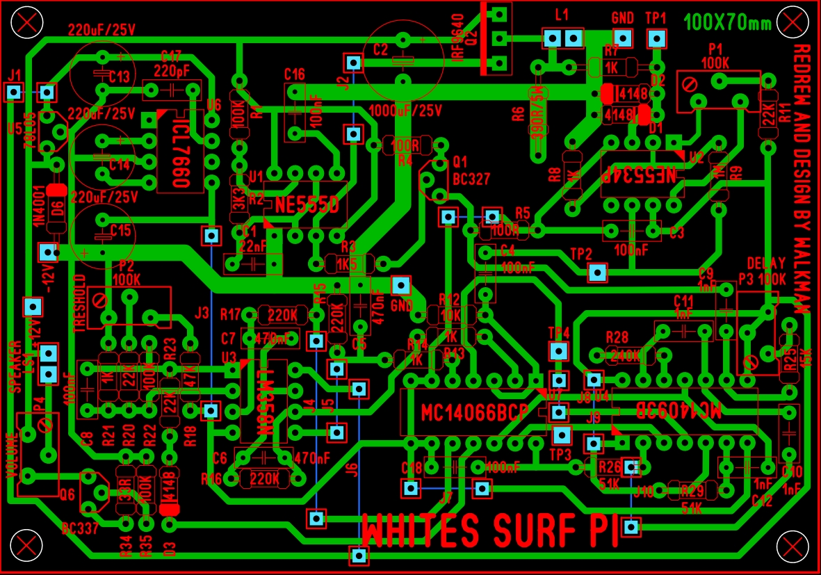

                        • Friends my drew surf pi
                              thank you

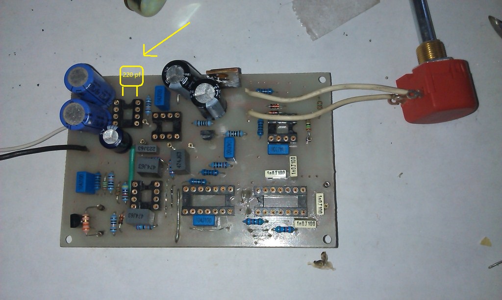

                              • Just an update on my odyssey toward a successful Surf PI build. Thanks to a couple of friends, IT IS A DONE DEAL! Yeah, second time around with the same board. In a previous incarnation best I could do was around 4-5" hooked up to a 5" copper shielded coil (folded over figure eight). Using the same coil and 5g 18k man's ring, I can now detect to around 10" or 25cms. The wiring has been simplified and it is very responsive and easy to calibrate. As per another thread, will probably replace the present delay to a 5K1 resistor with a EXTERNAL, Single Turn, 10K POT. Intend casing it for water hunting.
                                The increased depth seems to be related to a sweet spot on the delay. As I enter it, the steady "threshold hum changes to a pulse". If I'm outside that setting, the steady hum returns, which can be increased or cancelled through the Threshold trimpot. Is this normal? Hell, I'm not complaining over the increased depth!!!!
