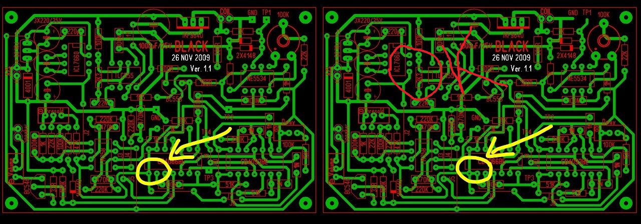

                • Hello all
                  Why the difference?
                  Error? or different configuration?

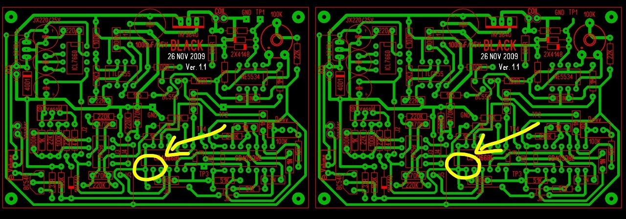

                  • Hello Hawk
                    • hello hawk this is the correct layout to use
                      • Do you have one in lay or pcb or bw format?
                        Thanks!
                        • Originally posted by maxm3s View Post
                          [ATTACH]27247[/ATTACH]
                          thanks maxm3s
