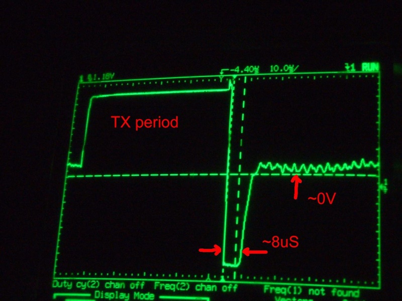

                            I have another question for all, what values surf pi mast have on TP, I asume that surf must have this on TP2
                            What is with others TP ?
