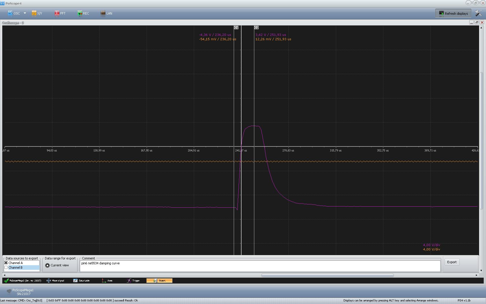

        • hello i measured pin 6 of NE 5534 (Testpoint 2) first test for my new poscope mega1+
          and just want to know if that what i can see is good or not
          i suppose it is the pulse and the falling side says damping resistor is nearly ok?
          right? thx

                        can anybody say wether the curve posted above is ok
                        • Hi Bernte,
                          There are a few posts on here that show curves similar to yours I think (i may have posted a few myself). Have a look and compare yours to those.
                          It's been a while since i looked at a PI curve!
                          Regards, Jim.

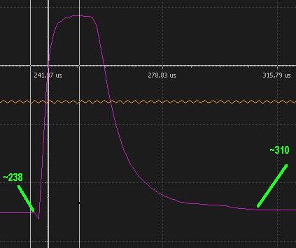

                            That damping resistor might be OK for the coil but the flyback looks like ~70us duration to settle (310us-238us).
                            Did you have the coil resting near something metallic?
