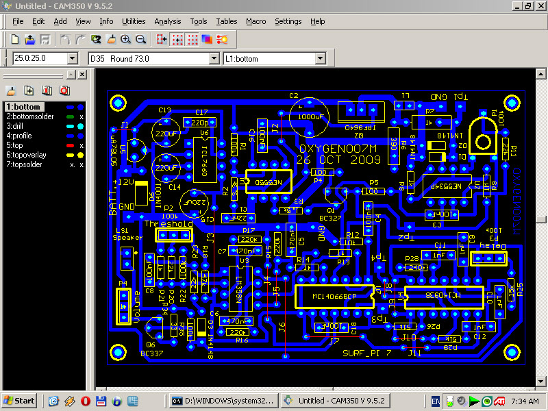

  • Just use winrar or winzip to unpack the gerber file
    Use a gerber viewer like cam350 and then you have pcb file
    with exact details and dimensions .
    • forgiveness for the translation of google, I'm Spanish.
      . zip file if I open it.
      files inside no, that program needed?
      • Gerber file is a universal Ecad format ,it means you don't need any spacial
        cad to use it .
        A view of gerber file opened by cam350 .
        As you see it includes all layers you want to print .

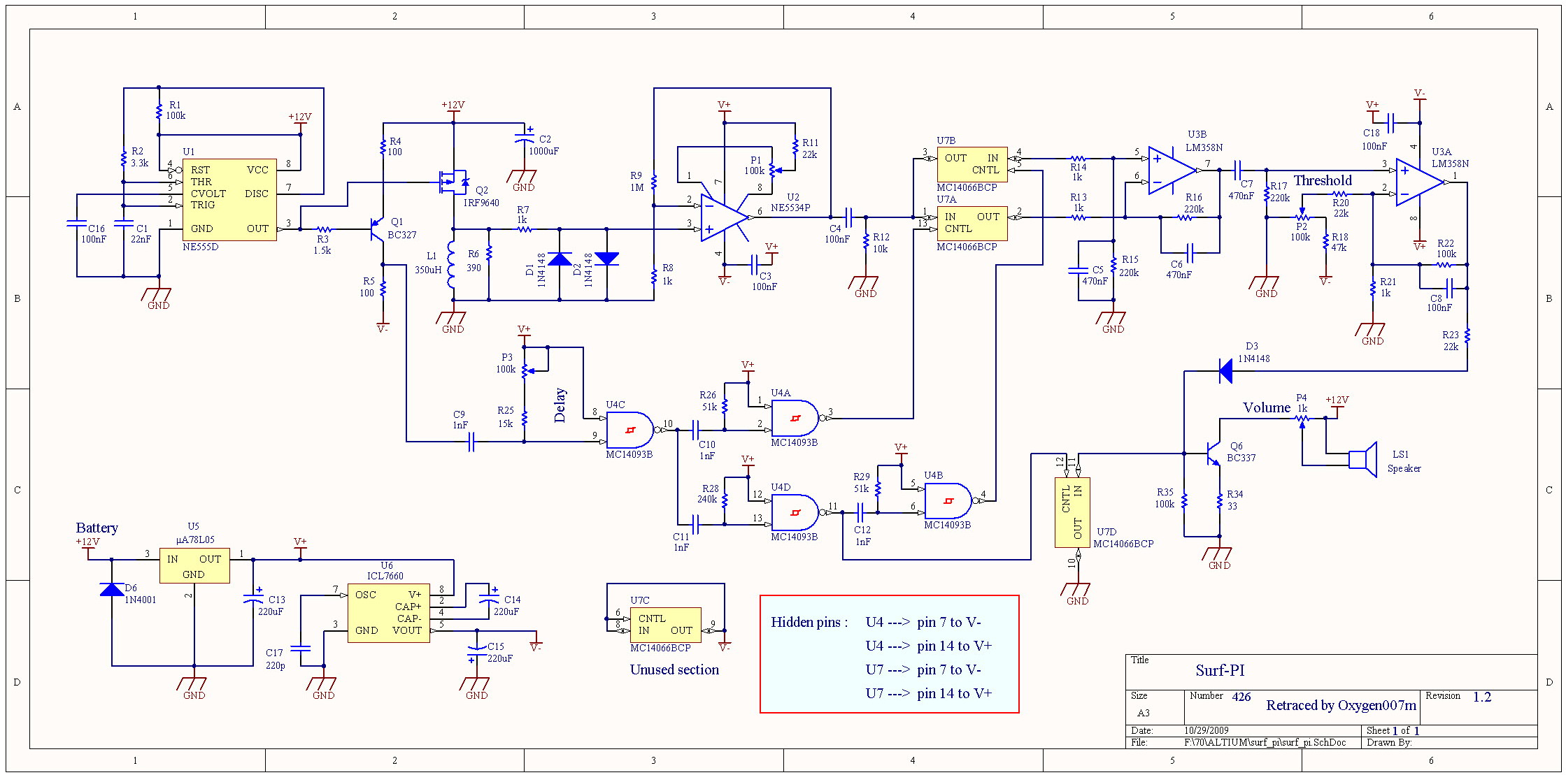

            It is just a retrace of original schematic with some minor changes of parts
            being used and therefore the results of operating tests will be the same as
            original one .
            • I think there might be an error in the retrace?
              Hi oxygen007m, exellent retrace and also a good design for a single sided PCB for surf 1.2, just what i have been looking for.
              I think however there is a small eror in the circuit. The control pin 5 and out pin 4 om U/B seems to be crossed?
              Tormod
              • Originally posted by Tormod View Post
                As I said before there is not any problem with the schematic or pcb .
                • With a great apologize for a small error found by dear Tormod
                  and a great thanks to him for precise attention to schematic .
                  The error was true and I was wrong . However I fixed
                  them and now we can claim that the circuit is ready to build .

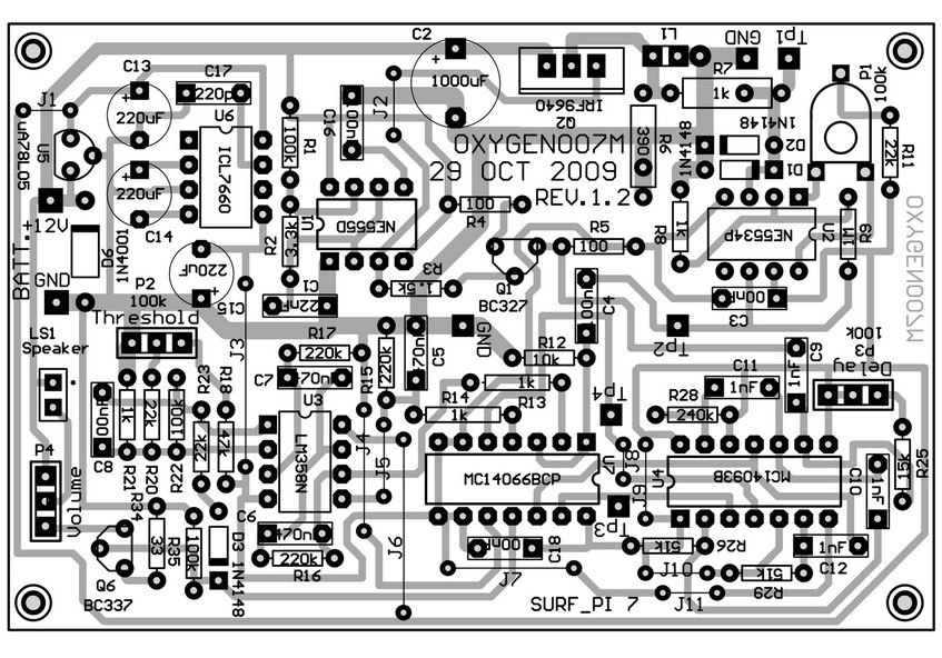

                  • The fixed PCB :
                    I also attached the final printout of all layers you need to have .
                    oxygen007m
                    • Oxygen007m, Tormod, I don't understand what the error was. Sorry, but I can't figure out what is meant by "om U/B".
                      I've looked but cannot find any difference between the "repaired" schematic or PCB layout and the originals. Were the crossed signals in the schematic, the PCB, or BOTH?? Would somebody please circle the change so that it stands out and does not get lost?
                      By the way, good work on the board layout. Thanks!
                      Cam350 sure looks useful and interesting.
                      • Hi.
                        U/B is a misprint, should be U7B, pins 4 and 5 where crossed, explained that in a PM to oxygen007m, and he corrected both the schematic and the PCB.
                        Tormod
                        • Thanks, Tormod. I see it now. It was very observant of you to find that.
                          The Surf PI looks like an excellent project - especially considering the low parts count.

                            • Hola oxigen007m puede usted poner el pcb en espejo en el formato pdf pues deseo imprimir el circuito mediante la tecnica de laser toner.
                              Desde ya, muchas gracias
                              Carlos
                              Hello oxigen007m can you put the pcb in mirror in pdf format because I want to print the circuit using the technique of laser toner.
                              Of course, thank you very much
                              Carlos
                              • comprueba que te valga, un saludo.
