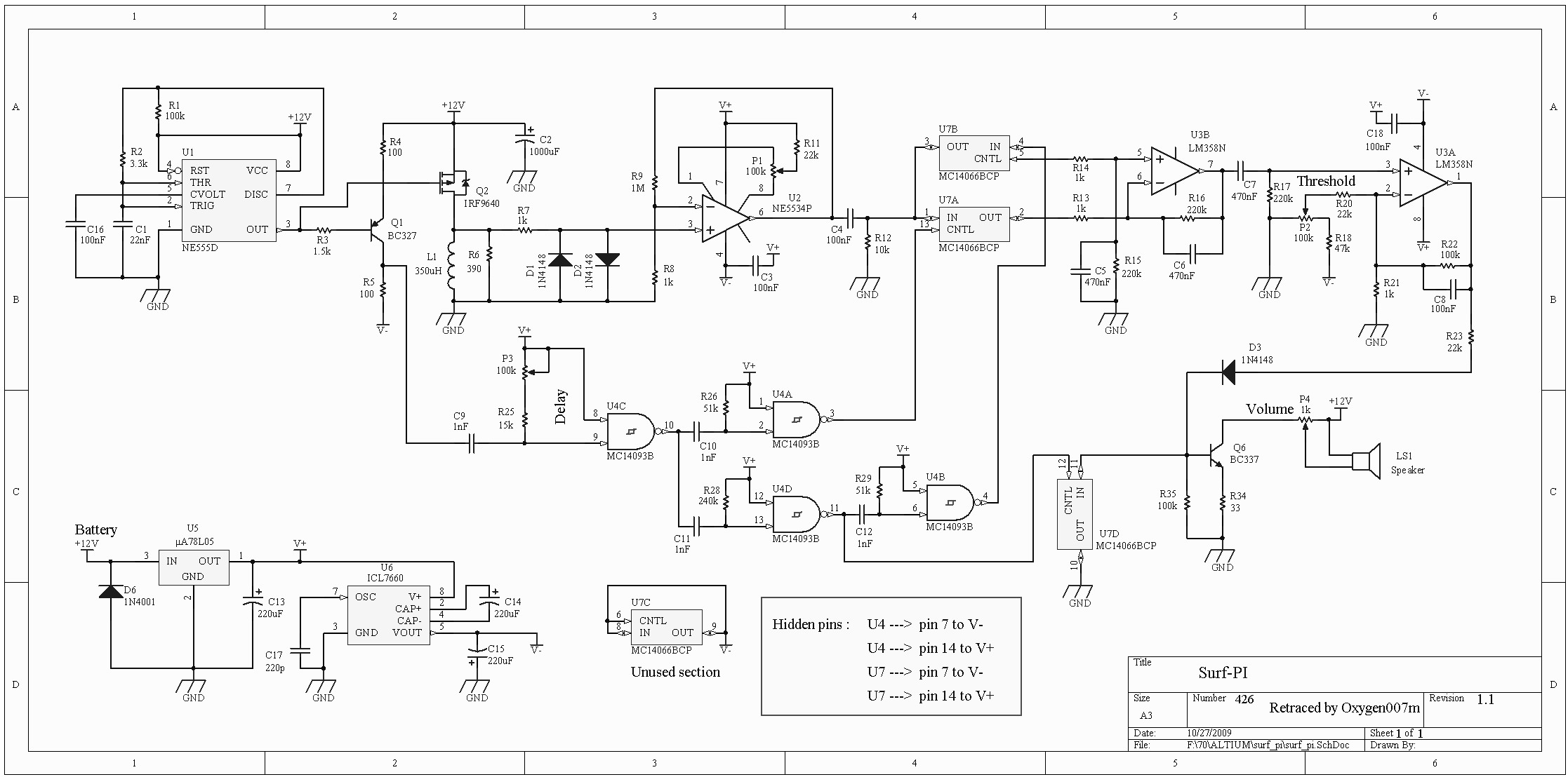

Whites Surf PI schematic

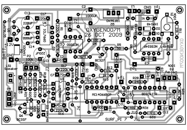

  • Hi, does anyone have the surmasted in sprint layout file for one side pcb, cause i cant find it on the forum.

    • Hi. Not sure wich one you're looking for, I've found this one in the russian site mentioned at the beginning of the post...
      http://www.md4u.ru/forum/download.php?id=1688
      I attach it here as well just for future availability

          • Thanks a lot Stefano. I think this is the 3er version on sprint layout file.

            • long time ago, I built the files posted by Stefano but does not work . I do not know if I have wrong in the assembly.
              The project is very interesting, the PCB is very small, someone could build it, maybe I missed the assembly.

                  • how to calibrate this machine did someone know?

                      power on the MD, with search coil connected, run the R10 100K trimmer to measure at pin 6 (output) of NE5534 zero Volt.

                          • Hi . A better retrace of surf pi schematic with altium by me .
                            I also replaced old 2N3906 with BC327 and audio output transistor with
                            BC337 which is more available on the market .
                            • For those who interested in single layer pcb , I also have attached the
                              gerber file . There is not any error with pcb , so use it with confidence .
                              enjoy boys
