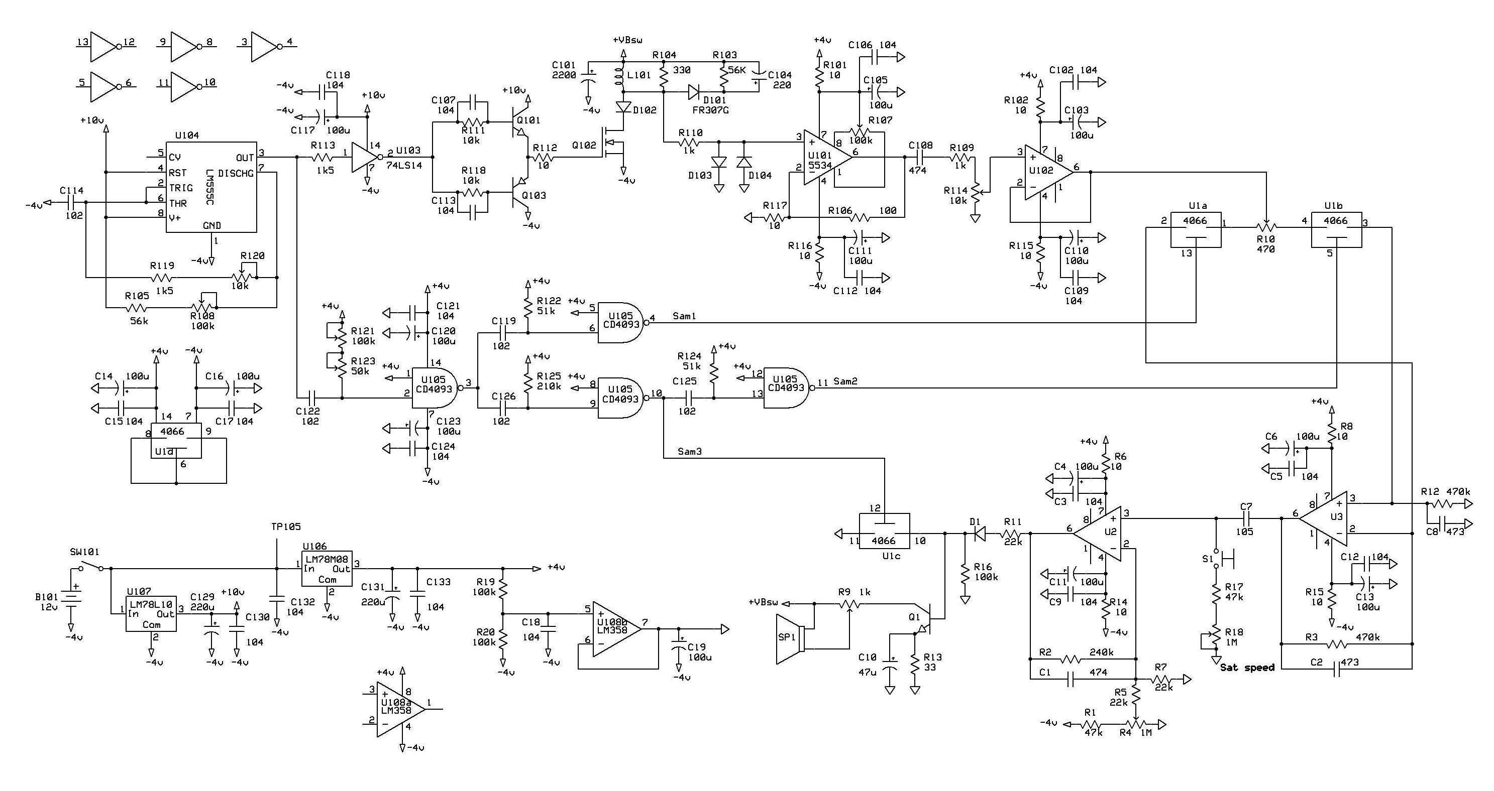

Whites Surf PI schematic
  • different surf pi
    it seems as surf pi but only power supply is different. Does it work according to you?
    • Originally posted by ashkelon View Post
      Thanks but this one is modified. I has changes to at least the power supply and the transmit driver circuit.
      • Originally posted by FatBob View Post
        Here's a Schematic I drew in Express for Old Cart and others to be able to edit;
        Thank you. I don't have an (un) zipper here so I will look at it later. Did you draw this from scratch?

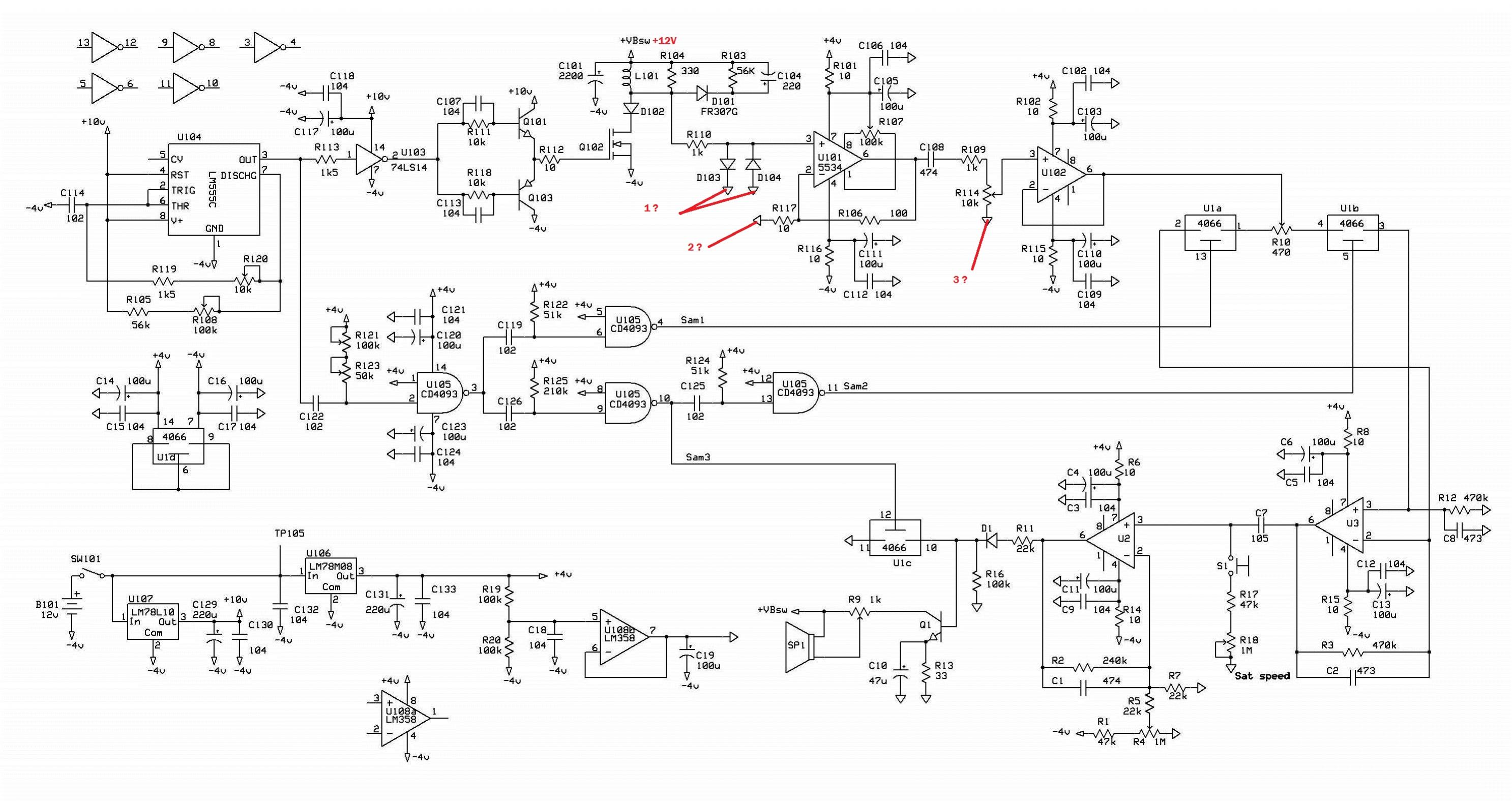

          • Can you please write the voltage values 1-2-3 numbered at picture ?
              Relative to ground the voltage is 0. Relative to the minus side of the battery it is plus 4 volts. Just looking at the circuit it seems there may be many design problems. It may work but maybe not very well or very long.
              • i think so , U108B pin7 out 4V must connect these pins but R110 1K may burn

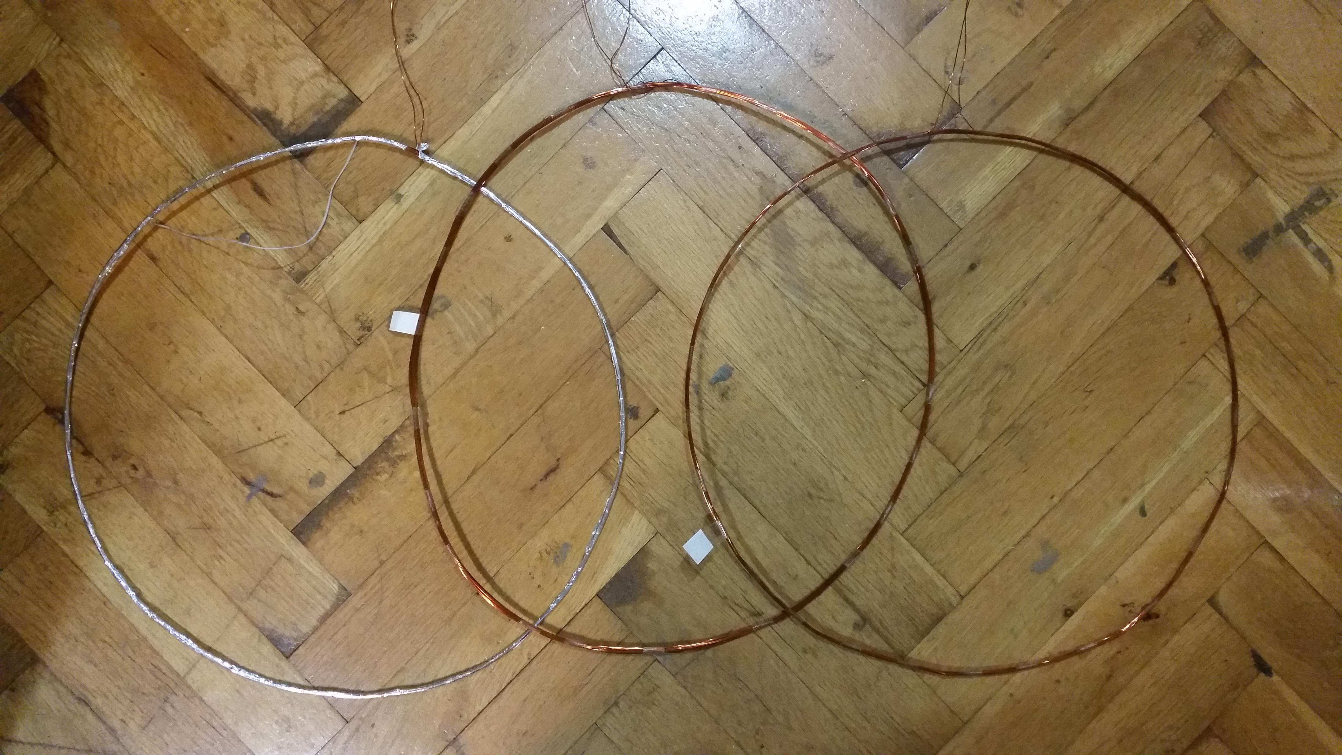

                • Originally posted by Tita View Post
                  i don't think that it's so thin.......it has about 7 mm
                  https://www.google.ro/search?q=gold+...HZc92fFThoM%3A
                  I don't have a 7mm chain to try. Any distance I give would be guess work. However it only see a target the size of one link so unless it has a large clasp it want be a large distance.
                  Adjusting the delay for gold does have a negative affect on other targets

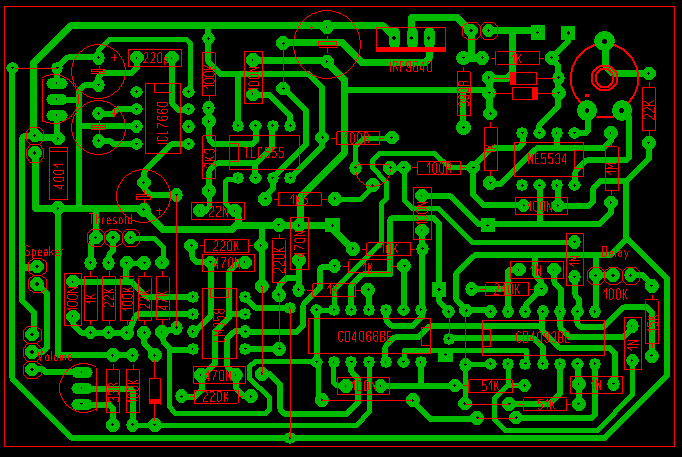

                  • Originally posted by Old cart View Post
                    Here you can download unzipped FatBob's Express (.sch format) schematic:
                    http://www.filedropper.com/surfpipro
                    Thanks both to your kindness!
                      it would have 16 volts/ 1.33K across i so 16mA so 144mW so I probably won't burn but it will get quite hot. This circuit seems to have problems. If you can I would avoid it.
                        yes it did not burn, i tryed quickly, there is no good output shape 5534 pin 6 for sample

                          Thank you WM6. This appears to be SURF PI PRO. That is not a bad thing but for my purposes I will modify. Let me take a look, Thanks so much FatBob

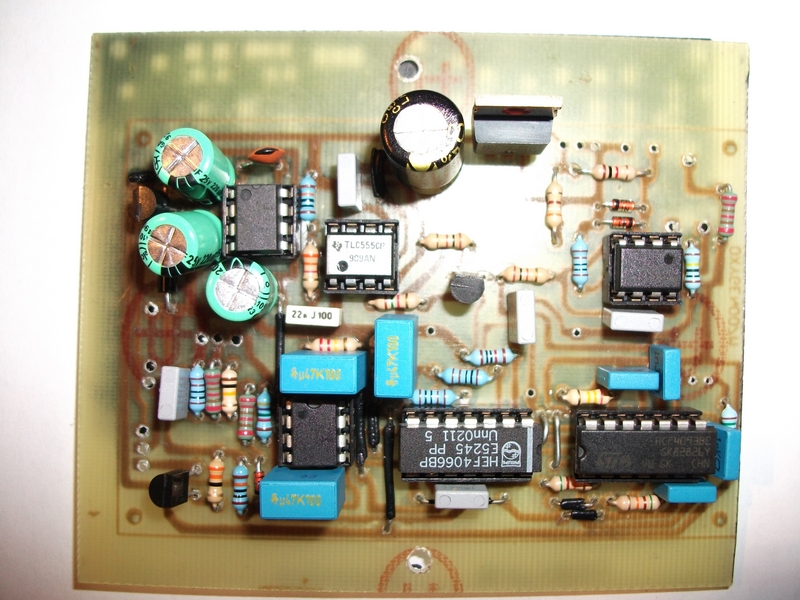

                          • my surf pi problem
                            0V line moving as flag when i shake coil, is every surf pi same ? there is no metal and electromagnetic field in here
                                https://youtu.be/1sTIqrEul_w
                                I do not recognize this board can you show the schematic?
