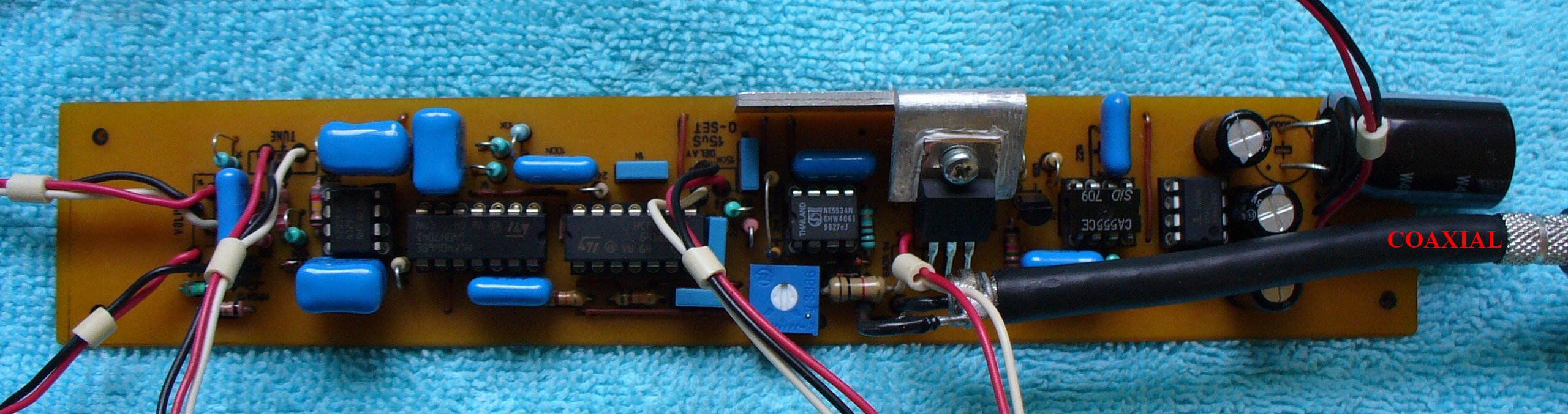

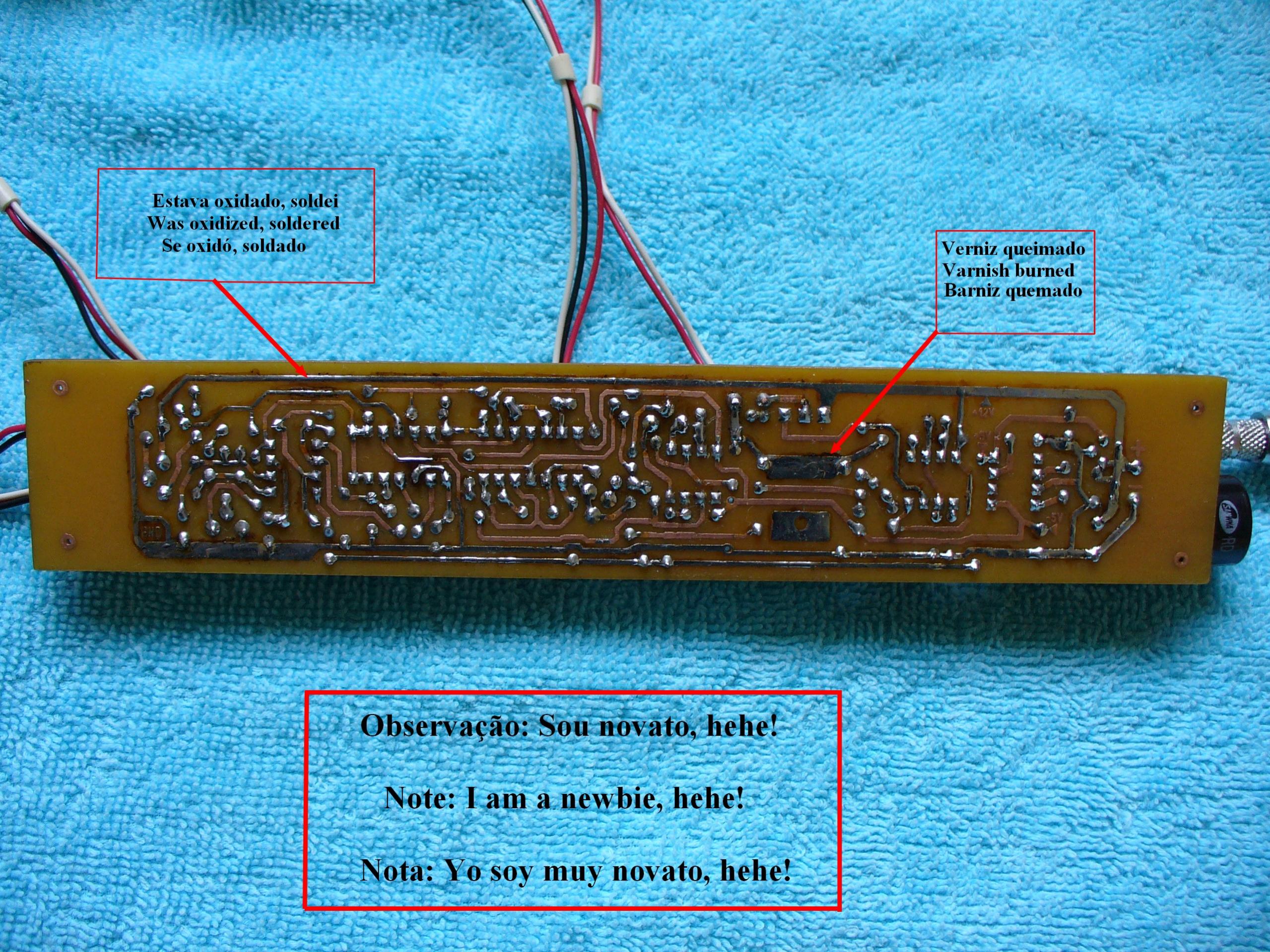

                • Hello everyone!
                  In my SurfMaster, is just a "biiiiiiiiip" continuous, with or without coil (18 turns, 0.6mm wire, 20cm diameter, 1 Ohm, I do not know the inductance);
                  When step inside a metal in coil the "biiiip" is stronger (as if detecting)
                  Adjusting Offset got - 0V on pin 6 of the NE5534
                  The tune does not work (the 10K potentiometer is working);
                  the delay hardly changes the sound (just a little more serious acute or more), only the volume works right, I'm using a Pieso.
                  The IRF9640 heats up a bit, depending on the settings of the potentiometers.
                  In ICL7660S - 8 pin + 5V and pin 5 to -4.45 V,
                  The voltage at pin 3 is CA555 + 9V
                  In 2N3906 between the collector and the GND is 12.75 V,
                  My PCB is the same as the link Download - (http://www.geotech1.com/forums/showt...hematic/page21) - post - 509
                  The measurements were made with a multimeter, indoors.
                  I need help, I do not know what to do.
                  Sorry the translation.

                          • Hi blizi.
                            My detector, does not work, just keep beeeeeeeeeep.Click image for larger version
ID:	336996Click image for larger version
                            more pictures in email.
