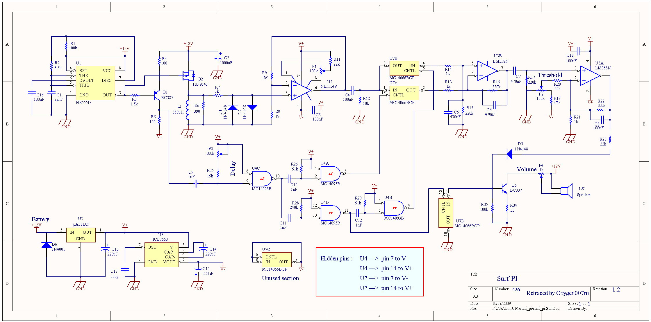

Whites Surf PI schematic
hello Ashkelon,
EARTH MAGNETIC FIELD is everywhere................ ( even inside house !! )
in your last video, that is most DEFINITELY earth magnetic field you are seeing.
going to guess your testing at the output of the pre-amp ??
this is normal.
magnetic field effect on the base line is REDUCED after the C4 / R12 filter.
it's the following stage ( 4066 sample switches and integrator that remove the earth field )
( hopefully....... )
Thanks Dooley, Must i replace the bigger value r12 = 20K c4 = 200N ?Originally posted by DOOLEY View Posthello Ashkelon,
this is normal.
hello Ashkelon,
NO.........
values of C4 / R12 are just fine,
experimented with changing the values in the past,
and,
although not TO critical, 10k and 100nf seen to work the best.
as I said, base line fluctuation at the pre-amp output is normal,
earth field removed by the next stage.
measure D.C level at the output of the op-amp on the next stage,
earth field, or small non metallic magnet should have NO ( or little ) effect.
however,
nearby interference may still be there.
indoor environments can be electrically quite noisy.
mains electric, fridge motors, florescent lights, battery clocks ( esp these !! dam you battery clocks !! ) LOL.

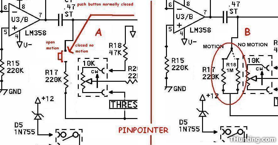

Yes it's a motion detector. I think there was a mod to fix that.Attached Files
