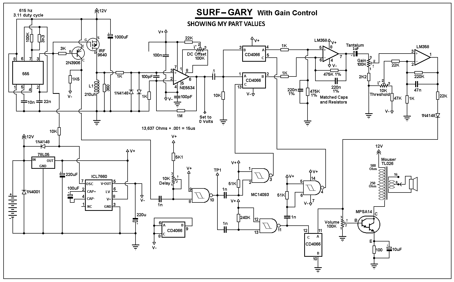

  • Originally posted by homefire View Post
    Easy Enough to do. Replace the Feedback Resistor 1M on NE5534 to a Pot.
    Not tried the Motion no Motion mod. It didn't keep the Threshold Tone going any longer ?
    Yes I Know it is Easy to add that Gain Control, but why don't they add it in their kits.
    Is it useful or not?
    • ??? Don't know. Save the cost of a Pot? LOL It's not like a VLF needing to Tune Down to handle Ground conditions I guess. The Surfs not the deepest of PI so no need to turn down to stop digging 2ft holes for fishing weights ? I have a untouched Silver Dog kit sitting here Idle. I'll put the Pot on just because I can.
      • you have to use shielded cable for the pot anotherway you get strong unstability.
        good luck
        • Yep, Amplifying tons of Noise on the wire.

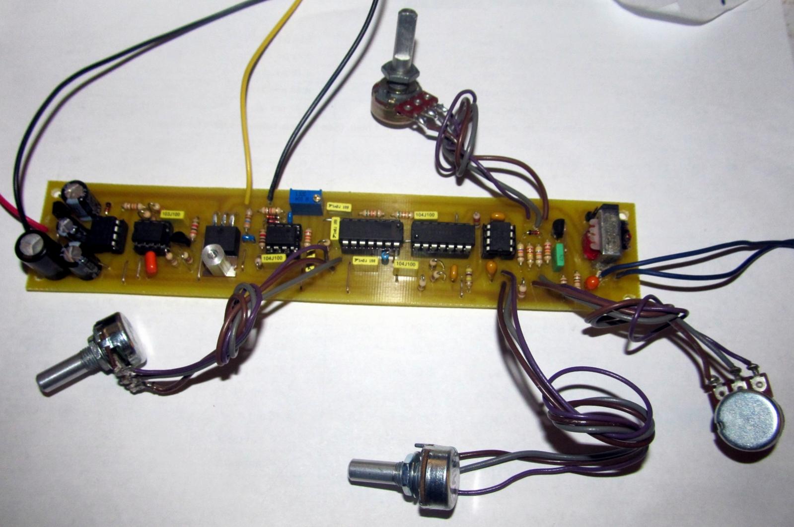

Name:	New Surf-2.jpg
            Being Curious, I added in the Gain Control, using No Shielded wire and it added No Noise Problems.
            I also found having the Gain control does seem to have some advantages in tuning this detector.
            My detector also has a Audio Transformer to better match to speaker impedance.
            • I be thinking the Noise would only be a issue in a Hight RFI or EMI location. No one seems to Remember that you have to Match Impeadance with Head Phones and Speakers any more. It makes a wHOOPING difference in not only in Volume but Tones and Sounds. Thank You.
Name:	SURF-GARY-Gain Control.png
ID:	347449 Here is my Schematic.
                • Originally posted by chemelec View Post
                  [ATTACH]38246[/ATTACH] Here is my Schematic.
                  seems we say about different things. in YOUR schematic the shielding of pot GAIN is not needed.
                  i mean FEEDBACK RESISTOR ON FRONT END.
                    Perhaps that is the best place to adjust gain since it is essentially DC at that point. Trying to adjust the first stage gain with a pot is difficult as just a few pF of capacitance can are a difference. Maybe crank the first stage gain down to 500 and increased the D.C. Gain by a favor of 4 and then make it adjustable.
                    As for the transformer some versions of Surf PI had this very transformer. Does it really improve the sound? Can you make a recording?
                    • It Definitely gives better and louder sound and will drive a loudspeaker, although headphones are still best to use.
                      As to the Gain control I added, it is the same as shown in the Original Surf Pro Schematic by White's Electronics Inc.
