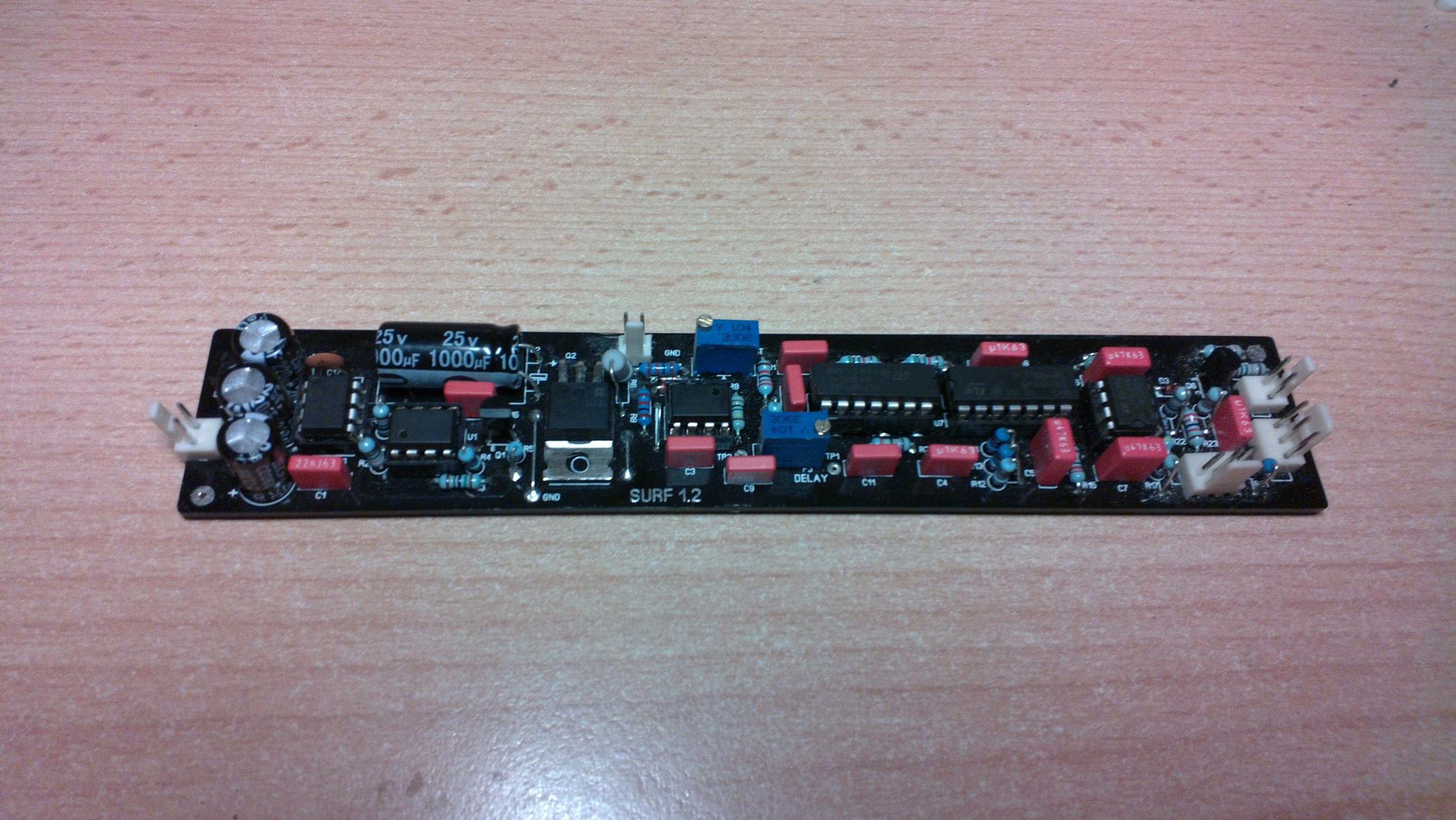

                    • Hello everyone,
                      i have read all posts in this thread, but still can't figure out whats wrong with my surf pro. The problem is that i get like few centimeters depth on pliers and everytime when i move my coil or its cable to any direction it makes sound response. Tried going outside where no metal objects or wireless or anything like that exists.
                      Surf 1.2 pi from Silverdog
                      Offset set to 0 volt.
                      Coil diameter 230mm
                      Turns 21
                      Enamel wire 0.5mm
                      Wire length 1586cm
                      Around 230uH inductance
                      1.37ohm
                      coil connected with coaxial cable
                      Detector responses to all pots and trimmers.
                      Maybe my soldered contacts overflowed? (see picture below, marked red where contacts ar soldered together)
                      And video showing how it all looks like. (metal clamp used temporarely, because i haven't glued cable yet, no difference without them)
                      http://www.youtube.com/watch?v=gPBan8I4pKY
                      I am sorry for my english and thank you for any suggestions what could be the problem.
                      • Metal clamp !?! You have lump of metal in the coil and expect this to work? Remove it and try again, your detector seems to work fine. You will notice different behavior of delay and threshold controls without metal clamp too.

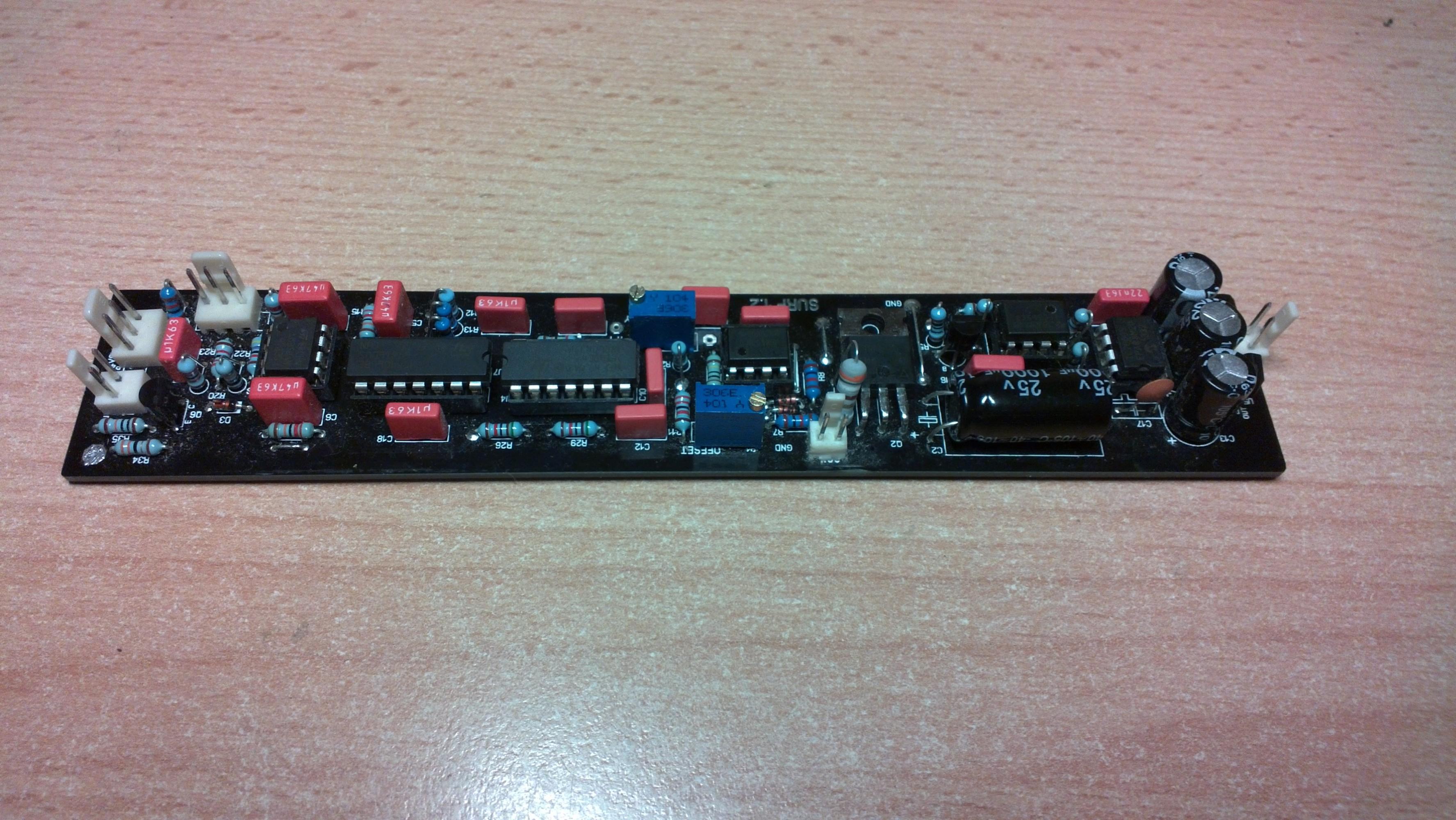

                        • "Maybe my soldered contacts overflowed? " the red circled areas are OK. how about the other side.
                          • Originally posted by Thomas View Post
                            Here you go,if they say anything
ID:	339362Click image for larger version
                            Tommorow ill try adjusting trimmers without metal clamp. Thank you

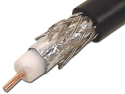

                            • I already attached my cable to coil so no metal clamp is used anymore, adjusted offset to 0 volt, but still the same result. Adjusting delay makes some difference, but nothing better. Still beeping everytime i move my coil or my cable and dont get any depth. Tried outside, where are no metal objects, wires or something like that.
                              Now i am wondering if my coaxial cable can be the problem. I am using cable as in this picture. It has a layer like foil... What cables do you guys use? USB? Click image for larger version
                              • Originally posted by Radvis View Post
                                Now i am wondering if my coaxial cable can be the problem. I am using cable as in this picture. It has a layer like foil... What cables do you guys use? USB? [ATTACH=CONFIG]28525[/ATTACH]
                                That cable should be fine, but try connecting the coil directly to the board using a short length of flex to eliminate the coax cable from the equation.
                                Also, what value of damping resistor are you using?
