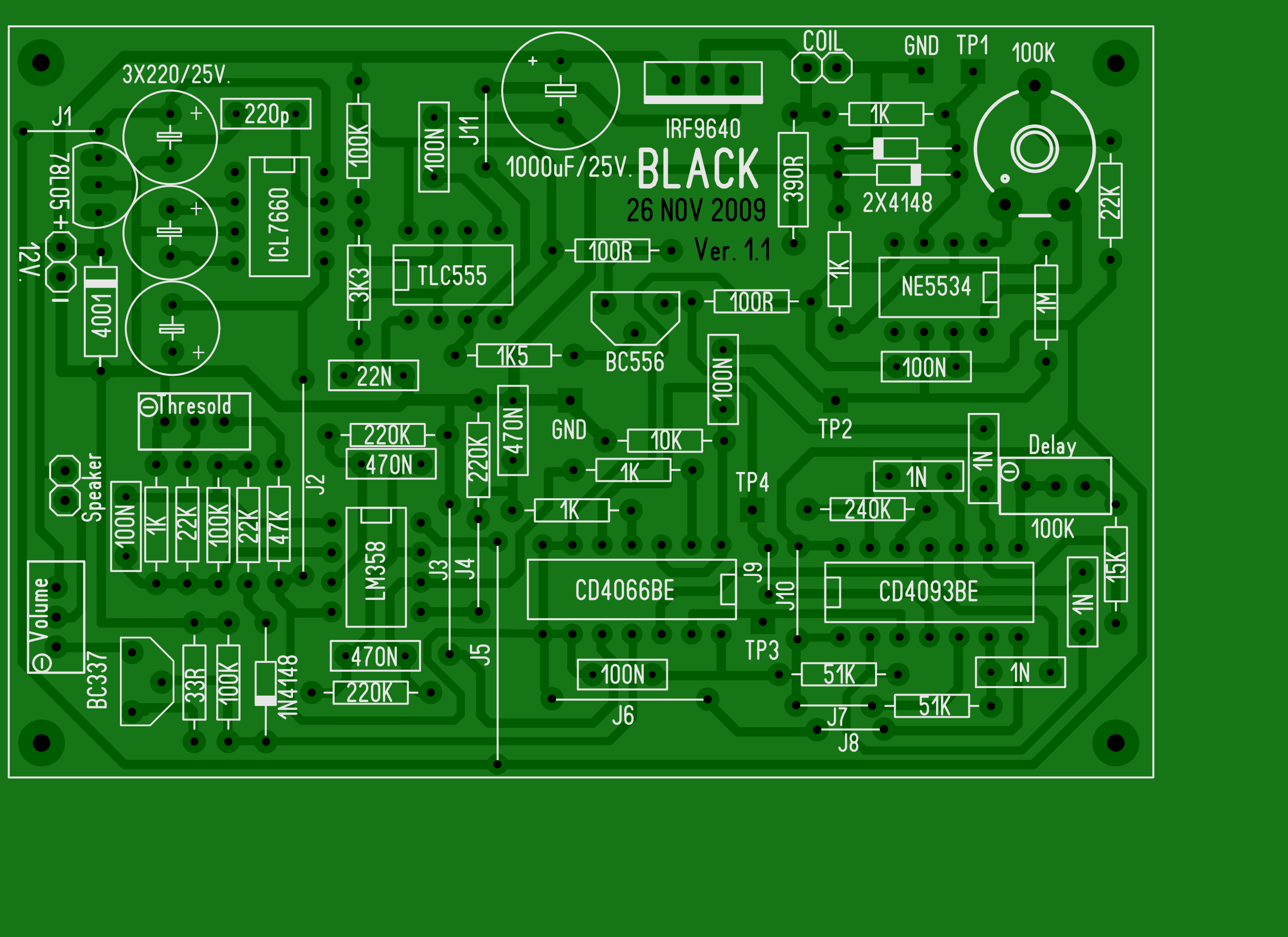

          • Any one have problem with surf pi when swing coil make sound??,also when i close to land make sound my surf pi is not stable at ground to much noise make!what can be a problem??
            • sorry for multiple posts guys i make this version of Surf pi.

                  I think when i go outside from home with surf pi it is not stable,every time when i swing with coil make sound at every end of swing
                  • pulse detector is sensitive to any metal like to ferrous. you have to find too clear place at first.
                    you have to shield the housing inside like you do that for coil too, the foil you have to connect to (-E) of battery.
                    • Originally posted by seadoggy View Post
                      If there is a beep at the end of every swing, then the Earth Field is not being eliminated correctly. You can confirm this by waving a whiteboard magnet (or similar) in front of the coil about 3 to 6 inches away. If it beeps during the test, then re-check your component values. This would be easier to debug if you have an oscilloscope.
                        Can i use any small magnet??,i dont have scope mate!!,i try many different coil but still problem is remain!my coil is 0.350 mh(about 23 turns wire 0.50),i have 2 board of surf pi same problem!cant search with surf pi cuz it is unstable at field
                          Any small magnet should be ok for the test.
                            I try with small magnet but when i remove magnet i lose all metal and coil dont detect any metal
                              I suggest you re-read post #1045, as you appear to have completely misunderstood the Earth Field Elimination test.
