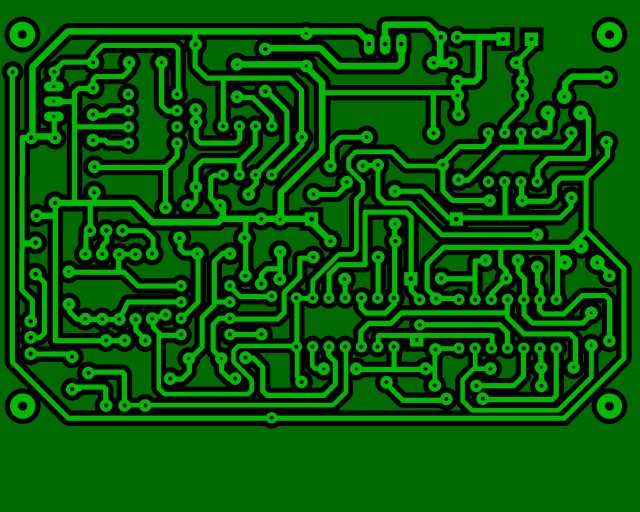

    mine keeps ringing, with or without coil and heats the Q6 (BC337) someone has any idea because it can be.

                • !!!! Transistor Q6 (BC337) has been !!! INSERTED WRONG !!! ON oxygeno07 layout.
                  Originally posted by geminis74 View Post
                  someone has been surf PI oxygeno07.
                  thanks.
                  !!!! !!!! Transistor Q6 (BC337) has been !!! INSERTED WRONG !!! ON oxygeno07 layout.
                  Please remove it then turn on 180 degrees and install back. Or better
                  use new one because it possible has been burned.

                      Transistor BC337 reversed

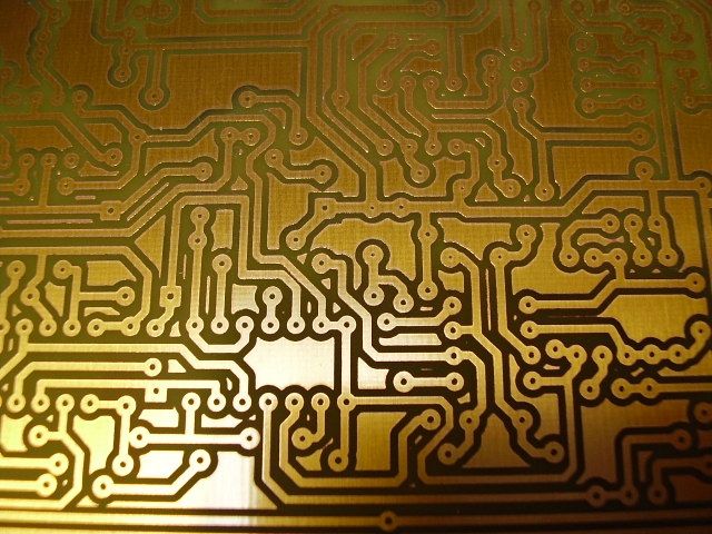

                      • I hope it work. here is new pcb
                        • Originally posted by cordius View Post
                          These links are not among the good unless they are connected to ground
                          • why not? the full zone are non connected, are isolated to the track
                            excuse my english.
                            • Originally posted by lari View Post
                              excuse my english.
                              Hi Cordius,
                              I think what lari is saying is that you have flooded the board with an isolated net instead of ground. Looking at your image it seems he is correct. When performing a copper pour it should be associated with ground (0V) and you should remove all the isolated islands. However, I would think that your board will be ok as a prototype.
                              • the copper area is isolated to the track 0,5 mm space.
