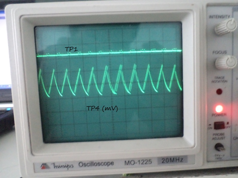

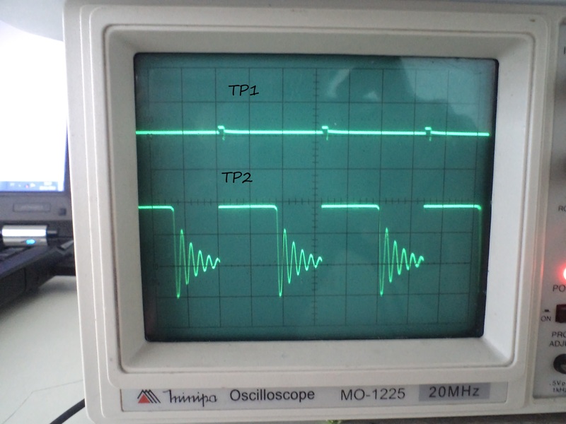

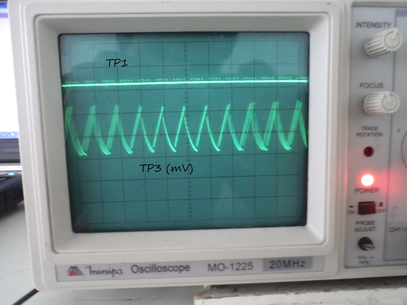

                    (still don't work...)
                    • Originally posted by Watanabe View Post
                      [ATTACH=CONFIG]22148[/ATTACH]
                      Have you, by some chance, forgotten about the damping resistor?
                      • R6 (380R)? No.
                        Acting in P1, can leave TP2 square. This is right?
                        I think the problem is in the negative voltage (V-).
                        V- is equal at -2.8 V.
                        The correct value would be -5V??
                        Thank you.
                        • You have some serious oscillation there. With correct 380ohm you could not have such huge oscillation.
                          • I can eliminate oscillation.
                            I can make TP2 be square.
                            Is this right??? TP2 = square???
                            but still don't work...
                              TP2 is at the output of the preamp, and the signal is seriously underdamped. If you have a 380R damping resistor fitted, then the problem is probably your coil. What is its inductance?
                              • It may appear as a square even if everything else works well. The exponential drop of the signal may certainly look as square. So what do you do to obtain a square?
