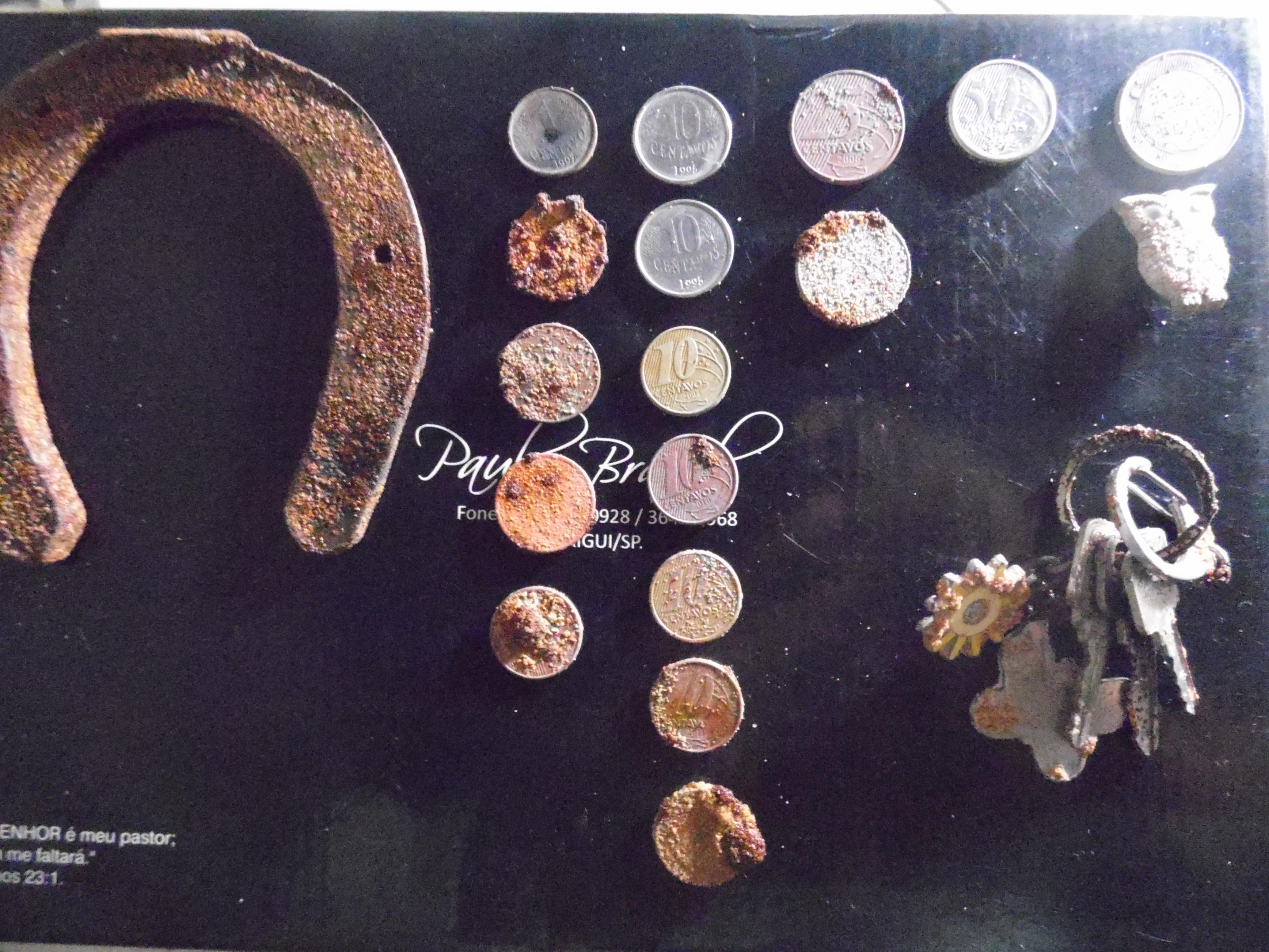

                        • I finally got my work pi surfing thanks to everyone for the tips Geotech site, did field testing and this is the result
                          • this were my findings
