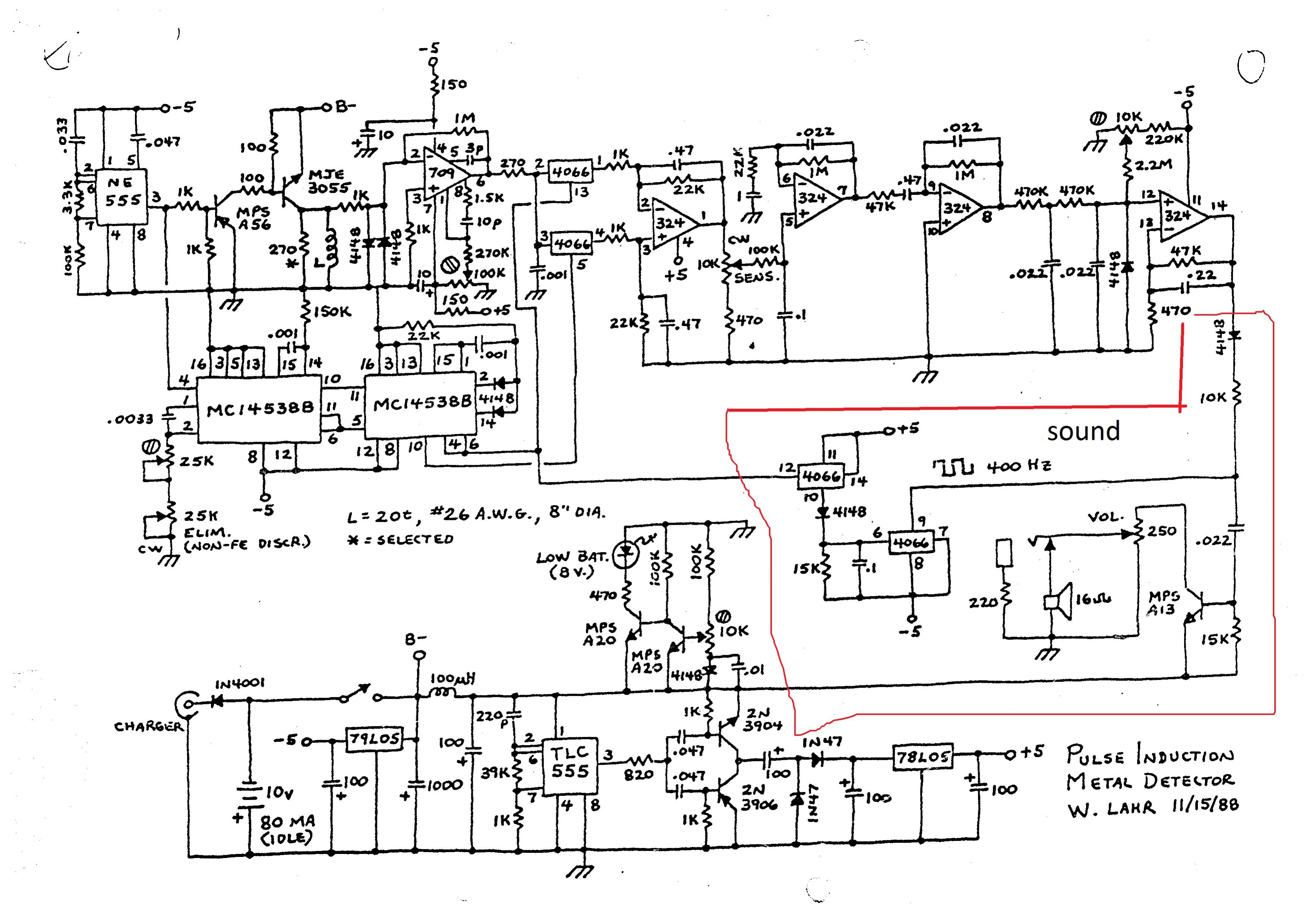

Whites Surf PI schematic

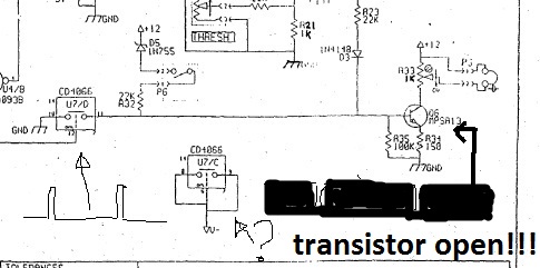

    You need to LOOK at the Whole schematic.
    U7D is switched at the SAME Rate as the 4093 (switched Once per Pulse/sample cycle).
    The LEVEL of the signal through D3 ALSO goes to the base of Q6.
    I've edited my post above:
    edit: the audio signal that come through D3, from sample1 is cutted by U7D switch, result frequency of audio and voltage variation of sample1 give the amplitude. right?
    now, as SCS said, why is like this and no opposite? Does it matter?

    • Why would be matter when that final signal only goes to head phones?
      • LOL The Final Stage of Demodulation always ends between the ears.

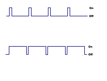

          • The problem is a long sound signal and a short pause. This increases the consumption when there is a signal.
