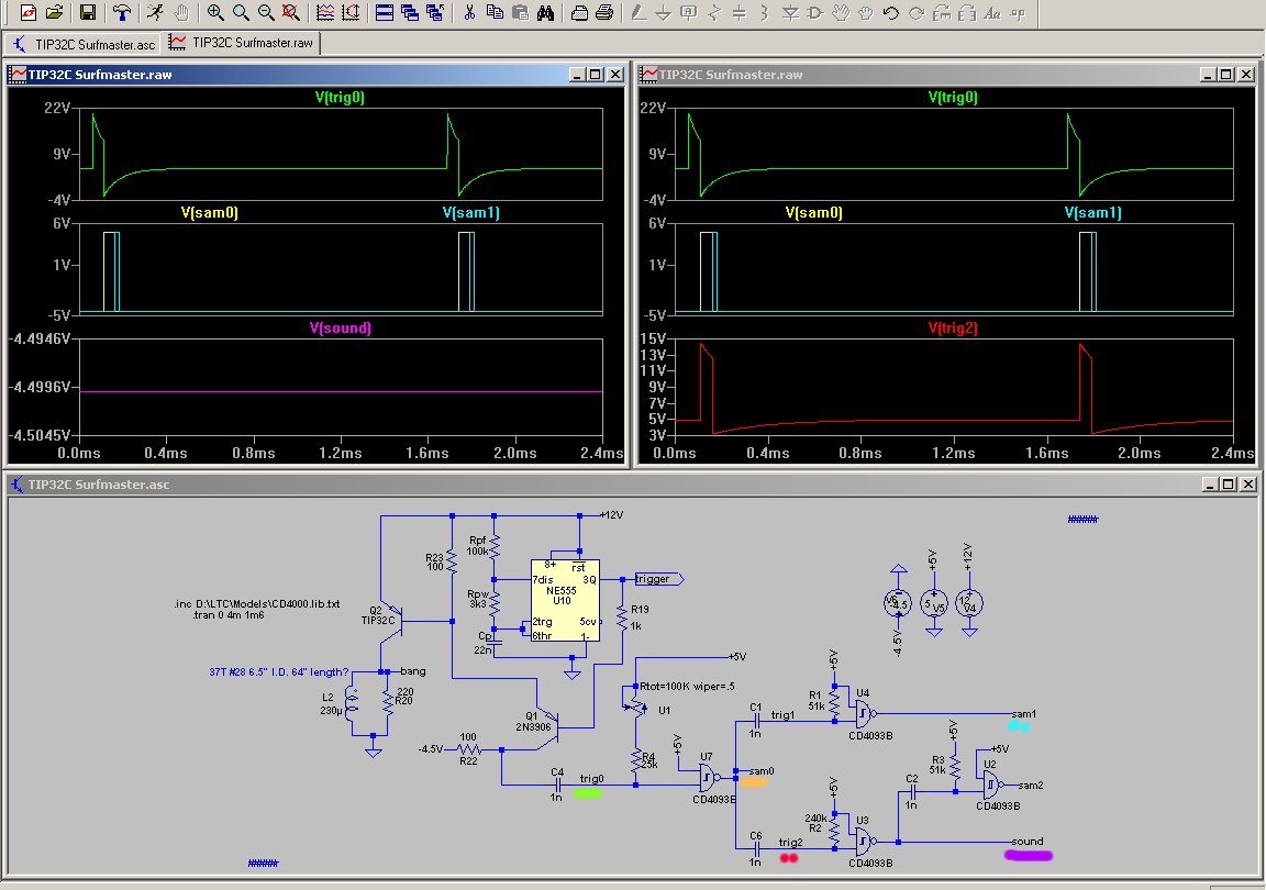

    I am a newbie with LTspice. Just tried a simple mosfet switch circuit for switching hard drives that we use at work and used the nmos and pmos models. Don't work at all. Use real parts and it does. So what are those generic models for?

            I have enabled the diodes you speak of.
            The problem still remains. With the DISC pots set at or around the mid position the first one-shot in the chain (U7) will trigger and also U4 triggers but I
            can't get the bottom leg, U3 and subsequent U2 to trigger.
            Even worse, if I replace the TIP32C with IRF9640, the top leg does not trigger, only U7.
            If anybody figure out why LTspice mistakenly shows this circuit to be dysfunctional I would love to know about it.
            I don't particularly like posting broken simulations and this one is broken. You can see that v(trig2) does not swing low enough to trigger
            the bottom leg of the sample timer circuit.
            If I left out something out of the zip necessary to reconstruct this simulation please let me know and I'll try to make it right.

            • So this is fun! Learning LTspice and detecting circuits simultaneously...

                • In regards to the simulation:
                  1. I had to modify the .inc statement to point to the correct location on disk.
                  2. add .inc statement to point to the bjt library file.
                  3. located, download potentiometer.sub file off yahoo group.
                  4. delete 555 and replace with one of msc library.
                  5. add diodes on 4093 inputs to 5V. This will make them work. Not much
                  to play with in the way of pulse width though with RC we are working with...
                  6. I tried to attach the revised .asc file, called it a .txt - rename to .asc.
                  Barry

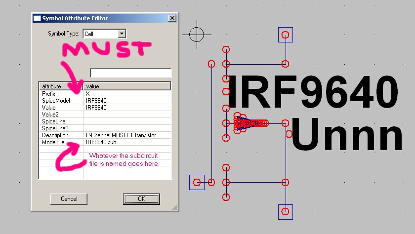

                    Sorry about the omission of the potentiometer model. I almost always forget something needed to make a zip package complete.
                    Tonight I uploaded the potentiometer model but I had to rename it. It should be un-renamed to potentiometer.sub.
                    Yesterday I uploaded my version of standard.bjt because the TIP32C model was not included in the factory download.
                    Bklein, you used an include statement which is OK but you could also replace your LTC supplied standard.bjt with mine, or copy/paste only the line that you need (starting with ".model TIP32C...). You wouldn't need to use an include statement with either scheme.
                    From time-to-time LTspice will ask you if you want to update. If you update, LTspice will take whatever additions that have been made to your "standard.*" files (in the CMP folder) and add those to the updated files. (standard.mos, standard.dio, etc.) That did not happen so smoothly once upon a time and it was a real pain - but they fixed that. This means that as you add models to the various "standard.*" files you will only need to do so once. You won't have to add them again and again after each update.
                    I also included my personal updated "standard.mos" but it is extraneous because there aren't any mosfet models in that file needed for the Surf-PI.
                    These two files (standard.*) should go in the CMP folder if you choose to use them.
                    I supplied an IRF9640 model/symbol that work together. That IRF9640 symbol started as an "X" symbol which can be used for diodes, opamps, BJT, etcetera. I think that the "X" symbol is supplied with LTspice and there is an explanation somewhere in the help file... but I don't know where it is at this time. The "X" symbol and various standard LTspice symbols are different animals, don't get them mixed up!
                    Whenever I use the "X" symbol, my accompanying model file starts with ".subcircuit" instead of starting with ".model" but I don't think that is rule, it's just the way most third-party models come. If it's a ".model" I copy it and drop it into the appropriate file in the CMP folder. If it's a ".subcircuit" I modify an "X" symbol and set its attributes to match the pin assignments.
                    Then, I put the accompanying "subcircuit" file in the SUB folder. That makes an include state unnecessary. This is just my preference; there are other possible scenarios.
                    Usually the pin assignments are stated, or otherwise obvious in a subcircuit file, but not always. Most manufacturers follow the same pinout assignment standards but some manufacturers don't.
                    You will want to find and download amplifier model files. You can make a generic X-amplifier symbol and point the model attribute to the appropriate model file but that only works if the symbol and model file pinouts agree. Instead:
                    I prefer to make two symbols for each amplifier that I have a model for; one symbol with '+' on top, and one with '-' on top. AD797+.asy and AD797.asy for instance, would be such a pair. That is not such a great chore because since most opamps have the same pin assignments, you just copy a similar .asy file, give it a new name, and then CTL+A to change the attributes. Then you swap the input pins and give it another name. Bam, you're done.
                    The CD4000.lib.txt file I supplied has some of my attempts at modification but that should be transparent and cause no problem. The original is on Yahoo's server and I hope we can get Helmut Senewald to tell us how to edit it properly. Easy to edit, but getting it right - that's a little harder.

                          • bklein,
                            You were on the right track by adding diodes on the inputs.
                            Installling the "starred out" input diodes makes the one-shots trigger in LTspice but I believe the resulting pulsewidths are less than 1/2 what they should be, according to the formula below. Starting with 51kΩ and 1nF I calculated the pulse width should be about 45us. The sample pulses were 16us in my simulation. (I used 5 +|-5|=Vdd)

                              • Well, the performance of my Surfmaster PI is not that great. Maybe a sucky coil? I get 87V on the pulse return not the >100V talked about.
                                open air detect measurements in a crowded full of metal garage:
                                quarter - 5.5" soft, 4" hard
                                dime - 4.5" soft, 5" hard
                                penny - 6" soft, 5" hard
                                gold ring - paralled to coil - 7.5" soft, 6" hard.
                                soft is where you can detect it vs background, hard is a definite detect but not the really hard bang of a very close detect.
                                I have taken several scope shots of various timings. I played with the damping resistor and could get a bit more detection range with a much higher resistor, like 820 ohms. But the resulting signals do not look "kosher" - large spike at beginning. I figure since the receive signal pulse is only 87V either the coil is the issue or the drive transistor should be replaced. I put back the 220 ohm damping resistor. I am not sure how to adjust R25. I can see where it works and where it doesn't but I don't get how I should best set it. ANYONE KNOW? If you are building these things you need to know!
