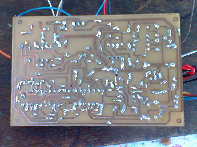

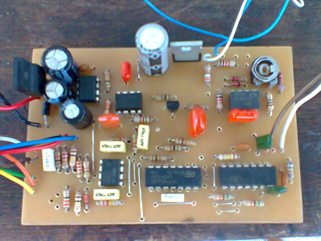

              • Rode another pcb more the problem is still not present in the audio speaker and this warming NE555
ID:	335051Click image for larger version
ID:	335052Click image for larger version

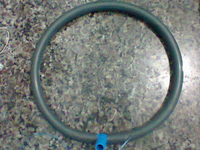

                  • al the photos of this coil and pcb a very low coil
