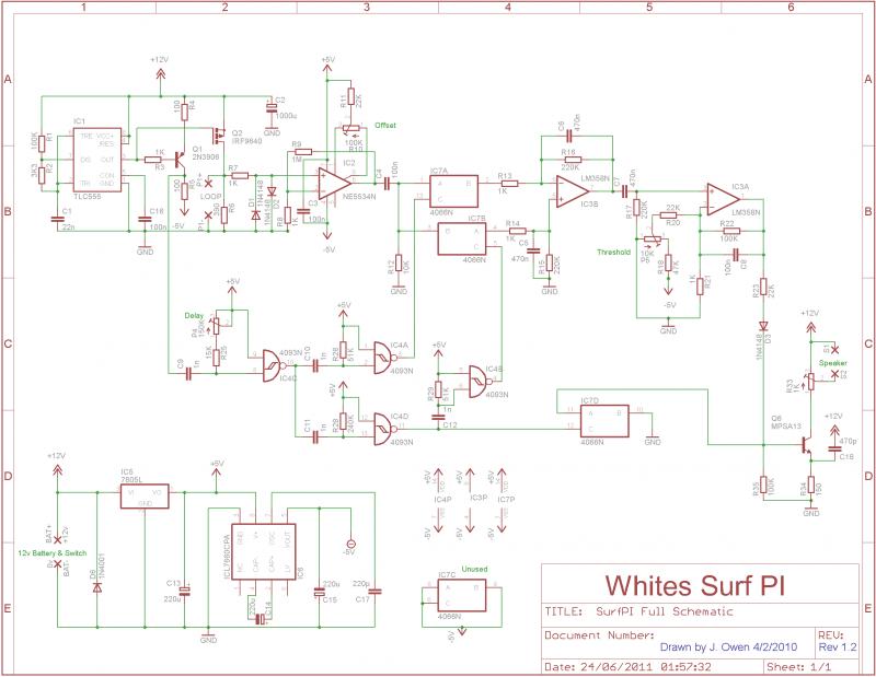

Whites Surf PI schematic
  • No MPSA13, how substitution?
    No MPSA14, how substitution?
    I only BC548 how Darlington?

          if you can not find Darlington around... use two N-P-N type transistors according the structure you see above. there is not problem to get a Darlington...connect them both what you see on the picture.

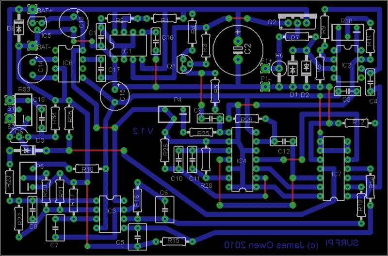

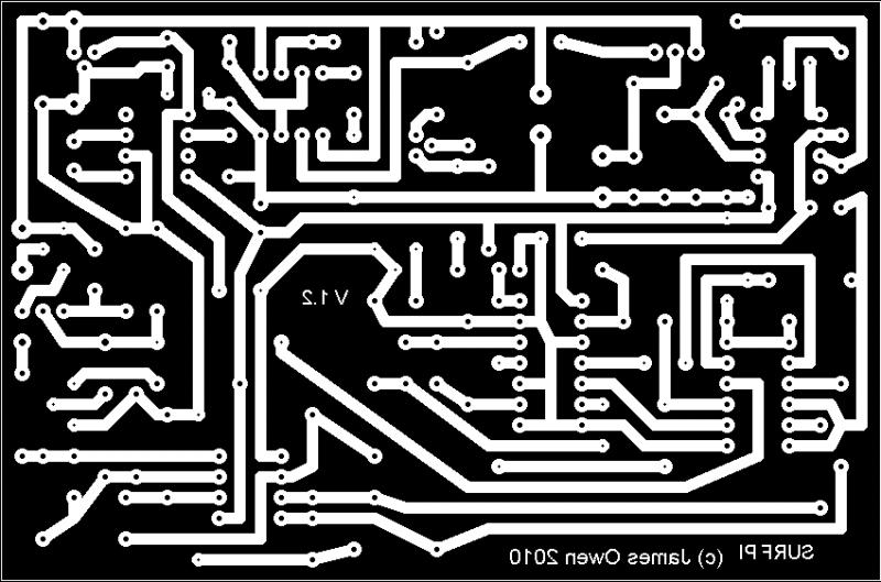

                      I have this single sided version from James Owen, I was going to get some boards made but other projects took over !
                      Q6 silkcreen is wrong, rotate the mpsa13 when inserting

                            I have not built the Oxygen board, there were some comments earlier in this thread that it contained errors, although i have not checked it myself, but your waveforms look good. Transmitter and gating pulses look OK. You should be able to see the change in the decay curve on the output of the NE5534 when placing a large target near the coil.

                                If anyone decides to use my SurfPI board and schematic that Silverdog has posted above then please be aware that it may contain errors. Also it must not be used for commercial gain without permission, it is copyrighted to me. I was hoping to tidy it up a bit before releasing it on the forum.
