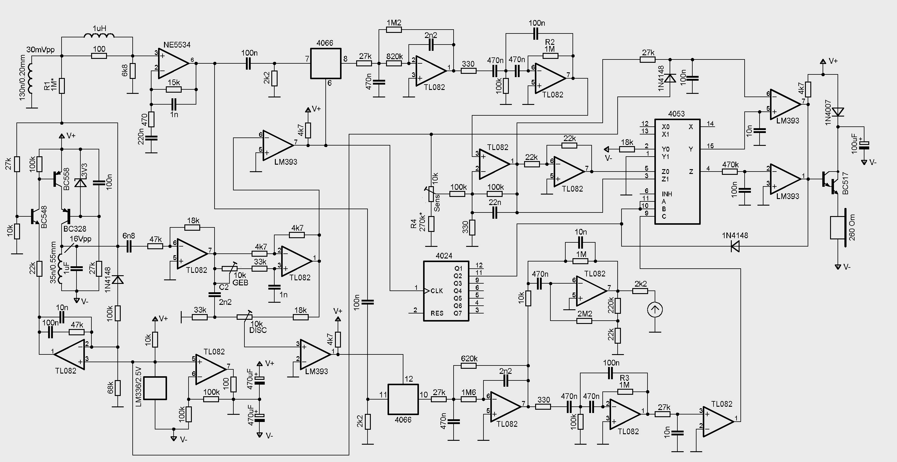

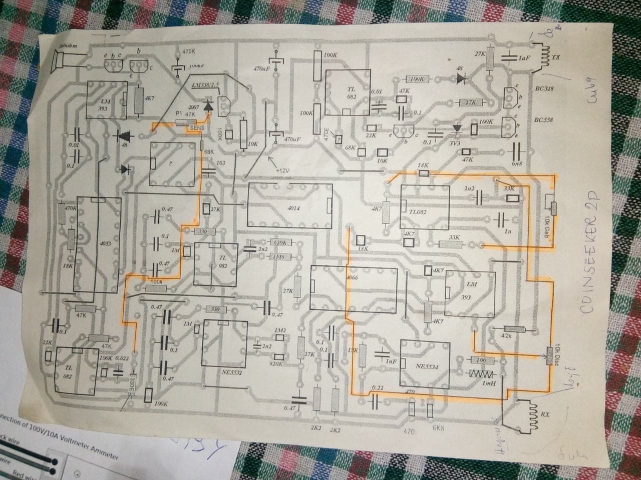

  • The last scheme you give PCBs
    • maybe this help but chage the values

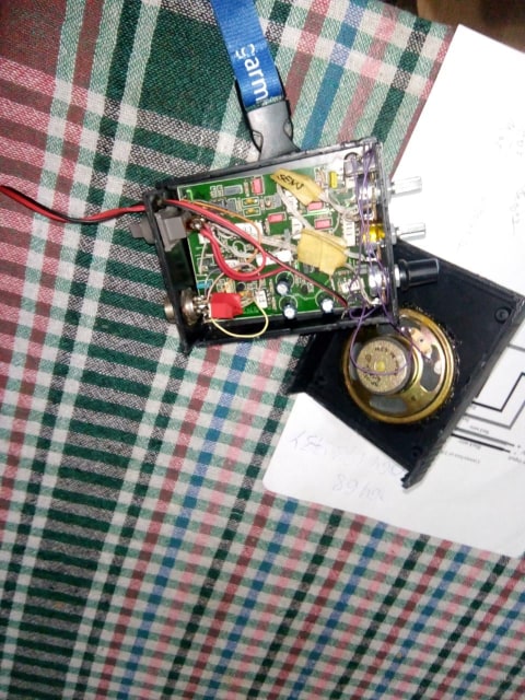

      • This thing works very good.PCB is old with an additional placed parts.

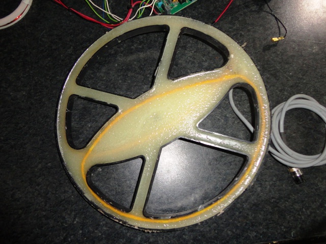

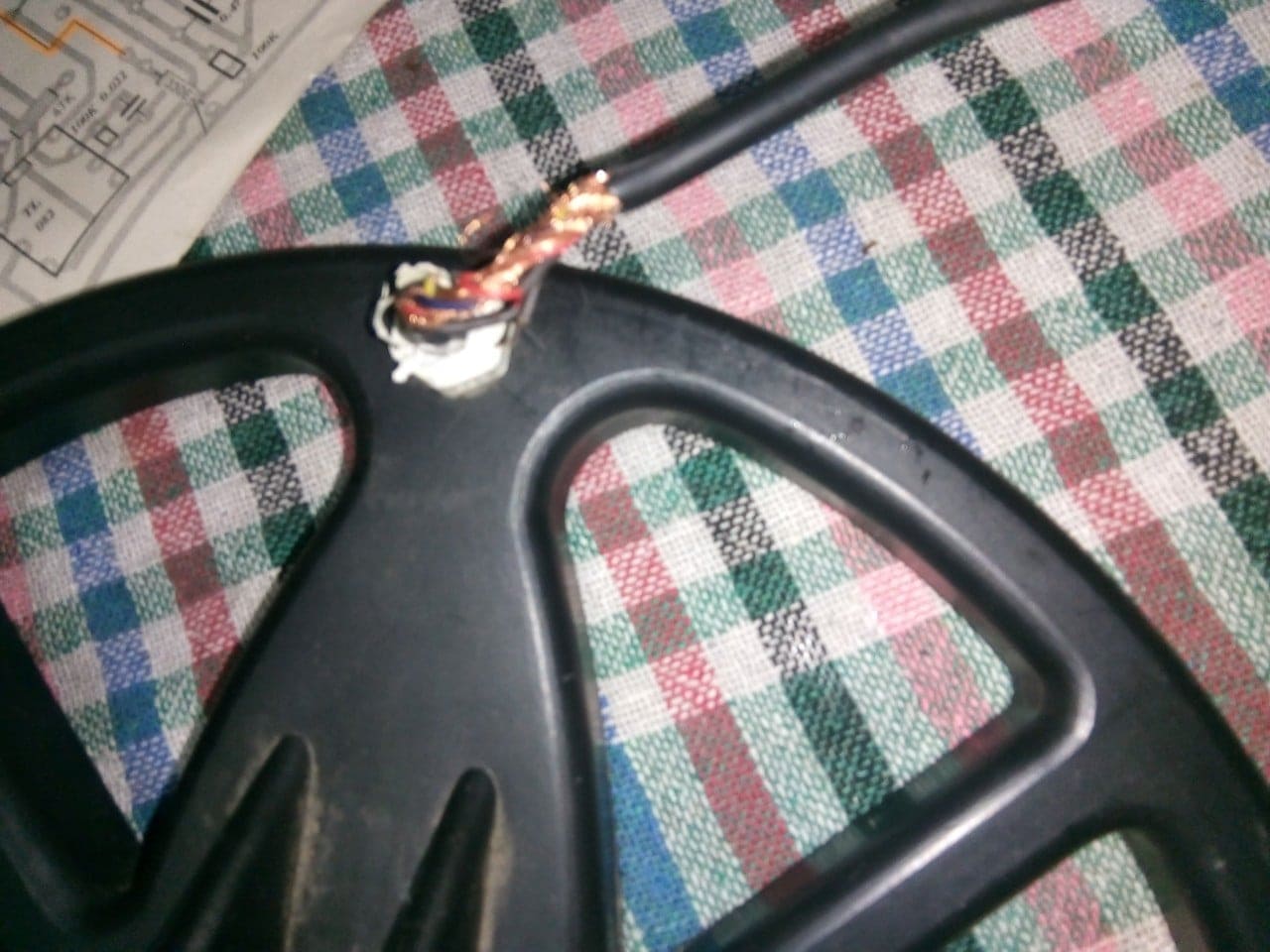

          Concrete i need the correct number laps winding wire RX and TX I have one which broke cable ...Click image for larger version
ID:	355026 Click image for larger version
            Very much about this device ! Lots of pages it seems confusing !
            Concrete i need the correct number laps winding wire RX and TX I have one which broke cable ...[ATTACH]47552[/ATTACH]
            [ATTACH]47553[/ATTACH] [ATTACH]47554[/ATTACH]
            RX 130 turns 0.2mm
            TX 30 turns 0.55mm
            Use the pattern shown in the coil photo, and make the shape of the D like in this photo. Use old coil dimensions from your broken coil, it will be good.
