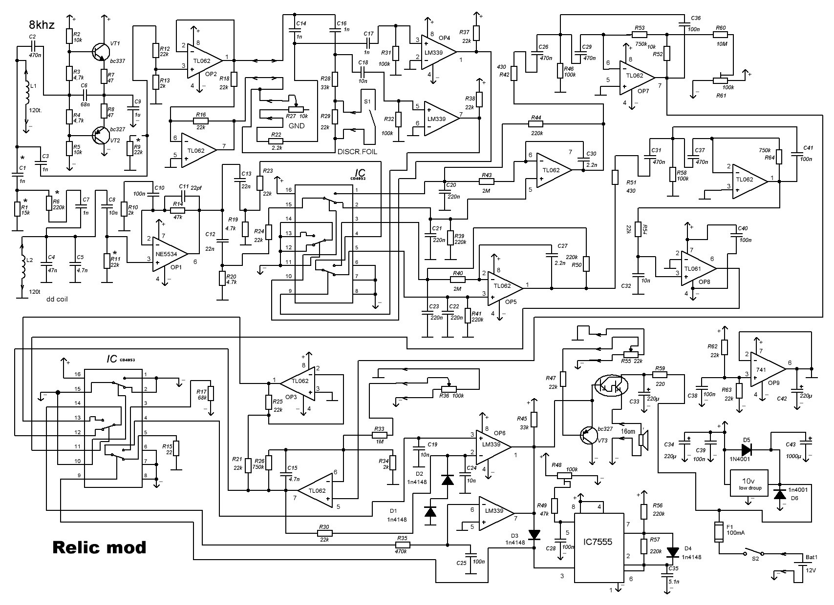

                            • For very stable work change c22 and c30 to 100 nanofarad.
                              • Good filter=perfect detector.Click image for larger version
