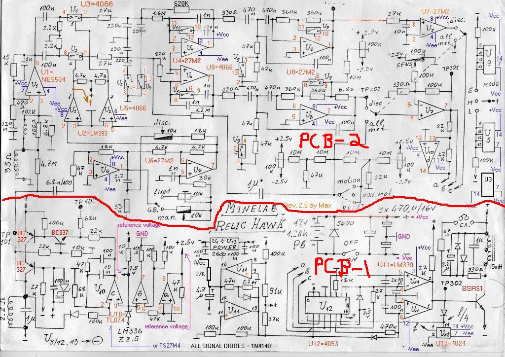

  • Hi,
    Ivconic.
    How are you?
    I also think that this are diodes.But have some doubts for left.It might be TR.
    According to Bulgarian schematic there are 3 TRs.And if this all are diodes,then on original PCB we have only 3 TRs.
    But I am curies about this track?Where should I conect it?Up or down?Do you remember?
    Also I still cant understand the wirings under this hugh 1m WIMA.And some ICs.Can you help there too?Other wirings are almost ready.
    With some help I will be ready very soon.I am working enough time on this PCB and now have some idea.

      Yes I did post this message , and yes I forgot !!! I will try in the next day or so to see whats up . But , the truth is , IT IS A VERY SLOPPY Looking "UNPROFESSIONAL SCHEMATIC", not done by anyone here on Geotech !!!. Maybe we can re-do the schematic again . AND I will call him back .......... Anyway before I Forget , IS there A GEOTECH MEMBER who lives in Rhode Island U.S.A. ???? There was a RELIC HAWK in EXCELLENT COND. WITH ALL COILS AND ACCESSORIES FOR only $375.00 u.s. Dollars WOW on Craigslist.org . IF a Geotech Member bought it , We would have this project done and over with , in 10 minutes !!!!!!!!!!!!..................Eugene52.

        I am shore that it wont be so easy.
        There are many under SMD ICS conections that cant be seen without desoldering them.But who will dare mess with such delicate design.
        The Bulgarian schematic is almost 100 % accurate.Trust me.Only minor mistake there.I am still trying to locate.
        The parts places and the conections between them are vital.
        But without Max it will be much harder to achive clone.

            I am almost ready!There is a diferance.
            The only one working PCB according Bulgarian schematic is Maxs one.
            And the only probleme were detection of iron from big distanse.Its a mistake somewhere obviusly but the device is working good.
            But enought talks.I will finish recheking first.But to tell you the true they had opened RH when they made this schematic.
            So the work is almost done here buy Max,Ivconic................................
            Only small corections needed.I also wanna make better PCB like the original.
            But freds is good enough for testing.

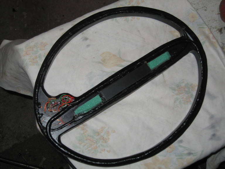

                  So I still dont have right datas to repeat original coil.Like number of turns and wire d.But Ivconic have mesaure the inductance accurate the post is in thread.And I am shore that he will find the right datas when we finish corect PCB dont worry.Here are many TOP INGENEERS too.
                  And if you read carefull there is no pre-am in search coil.
                  See you.
                  • I already posted right datas many times. How many times i should repeat same old post???
                    Coil doesnt have any electronics inside, not like at Sovereign.

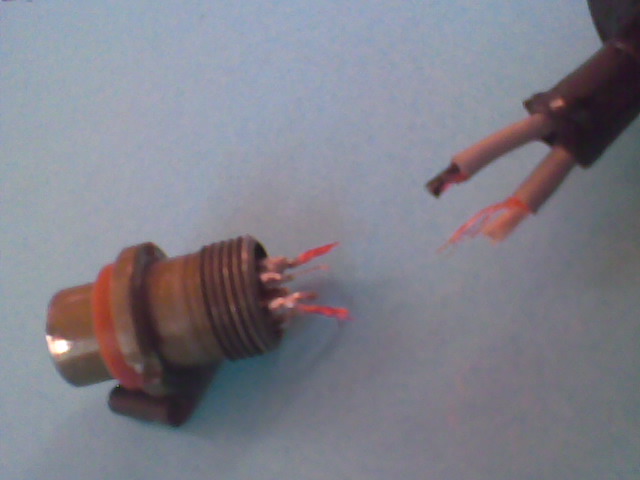

                        I just found this.
                        Its outher buxe that goes to coil.
                        Ivconic,
                        So:
                        TX=3.1 ohms
                        RX=41.3 ohms both with cable.?Right.

                              • Today I mesured coil of my Minelab Muskeeter Advantage Pro and find maybe something interesting for you. TX 1 mH resistance 2 ohm and RX 15 mH resistance 30,5 ohm. As you can see, very similar to Relic Hawk, but smaller- only 10 inch.Does anybody knows, can it be used instead original coil of Relic Hawk? I think it is much more easy to find Muskeeter coil or some owner of this detector. Ones, when you get coil which work for sure, it will be more easy to tune yours home made Relic Hawk. Wish you a luck.
