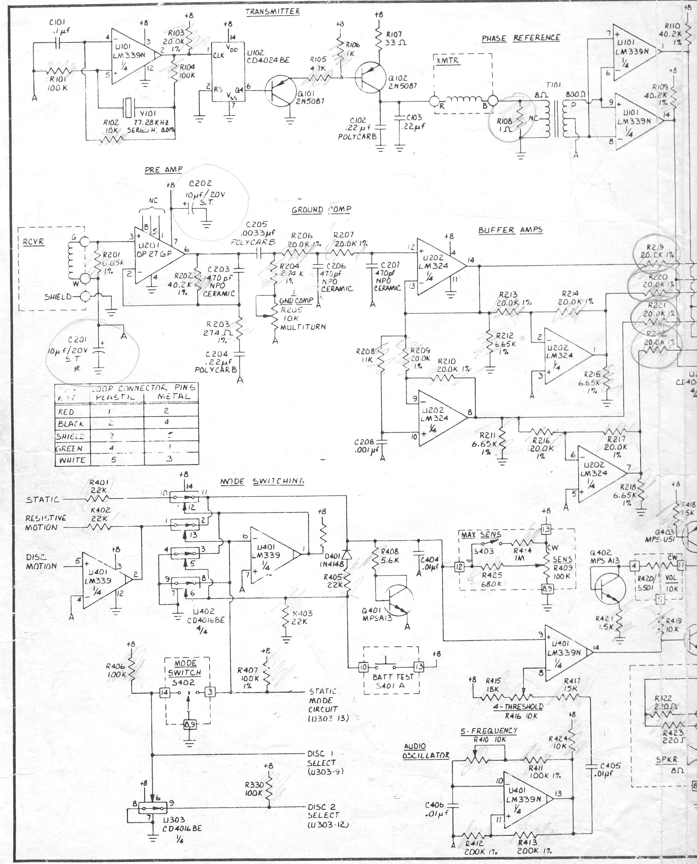

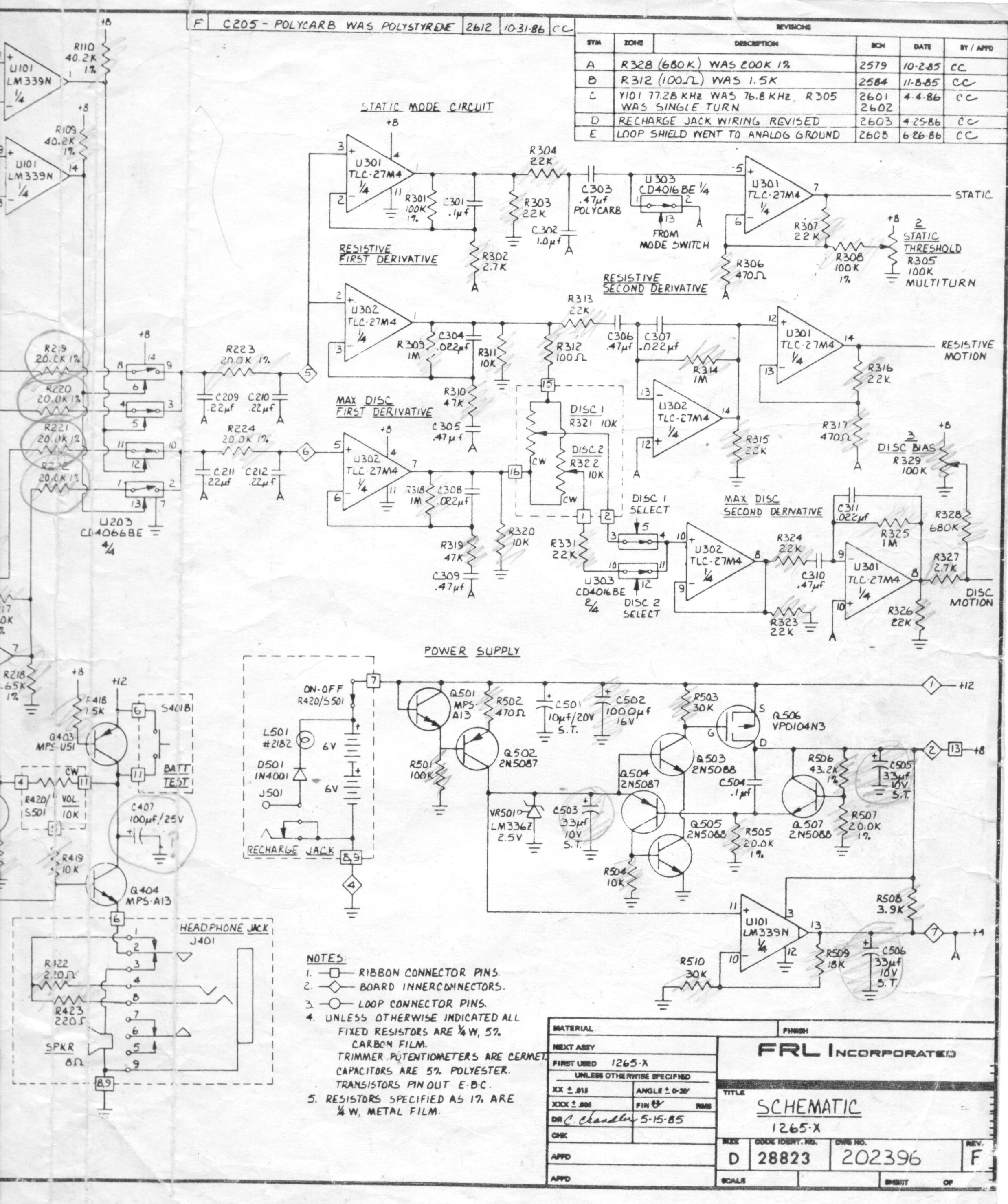

          Is this just a plain 1265?
          The official schematic (REV F) for the 1265-X shows 10k pots for DISC1, DISC2 and volume. No mention of logarithmic.
          • #50
            1265X, SN 22479
            I know, that is why I was surprised.
            J. L. King
            • #51
              The official schematic (REV F) ...
              Qiaozhi, Do you have a copy of this revision? If so could you please post or send me a copy? I have either REV A or D (label is fuzzy).
              J. L. King
              • #52
                J. L. King
                It was too big to scan as one sheet.
                Had to split into two parts.
                • #53
                  Thank you very much. It is much easier to read than the one I had. And the one that I had is rev A.
                  Thanks again,
                  J. L. King

                    • #55
                      thanks Qiaozhi for the hight quality schematic! you are superior!
                      all the best
                      • #56
                        Qiaozhi,
                        Thanks! At first look this is the correct schematic.

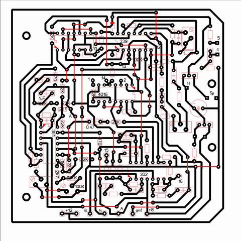

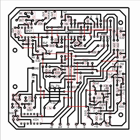

                                With a little delay, i would like to thank you Quiaozhi for posting finally correct schematic. Previously posted were inaccurate...almost by the rule!
                                Despite the fact 1265/66 was really nice machine, i never liked Fisher's way of arranging pcb's and components on those. Clearances also...
                                Yet aint no doubts those are high quality, i must agree on that. I always wanted to make homemade 1265. Once i did that according to Jackdetect's pcb traces. Had a lot of troubles with soldering some pins on both sides of pcb. So.. that handmade i just abandoned and scraped it...
                                But now, thanks to this pretty clear schematic i decide to do it again. Simple method; single layer pcb's with wire jumpers - extremly easy to make it.
                                Only one mod on pcb; i projected 2 junctions which can be used by the choice - dependably on crystal available. So man can put junction on one of two 4024 outputs. Crystal of 40kHz would be the best choice, although 32kHz can do the job just fine..
                                Consider this as my gift to you for Christmass...
                                Enjoy!
