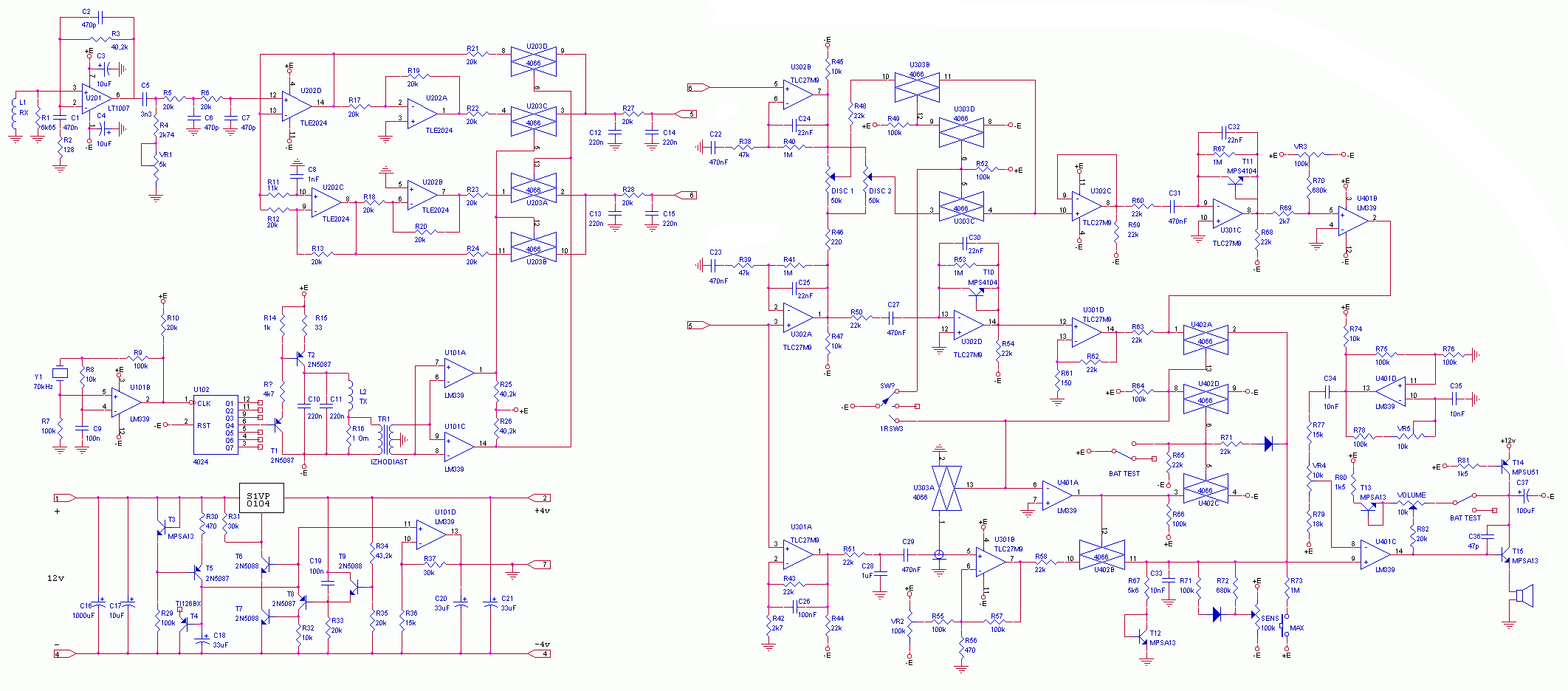

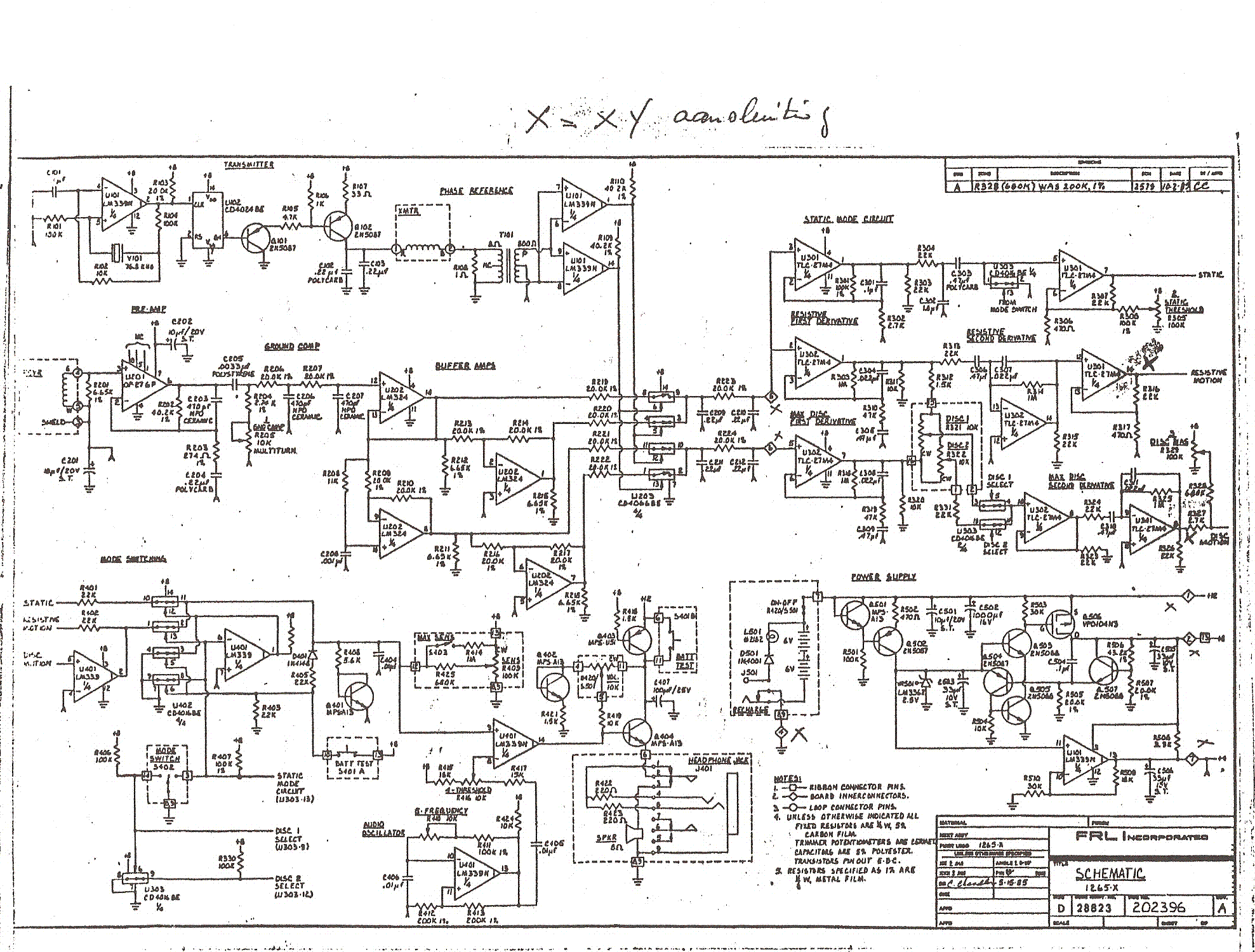

                        Hello KingJL , I see differences so they are not identical !!! Here are both schematics and I did some work with the1265x so it is clearer now than any copy I have ever seen , I hope !! .............Regards...........Eugene
                        • #42
                          Eugene52,
                          Thank you for posting the 1265 schematic. The 1266 schematic you posted has numerous errors (power supply, bat test area, and some of the analog switch signals. Also 1266 has 4016 and 2 4066's not 3 4066's). I have traced these out from the original 1266 schematic (extremely hard to read because of image quality) and comparing it to the 1266 PCB. From looking at the 1265 schematic, it looks as if there is very little difference between the 2 models. I will do some more in depth comparison of the 2. But for now, my question is answered; They are almost the same (near enough that I would be happy with either)!!!
                          Thanks again,
                          KingJL

                            Hello Again , I see the 1265x has a 10 turn ground balance , I did not see multi-turn on 1266x schematic. Glad you pointed everything out . I recommend everyone save a copy of the 1265x and trash the copy of 1266x !!!!.........Thank-You...............Eugene

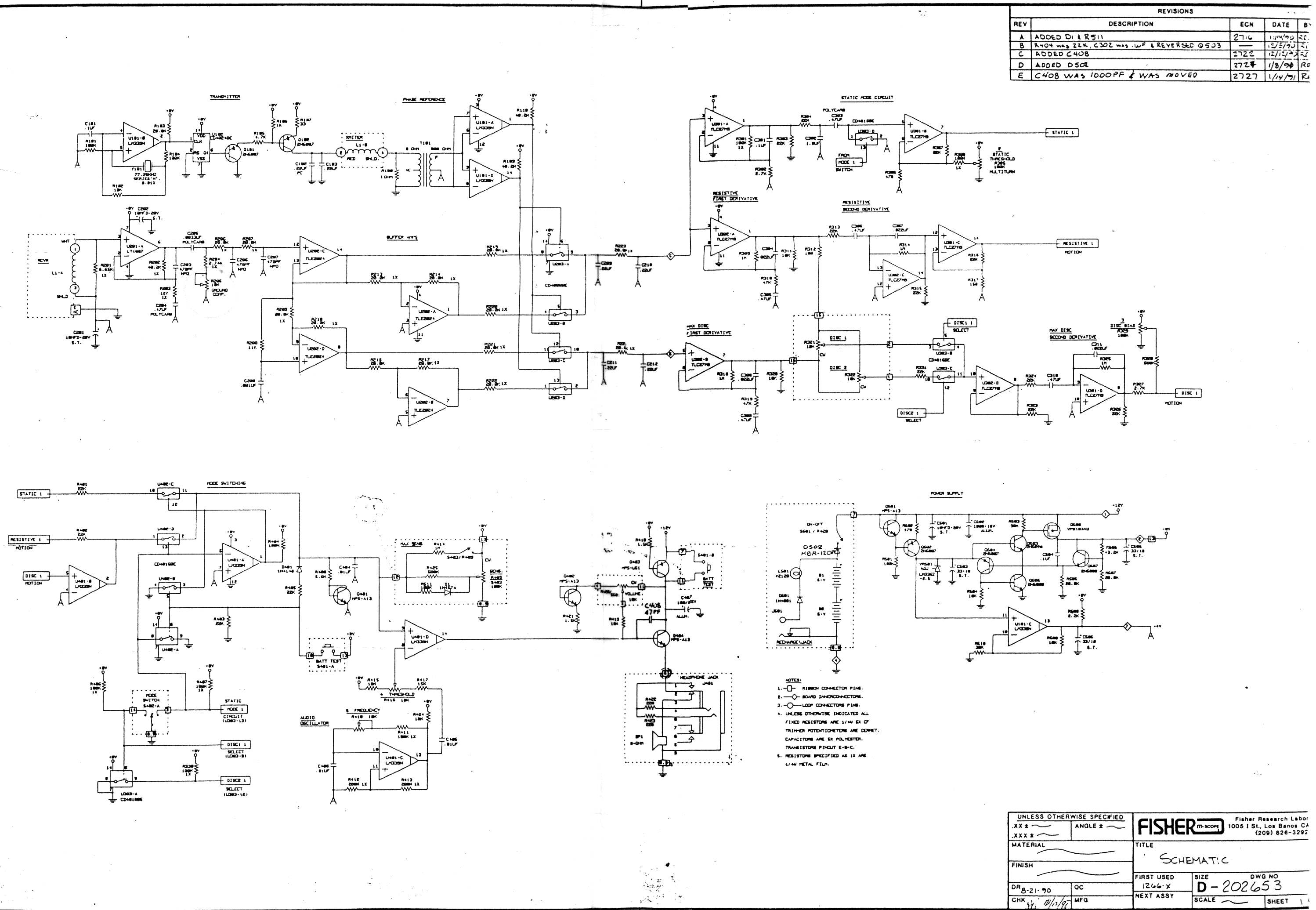

                              The 1266 in your post is totally unreliable (not your fault!). Besides the things that I noted in a previous post, it has inconsistancies in ground references vs what should be -4v. A correct schematic for the 1266 is attached to this post. It is an earlier version of the 1266 and does not have the MPS13A's in the feedback loop of the U301 and U302 amplifier sections (but that is easy to add). The schematic is extremely hard to read but is clear enough to compare to the 1265 schematic. I see a small difference in the sensitivity control circuit. Between the 2, all questions should be answered.
                              • #45
                                It appears as if the main difference between the 1265 & 1266 is added circuitry in the sensitivity control, addition of MPSA13 if feedback of U301C and U302D, upgrade of some components (TLC27M9 in place of 27M4, LT1007 in place of OP27? for preamp), twice the gain in the preamp, (~333x vs ~145x). I think the most significant difference is probably the LT1007 preamp with over twice the gain. That might be a worthwhile upgrade to a 1265 (You need to change the gain resistor and the series capacitor as well)!! If I made that mod, I might go ahead and add the sensitivity circuitry and the MPSA13 feedback mods as well.
