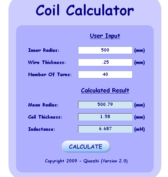

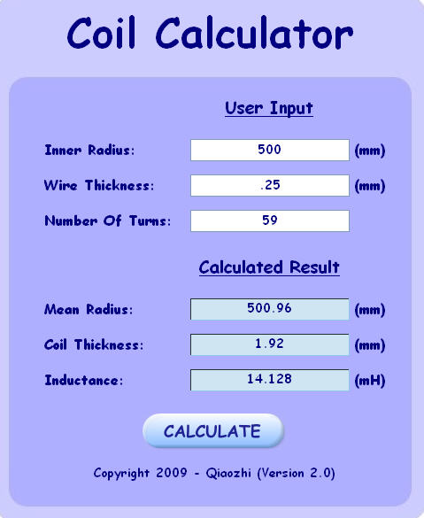

                        what is this? ((Tx coil = 2.5 nF Rx coil = 5 nF)) since the calculate software dont need those!!!?
                        please see the image, is it true for 20'' DD coil?!
                        RX=14.128mH
                        tx=6.87mH

                          A 20" diameter coil is 508mm in metric. This means the coil radius is 254mm not 500mm, as you have entered in the dialog box.

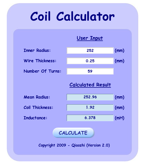

                            oh bad mistake
                            any way; again:
                            10'' coil:
                            Tx=60 turn of .25 mm wire = .176mH
                            RX=90 turn of .25mm wire = .375mH
                            and for 20'' coil:
                            Tx= 38 turn of .25mm wire= .176mH
                            Rx= 57 turn of .25mm wire= .379mH
                            TRUE?!!

                              Doh! .. I must have been tired last night. Sorry.
                              Tx= 2.5 mH
                              Rx= 5 mH
                                Tx= 2.5 mH
                                Rx= 5 mH
                                Hi Don
                                is this true?
