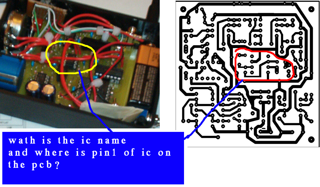

Mehdi,

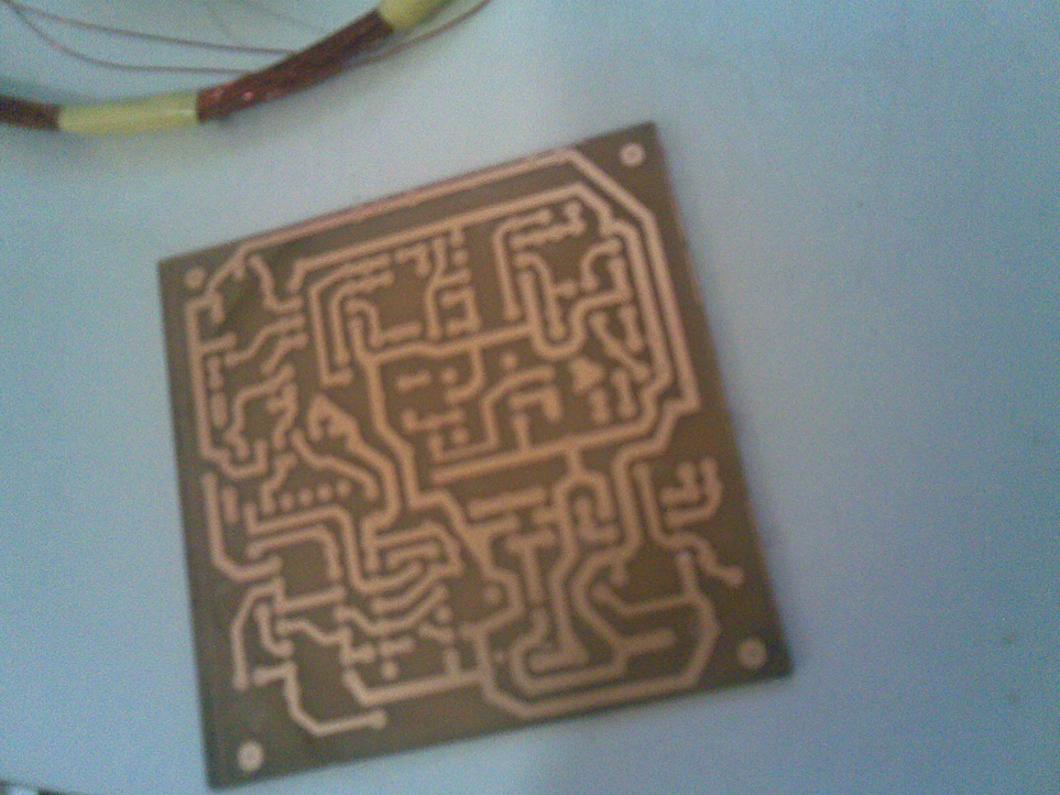

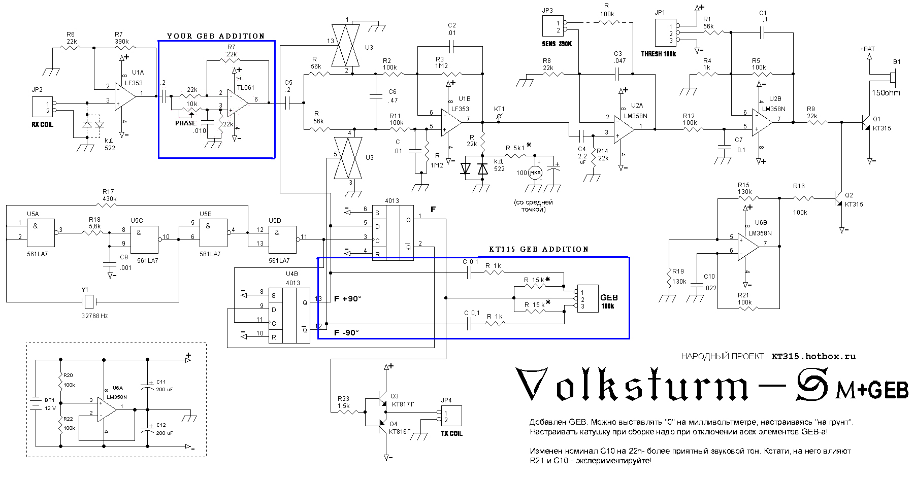

A little more information on what I built.
Attached is the parts list that I ordered. It may not be 100% accurate but pretty close.
Also, a good starting point for a coil. Use .25mm wire and the attached pattern. The Rx coil tunes using 85nF cap (about) installed between pin 1 and 2 on JP2 (not shown on schematic).
You don't really need to tune the Tx coil as it seems to work just fine with a squarewave.
Tx - 60 turns
Rx - 90 turns
Coils MUST be made in a very sturdy coil shell with epoxy and RX coil must be shielded
or the project will be a failure!!!
Expected results - 36 cm for 1e.. About the same as TGSL, but all metal mode only. Can be a very worthwhile project!! One nice thing.. Detectors running in all metal mode go deeper in the ground.. but you have to dig everything
Good luck!
Don
