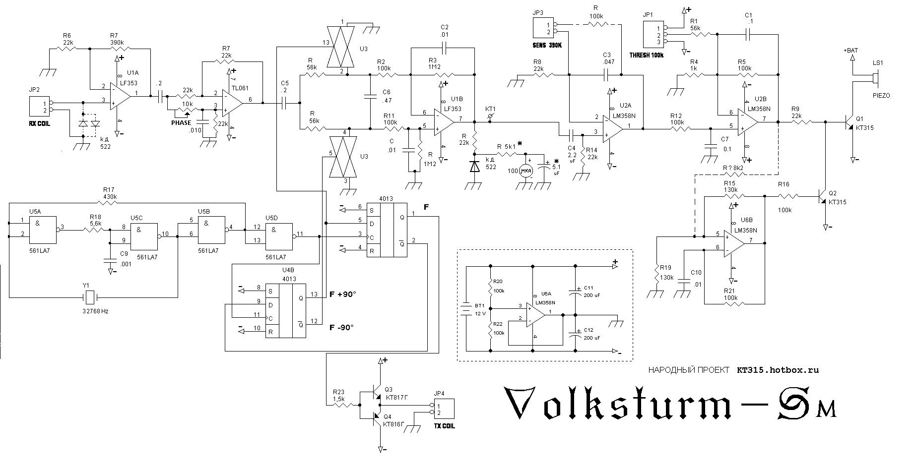

                        • i decide to build volksturm sm but i can not find the companent list and correct pcb lay out ! even at www.md4u.ru !?????
                          can anyone help me? please
                          • Originally posted by mehdi View Post

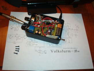

                            There are several different versions of the Volktrurm SM. One is posted in the Forum section of www.md4u.ru
                            Below is a modified version that I built. The TL061 is used to ground balance and the pot labeled "Phase" is a ten turn Bourns to allow find adjustment over a wide range.
                              See attachments for 2 different versions. I have not seen a complete parts list but I might have a list of parts that I ordered from Digikey a while back.
                              Don
